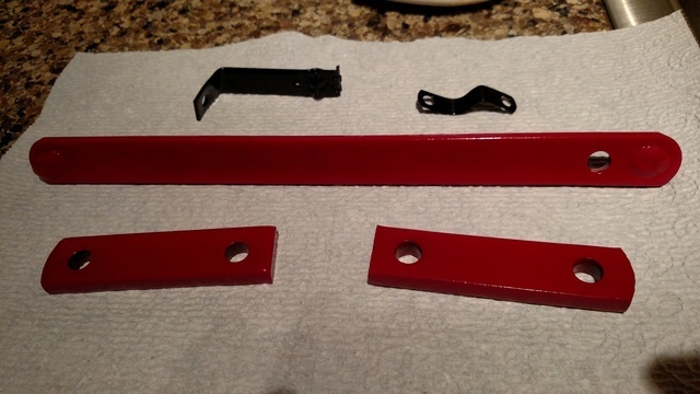

Mr. 856 170 #1 Posted January 13, 2016 Anyone else powder coating there parts? I don't think I will ever paint a small part again. Red Wagon from Eastwood looks darn close to me. Hope to move up to a bigger oven. I'd love to do the entire tractor in powder. There is nothing more frustrating then spending the time to strip parts, prime them, paint them, wait two weeks or more to have that part scratch or chip on install with minimal effort. It just never stands up. The paint even wore off the foot rest in about two weeks. No more. I can blast, prep, coat and bake a part and install it in an hour with no fear if that part chipping, scratching anytime in the near future. No brainer to me. Best decision I've made in awhile. Here is a picture of some engine parts in gloss black and some hitch/plow parts in red wagon. I purchased a nice HVLP gun through Eastwood to but haven't tried spraying real paint yet. I'm hooked on powder. 7 Share this post Link to post Share on other sites

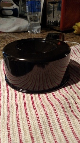

Mr. 856 170 #17 Posted January 18, 2016 k181S air filter cover. Two coats high gloss black. Rest of engine is black and for some odd reason I thought the cover would look good in almond......well It didn't tickle my fancy. Ditched the almond paint for the black powder. Came out sweet. 4 Share this post Link to post Share on other sites
