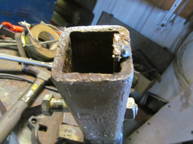

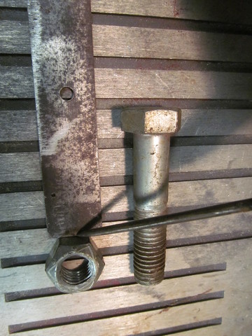

Ed Kennell 46,244 #1 Posted December 31, 2015 I got tired of the annoying start/stop bump I got from the movement in the receiver/slug when towing. I know these locks are available $30, but being a frugal DIY retiree, I made mine from a 5/8 hex bolt and two 5/8 nuts. Make sure the bolt has enough thread to complete the assembly. First, I welded a 5/8 nut to a flat bar. Then using the bar as a handle, insert the nut inside the slug. Then insert the bolt screwing it thru the nut and out thru the slugwall. Make sure you are using the correct hole in the slug. Lock the nut to the inside wall with another nut outside the slug. Then weld the bar to the slug and cut off the excess bar. Please do a better weld than this. Now, assemble the slug in the receiver, screw the 5/8 bolt thru the nut and out thru the receiver wall. Lock the slug and receiver together with a lock washer and 5/8 nut. No more movement when towing. 4 Share this post Link to post Share on other sites

Ed Kennell 46,244 #4 Posted January 4, 2016 Maybe I should have clarified the need to lock the hitch solidly to the receiver is only necessary on my small trailers without a load leveling hitch, and we are not talking about locking the hydraulic actuator on a trailers hydraulic braking system. On my large trailers with the load leveling arms this is not necessary as the loading of the arms puts so much upward force at the rear of the receiver and downward force at the front of the receiver that the slug and receiver are locked together rigidly so there is no play or movement between the two. The philosophy of having play designed into a train coupling so the engines are only starting to move one car at a time is understandable on a train that may have hundreds of loaded cars. I don't think this idea applies nor is it a good idea to have any slop between a towing vehicle and a single trailer. This only puts undue wear on the hitch components and the towing vehichle in addition to being a annoyance as the slop is taken up when starting, stopping, and changing speeds. Share this post Link to post Share on other sites
cleat 8,988 #5 Posted January 4, 2016 When we had the old Windstar and I hooked up the trailer it made lots of noise with the receiver banging up and down. It however had the smaller solid square receiver so I simply learned to live with it. I have seen some people drive in wooden wedges. The 2" receiver on my F-150 is back far enough that I don't hear it. A nylock nut may be good to use as well, you do not want that bolt coming out. 1 Share this post Link to post Share on other sites
