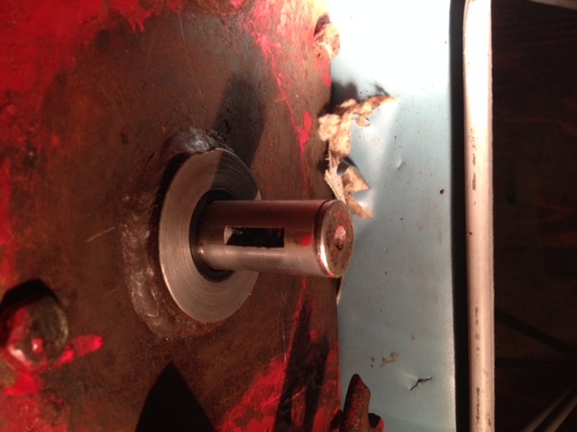

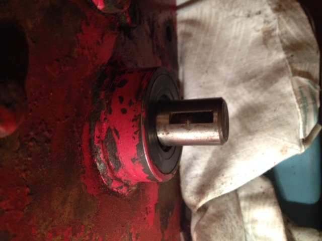

peigt14 19 #16 Posted December 18, 2015 got everything tore apart last night, looks like the axel bushing and seals are fine, no movement at all, with the exception of about 1/8" in and out, the leak is coming from the brake shaft and input shaft, there doesn't seem to be oil seals in place there at all, I drained old fluid, added some diesel, spun input shaft with a impact wrench, drained, repeated same process, things seem to be working well, I might flush a few more times, even the second time things were cleaner but still quite brown. I think I am going to try to replace top seals, fill with new fluid and see what happens. Should these seals be visible, when I removed the pulleys I seem to be seeing the end of the bearings, from the sketch in the owners manual parts list they look like they should slip on similar to the axel seals. thanks for all the great info, I am sure I will be back to bug you all again before this project is complete. 1 Share this post Link to post Share on other sites
wallfish 18,882 #17 Posted December 18, 2015 yes, the seals are on the outside, or at least they should be and they can be replaced without taking the trans apart. 1 Share this post Link to post Share on other sites
stevasaurus 23,539 #18 Posted December 18, 2015 And the brake shaft and input seals can be had from NAPA, Motion Industries...etc. Timken 471643 if you have the S8K ball bearings...it is the same for both input and brake shaft. IF...you have the needle bearing for the brake shaft, you will need the SKF 7410 seal. Just so you know. 1 Share this post Link to post Share on other sites
peigt14 19 #19 Posted December 18, 2015 how do I tell if which bearing the brake has? Share this post Link to post Share on other sites

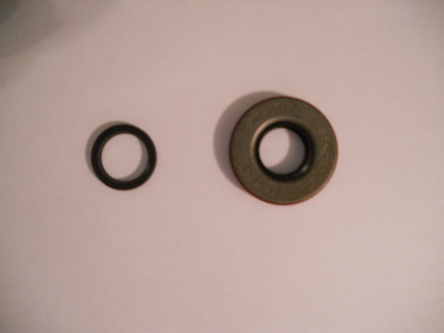

Racinbob 12,536 #20 Posted December 18, 2015 The ball bearing seal is 1 5/8" OD and the roller bearing seal is 1" OD. Pull the drum and you'll see it. 3 Share this post Link to post Share on other sites

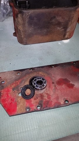

WHX?? 54,002 #21 Posted December 18, 2015 Thats somewhat bizarre that the seal would be missing. if you have the ball bearing you should be able to see the balls in the bearing if the seal is not ther, seal & ball bearing should look like this 3 Share this post Link to post Share on other sites
stevasaurus 23,539 #22 Posted December 18, 2015 If you look at your input shaft seal, and it looks like it will fit on the brake shaft, then you need 2...if not you need the SKF 7410 because you have the needle bearing. Being a Suburban...it is very possible you may have the needle bearing, but it is not 100%. Let us know. 1 Share this post Link to post Share on other sites

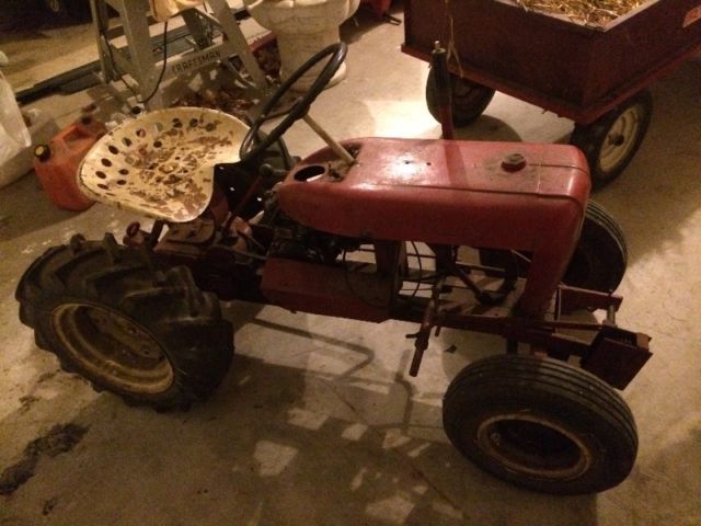

peigt14 19 #23 Posted December 19, 2015 here is what is there now and a pic of the suburban before I took it apart, don't see any ball bearings, I am correct it assuming seals are missing? I have never seen these before but based of what the axel seals look like and the sketch in the owners manual looks like they install the same way over the outside lip. 1 Share this post Link to post Share on other sites
Jake Kuhn 1,598 #24 Posted December 19, 2015 Seals are there, 1 side uses the needle bearing and the other a ball bearing, most commonly used on the suburbans. The seals bob posted are what you will need. 3 Share this post Link to post Share on other sites
