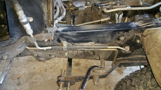

shallowwatersailor 3,222 #26 Posted December 16, 2015 I never realized that NH had it as an option on the GT22. The 523Dxi, 522xi, and 529Lxi steering is actually a hydraulic-style steering as opposed to power steering. There isn't a direct connection from the wheel to the tires. The steering wheel is activating a valve. An easy way to check if it has the option is to see if the wheel spins with the engine off. I have found that TractorData is not very accurate sometimes. For instance, the weight shown is low by about 200 lbs. 2 Share this post Link to post Share on other sites
WHX?? 57,938 #27 Posted December 16, 2015 Or look up underneath her skirt and see if the hardware is correct (pun intended knowing yall's gutter minds) but like Glenn's pic shows everything it kind of buried in there (pun not intended). Did go by the bone yard today Brian but the Goober wasn't around.... I'm still thinking it would be a project to convert but if the parts $$ is right? Let us know what it looked like with all the grease off. It does seem bizarre that it (PS) would have been offered as an option instead of standard on NH's. 1 Share this post Link to post Share on other sites
WNYPCRepair 1,924 #28 Posted December 16, 2015 (edited) It is definitely manual. The steering shaft connects directly to a plate, when that plate turns, it pushes or pulls on the tie rods, which moves the wheels. Steering wheel does not spin like my 522xi does with the engine off. And there is no power steering cylinder. If the $$ is right for the parts, it is definitely worth it. It's a bear to steer with the blower on. 1 hour ago, shallowwatersailor said: I never realized that NH had it as an option on the GT22. The 523Dxi, 522xi, and 529Lxi steering is actually a hydraulic-style steering as opposed to power steering. There isn't a direct connection from the wheel to the tires. The steering wheel is activating a valve. An easy way to check if it has the option is to see if the wheel spins with the engine off. I have found that TractorData is not very accurate sometimes. For instance, the weight shown is low by about 200 lbs. Funny you mentioned the weight. One of the seller's friends thought he was going to lift the front end and move it over on the trailer to make room for the deck. I said, this will be interesting..... Edited December 16, 2015 by WNYPCRepair Share this post Link to post Share on other sites

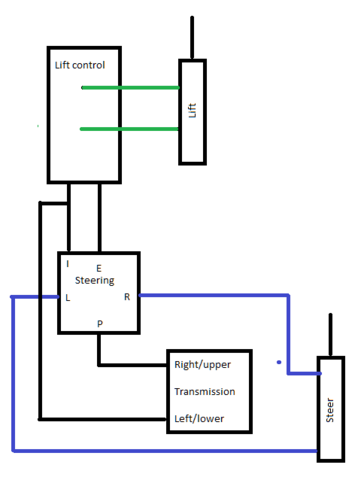

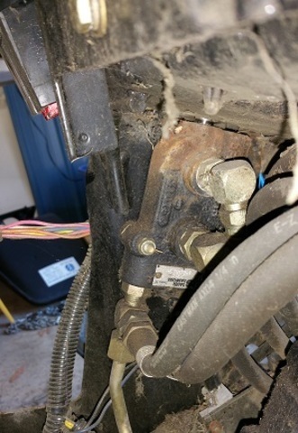

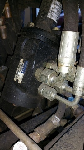

NinerHB 12 #48 Posted March 21, 2016 I've got almost the exact same setup, except mine is a power steering unit. I can get pics of the hydraulic routing with PS today if you want - my tractor is currently without sheet metal while I repaint it - my PO also left it outside for quite a while, and the bodywork was rusted, but not yet really rotting. I have horses to mow the lawn, so mine is mostly for keeping my driveway clear. I've got you beat though - I got my setup for $800 on Craigslist. I had owned the same tractor (mower deck only) that I bought used 10 years ago for $3k, so I couldn't pass that deal up. 1 Share this post Link to post Share on other sites
WNYPCRepair 1,924 #49 Posted March 21, 2016 2 hours ago, NinerHB said: I can get pics of the hydraulic routing with PS today if you want That would be great. I have a 522xi, but it would be nice to know if the NH is the same. Share this post Link to post Share on other sites
NinerHB 12 #50 Posted March 22, 2016 Pics in the front were kind of hard to get, so I traced the routing and drew a little diagram. Pardon my MS Paint artistry. The interesting part is that the steering gear appears to actually work even without hydraulic pressure - I can twist the steering wheel and the wheels turn, and I don't see any backup physical linkage. I assumed it was more like a car, where the hydraulic or electric setup is just an assist. 1 Share this post Link to post Share on other sites
