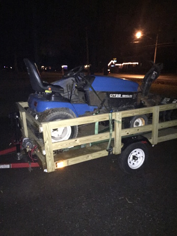

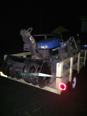

WNYPCRepair 1,924 #1 Posted December 12, 2015 It's the wrong color, but it is kind of a wheel horse. 6 Share this post Link to post Share on other sites

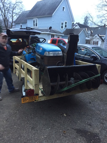

Sparky-(Admin) 26,270 #2 Posted December 12, 2015 Nothing wrong with other colors if you ask me (you would be surprised how many guys here have a different brand in their collection). A 2 stage blower....Nice! Mike......... 3 Share this post Link to post Share on other sites

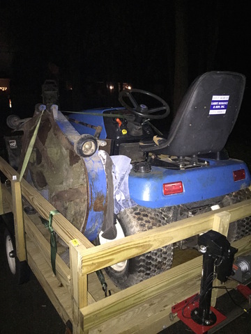

WNYPCRepair 1,924 #3 Posted December 13, 2015 (edited) Yeah, the blower was the main reason I bought it. Decided it wouldn't be horrible to have a spare to my 522XI. I think I stole it, though it was in a bit rougher shape than the pictures showed. he left it outside and it is starting to rust. Maybe I'll paint it red. $1700 for the GT22, blower, weights and chains. Barely got all that in the trailer. My electric tilt and winch worked great though, pulled the tractor right up in there, then lowered the trailer. Takes 60 seconds, but it's way less scary. Edited December 13, 2015 by WNYPCRepair 4 Share this post Link to post Share on other sites

WNYPCRepair 1,924 #7 Posted December 13, 2015 I think it will be over 9' long with the blower attached. It is hanging off the back of the trailer about 8", and it is pushed back until it is hitting the bumper. The trailer is 8' 3 1/2" long 1 Share this post Link to post Share on other sites

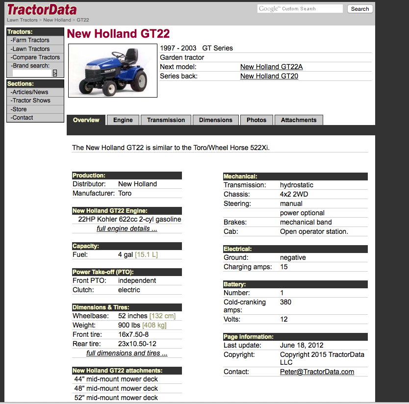

Wishin4a416 2,610 #8 Posted December 13, 2015 Its the same machine as the XI series correct. I know the blue decks go right on a red machine. Nice score!!! 2 Share this post Link to post Share on other sites
WHX?? 57,938 #9 Posted December 13, 2015 Nice....no snow = you sell me the blower! 15 minutes ago, Wishin4a416 said: Its the same machine as the XI series correct. I know the blue decks go right on a red machine. Nice score!!! Can someone enlighten me on how this is the same as an xi??? Share this post Link to post Share on other sites
JERSEYHAWG / Glenn 4,589 #10 Posted December 13, 2015 Brian, score score score, you dog you. The BEST PART is the 2 stage also. Nothing wrong with diversification in the world of tractors. We have a member or 2 here with an xi and the new holland 2 stage. Best of luck man. You done did good. Glenn 46 minutes ago, WHX6 said: Nice....no snow = you sell me the blower! Can someone enlighten me on how this is the same as an xi??? Jim, I will be corrected if wrong, but as I recall toro was under contract to do the build of those units for new holland. Paint color and minor things were the only change. Those NH decks and snowblowers attach right up to the xi. Glenn 3 Share this post Link to post Share on other sites
Wishin4a416 2,610 #11 Posted December 13, 2015 I have a friend who needed a new deck for his XI and I referred him to a guy I know with some NH NOS decks. The blue one went right under his 520XI. The guy said they are one in the same machine "in that time frame" except for some suttle differences. 2 Share this post Link to post Share on other sites
WNYPCRepair 1,924 #12 Posted December 13, 2015 1 hour ago, Wishin4a416 said: I have a friend who needed a new deck for his XI and I referred him to a guy I know with some NH NOS decks. The blue one went right under his 520XI. The guy said they are one in the same machine "in that time frame" except for some suttle differences. Yes, Toro built the 522xi, and I think the 520xi, or the 518xi for NH, the GT20 and GT22, I believe. I did find one glaring difference in the GT22 and the 522xi though. The NH does not have power steering. It's a bear to crank the wheels around with the blower on the front. The two stage attached to the tractor make it 9' 8" long. Holy crap. Finally got stuff rearranged and put away, though I did have to put my 520H that I wanted to rebuild this winter outside under a tarp. Loaded it on my trailer and covered it all with a tarp. It's time to have a sale. I need to sell at least two tractors. 1 Share this post Link to post Share on other sites

WNYPCRepair 1,924 #15 Posted December 14, 2015 5 minutes ago, DennisThornton said: I'm quite surprised! I thought all 20 hpXIs and up had PS and I would have thought the same would have applied to the blue ones! You might want to put that blue blower on your red tractor! After I posted that, I looked at his Craigslist ad, and it says power steering, but it feels manual to me. I didn't have time today to inspect, I didn't see the cylinders, etc. Looked like a manual steering gear box. I hope to get some time to look at it tomorrow. It needs a good cleaning, fluids changed, etc. 1 Share this post Link to post Share on other sites
JERSEYHAWG / Glenn 4,589 #16 Posted December 14, 2015 (edited) 23 minutes ago, WNYPCRepair said: After I posted that, I looked at his Craigslist ad, and it says power steering, but it feels manual to me. I didn't have time today to inspect, I didn't see the cylinders, etc. Looked like a manual steering gear box. I hope to get some time to look at it tomorrow. It needs a good cleaning, fluids changed, etc. Brian, my 522xi has power steering, bet that does to. Never mind, just saw your post above. Suprises me actually. Oh well. Glenn Edited December 14, 2015 by JERSEYHAWG / Glenn Share this post Link to post Share on other sites
WNYPCRepair 1,924 #17 Posted December 14, 2015 Apparently NH offered it as an option. 3 Share this post Link to post Share on other sites

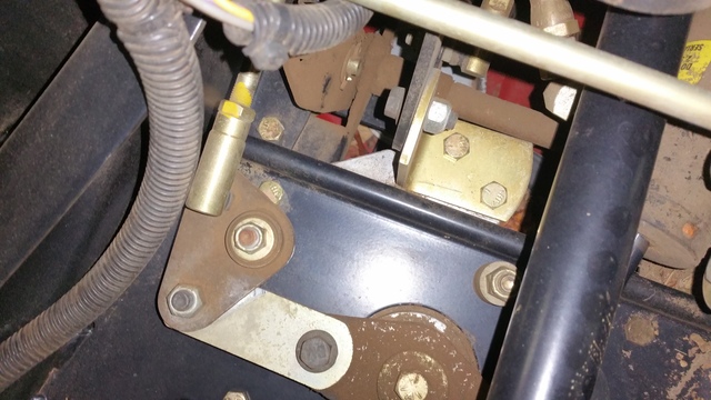

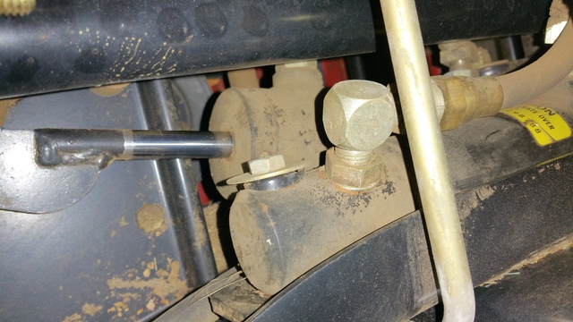

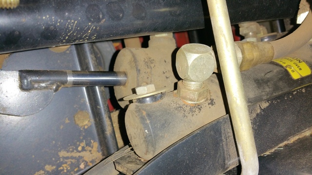

JERSEYHAWG / Glenn 4,589 #21 Posted December 14, 2015 http://thetoropartstore.com/media/catalog/product/cache/1/image/9b95981416219f6fcb0b9646f8cc8498/t/o/toro-73561-522xi-toro-522xi-garden-tractor-sn-210000001-210999999-2001-power-steering-lower-assembly_1.jpg I just took the link off the web. when I get in the garage later I will see what I can see for a picture. not sure....... Glenn 1 Share this post Link to post Share on other sites
WHX?? 57,938 #22 Posted December 14, 2015 Thanks Glenn that what I would have been lookin for ...some kind of ram. I would think that also some sort of control valve on the end of the steering column with associated hoses goin to the hydro for power. Thinkin this might be a project to retrofit to PS but not impossible with the right stuff, I mean if it was done as an option at the factory?? Share this post Link to post Share on other sites
JERSEYHAWG / Glenn 4,589 #23 Posted December 14, 2015 I just took the link off the web. when I get in the garage later I will see what I can see for a picture. not sure....... Glenn the pictures arent to good at all. its hard to get in there for me. i think the exploded view gives a better idea / view 1 Share this post Link to post Share on other sites
