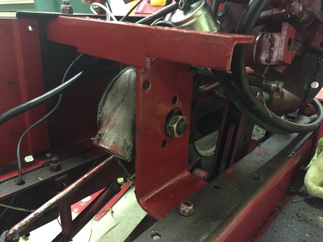

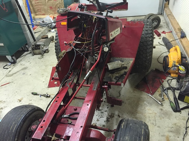

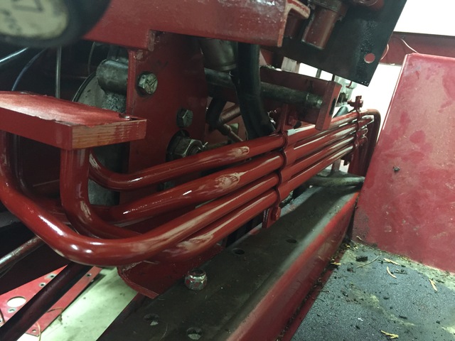

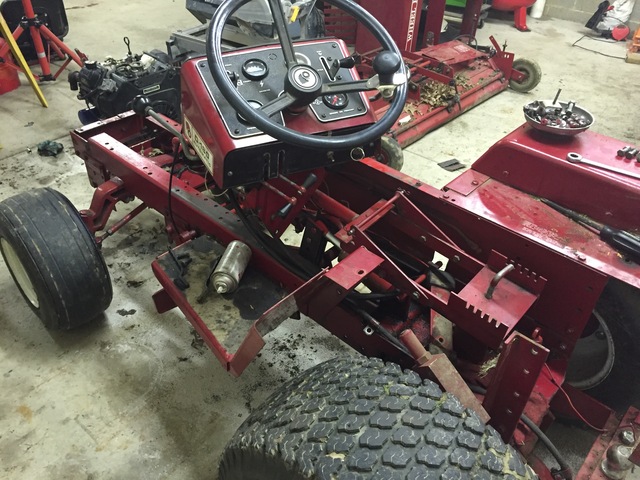

I knew is was going to take a little effort to replace the manifold on my D180, but I had no idea! Holy smokes! I should have just planned on restoring the thing while I was at it! The good news, though, is that I found that the "T" bracket that supports the steering column was totally cracked in two near the weld. No wonder my steering was sloppy. Got it re-welded and the new manifold installed. Working on putting everything back together. I wish I wasn't so anal about making sure every bold makes it back into it's original spot! Just hoping this resolves my front manifold leak. After two attempts at putting new seals (and failing), I came to the conclusion that there must be a hairline crack where the tubes insert into the mounting plate. I'll find out soon enough.

Wow, you went deep brother.  Glad to hear you found the source of your steering problem.

Kinda like having to tear apart the entire house to replace the front door knob...:omg:    I see you picked up all the empty beer cans before you took the picture......  :teasing-poke:      :lol:

DougC, exactly! And in the process, you find out the door jamb wasn't attached to the studs! I'm gonna look at it as a blessing in disguise, but my fear right now is that I'll get it back together and the doorknob is defective! Really hoping I've got the leak fixed in the process. If not, you might see the beer cans!
