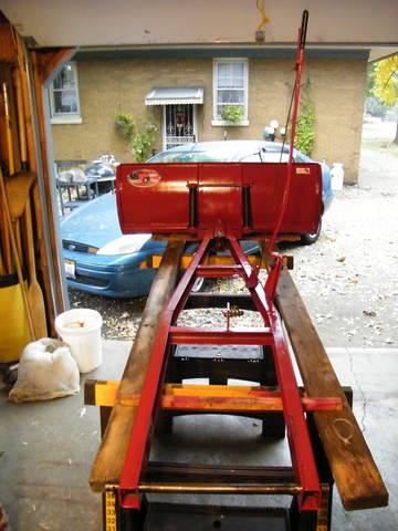

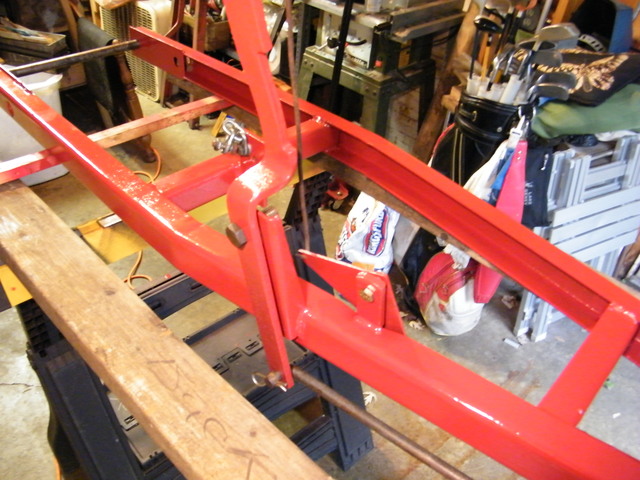

I have a friend a few towns away that is looking for a blade for his 84-6 312-8.  I have a couple of short frame blades from the sixties and wondered if they might fit his 312-8.  Any ideas? Thanks.
953 nut
Sorry, too short, there was an extension adapter made but not too common. If he or you can weld it wouldn't be too hard to extend it.
Fun Engineer
Thanks Richard. That's what I was thinking.
stevasaurus
Actually, that frame will fit, but you will not be able to angle the blade...it will hit the front tires.  If you want Dave, I have a frame that works on either short or long horses by changing the bar on the back to different holes,   The holes are 6" apart...center to center and would be easy to fab up.  A couple of pictures.  :)
