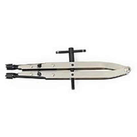

Digger 66 3,530 #3 Posted November 29, 2015 That's similar to what I have ^ One of the intakes on each head is nestled into the casting far enough where it could be used if I could "window" out a socket to get the keepers back on . Anyone have any experience with this type ? http://www.amazon.com/OTC-4572-Large-Spring-Compressor/dp/B000F5ECUY/ref=pd_sim_263_5?ie=UTF8&dpID=41NCjhyf03L&dpSrc=sims&preST=_AC_UL160_SR160%2C160_&refRID=0RD07897QKJN684ZSBPX Share this post Link to post Share on other sites

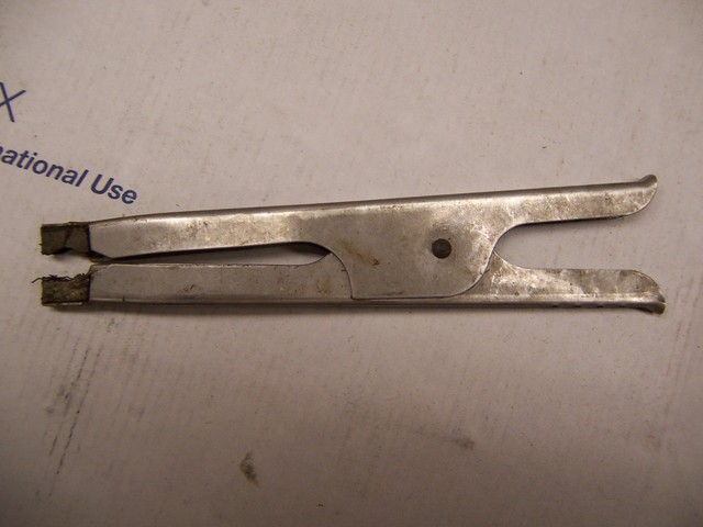

953 nut 70,292 #5 Posted November 29, 2015 I have a spring loaded magnetic valve keeper holder thingy, that will hold the keepers in place while you release the valve spring. I will look for it tomorrow and give you any information I can find. I have had it for over 40 years so not sure if it is made any more, probably on though. Share this post Link to post Share on other sites

KC9KAS 4,746 #7 Posted November 29, 2015 @Digger 66 I am afraid the one you had a link to will not fit into the small space on our small engines. Share this post Link to post Share on other sites

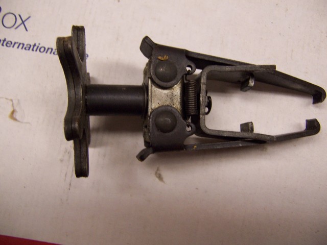

953 nut 70,292 #10 Posted November 30, 2015 20 hours ago, 953 nut said: I have a spring loaded magnetic valve keeper holder thingy, that will hold the keepers in place while you release the valve spring. I will look for it tomorrow and give you any information I can find. I have had it for over 40 years so not sure if it is made any more, probably on though. I took a couple of pictures of the tool, no name on it , but I know KD Tools made one like it. The jaws have magnets to hold the keepers and is spring loaded to hold them on the valve. Also took a picture of a KD Tools spring compressor that I use on OHV engines. 1 Share this post Link to post Share on other sites
Digger 66 3,530 #11 Posted November 30, 2015 That's pretty neat . I usually just fumble with a telescopic magnet & a dental pick Share this post Link to post Share on other sites
KC9KAS 4,746 #12 Posted November 30, 2015 This is the one with a link that I thought WOULDN'T work Share this post Link to post Share on other sites
