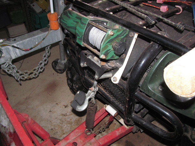

Ed Kennell 46,557 #32 Posted February 8, 2016 Just thinking about your idea of a solenoid activated pin. Not trying to question your idea, but I'm afraid it would take a pretty elaborate electronic system to position the sector accurately enough to eliminate any binding so the solenoid could pull the pin. I don't know If it would help in your application, but I have a mechanical pin pulling system on the blade of my quad. that may be of value to you. I use the winch to raise the plow, and if I continue to raise the plow higher than normal, a cam mounted on the plow frame hits the quad frame and rotates pulling the sector pin. This then allows me to angle the blade to the new position. When the blade is lowered slightly, the cam releases the pin to drop back in the new hole. This pic shows the plow raised and the pin pulled. The springs in the lift are necessary to handle the overrun of the 3Klb winch. Don't ask how I know this. 5 Share this post Link to post Share on other sites

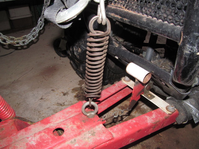

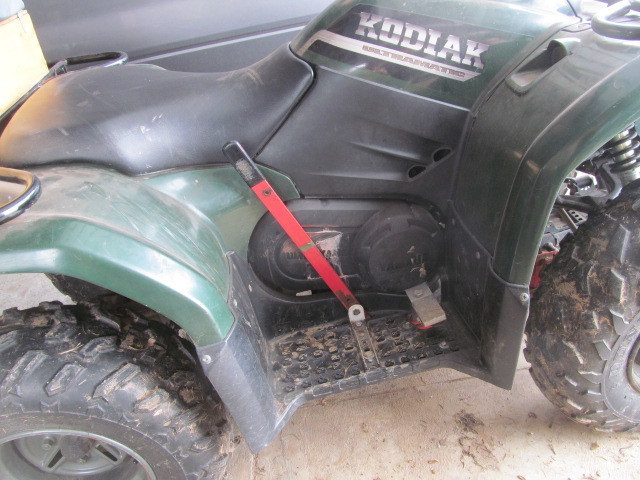

Ed Kennell 46,557 #36 Posted February 8, 2016 No, I don't have to get off Jim. I have extended the push pull rod back under the right floor board of the quad where it is attached to a short angle control lever. 1 Share this post Link to post Share on other sites

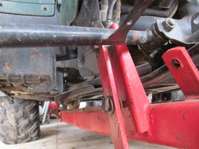

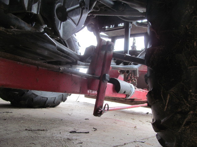

Ed Kennell 46,557 #42 Posted February 9, 2016 OK Paul, I just plowed 8" of the heavy wet stuff with the 312H and I am ready to add power angle to the 48" plow. I originally bought this rig as one I would resell, but it is now a keeper. Have you given any thought to simply using a WH lift cylinder for angle control? Not to hijack your thread Paul, but here are a few pics of the plow angle control on my quad for Jim. I just cut off the lever above the bracket on the plow and moved it back to the side of the quad and connected it with another rod. The plow frame was positioned on the quad so the angle lever and pin pulling cam brackets would clear the A frame and did not require any mods. So I can easily remount it on a WH. 2 Share this post Link to post Share on other sites

PaulC 342 #44 Posted February 10, 2016 15 hours ago, ekennell said: OK Paul, I just plowed 8" of the heavy wet stuff with the 312H and I am ready to add power angle to the 48" plow. I originally bought this rig as one I would resell, but it is now a keeper. Have you given any thought to simply using a WH lift cylinder for angle control? Not to hijack your thread Paul, but here are a few pics of the plow angle control on my quad for Jim. I just cut off the lever above the bracket on the plow and moved it back to the side of the quad and connected it with another rod. The plow frame was positioned on the quad so the angle lever and pin pulling cam brackets would clear the A frame and did not require any mods. So I can easily remount it on a WH. Ed that is one nice 312H and i know from having one they are very nice machines so i am not at all surprised your keeping that beauty! If i remember correctly i think the hydraulic lift cylinder has a similar stroke to the actuator i used which is 4", and i actually think member @elliot ness just recently mounted one to his plow for the angling but i dont know if he ever made it anywhere with it, maybe he will update or add a comment here. I do think hydraulics would be the best option but those cylinders can be tough to find and pricey and im not sure about tapping into the original system, others have done it though? It would be really fast though which would be great and i think the hydraulic cylinder would hold up much better. It would be really sweet with quick connects on the lines, you could drive right over the plow and literally hook and unhook in 2 minutes, that was the greatest benefit behind my idea. Maybe this will be the route i go when i get back to it because this really would be the best setup. You have been very helpful with this thread so you are not at all hijacking. You really thought that out and did quite the job mounting the plow on the quad. 13 hours ago, pyroplegic said: PaulC, Purely accidental while watching a ford tractor plow, I see what I'm trying to do. Now that one's hydraulic controlled as I'd like to use linear actuator .Looks like the ford plow is an A-Frame type mount to the rear axle and a lift cylinder in front of the hood. Thats a beefy looking machine, I fixed up a ford for someone recently and it was a pretty nice tractor! That idea doesnt seem like it would be hard to makeup but you should just think about picking your pops up another awesome and just mount the plow and leave it. Even a manual lift tractor wouldnt be bad because the plows arent that heavy. If you do end up going the actuator route here is the part# for the momentary switch wheel horse used for the electric lift kit on the manual lift tractors, 55046-04 google search and you should be able to find it for 12 bucks. Not the one i used because i found it afterwards but its the one i would go with now. Share this post Link to post Share on other sites

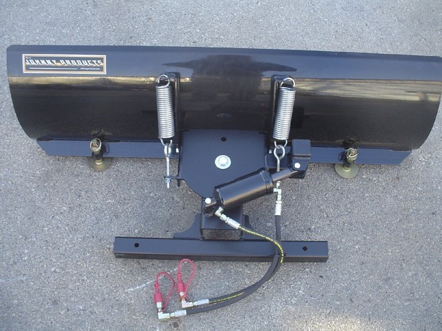

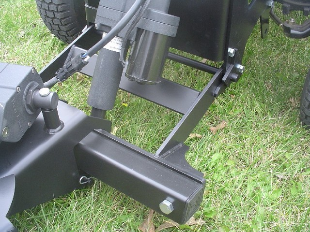

shallowwatersailor 3,221 #45 Posted February 10, 2016 I think the issue is the linear actuators price vs ability. My Johnny Bucket use Warner actuators which are pricey but seem to have more strength than what has been discussed. JB sells a 42" a Johnny Plow that uses the actuator to swing the blade. http://www.johnnyproducts.com/J_Bucket_HTMs/Johnny_Plow_Jr.htm 1 Share this post Link to post Share on other sites
PaulC 342 #46 Posted February 10, 2016 46 minutes ago, shallowwatersailor said: I think the issue is the linear actuators price vs ability. My Johnny Bucket use Warner actuators which are pricey but seem to have more strength than what has been discussed. JB sells a 42" a Johnny Plow that uses the actuator to swing the blade. http://www.johnnyproducts.com/J_Bucket_HTMs/Johnny_Plow_Jr.htm interesting info John thanks! That actuator definitely is beefy and the thing that jumps out to me the most is how the actuator is mounted at almost a 45 degree angle to the blade, to where mine is mounted close to 90. Not sure that would have any effect or not though? Share this post Link to post Share on other sites

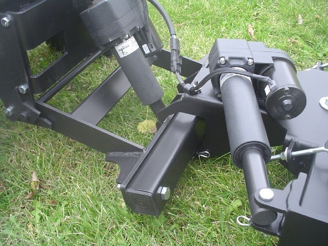

shallowwatersailor 3,221 #47 Posted February 10, 2016 2 hours ago, PaulC said: interesting info John thanks! That actuator definitely is beefy and the thing that jumps out to me the most is how the actuator is mounted at almost a 45 degree angle to the blade, to where mine is mounted close to 90. Not sure that would have any effect or not though? I just spent some additional time on another tractor forum. I'm still focused on adapting my Johnny Bucket to a 5xi, but looked at his plow adaptation to the JB bracket. By the way he does offer a 48" plow as well. His plow design is different than WH but his mounting could be adapted the WH plow. He seems to use a U-channel mount for the shaft further out towards the end of the blade. The motor end just seems to be a reinforced mounting pad on the frame. The WH sector plate is rather thin so a better location may be a plate between the two rails of the frame. The photo is a hydraulic Johnny Plow Sr. but would be similar for an electric actuator. 1 Share this post Link to post Share on other sites
shallowwatersailor 3,221 #48 Posted February 10, 2016 Here are a couple more photos of how Johnny Products mounts the actuator.For the motor end it appears to be a steel tube that a clevis pin drops down, and what I thought was a U-channel is actually two of his weldments. 1 Share this post Link to post Share on other sites

shallowwatersailor 3,221 #50 Posted February 11, 2016 (edited) 17 hours ago, PaulC said: interesting info John thanks! That actuator definitely is beefy and the thing that jumps out to me the most is how the actuator is mounted at almost a 45 degree angle to the blade, to where mine is mounted close to 90. Not sure that would have any effect or not though? I think having it operate on an approximately 45- 80 degree angle lessens the stress on the actuator. The pivot bolt will share more of the load, I think. But I still believe that it depends on the need to be heavy duty for this application. JB is selling them commercially with a warranty and I haven't found any complaint of them failing, other than one customer overworking the bucket. Edited February 11, 2016 by shallowwatersailor 1 Share this post Link to post Share on other sites
