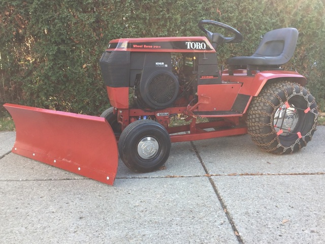

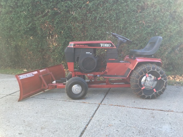

PaulC 342 #1 Posted November 23, 2015 I got myself a plow for this coming winter season. It wasn't pretty so I decided to clean it up and paint it. Then I decided to Pimp it out with an electric actuator for angling the blade. Works pretty nice now but we'll see if it can stand up to the potential beating it might see. IMG_1441.3gp 17 Share this post Link to post Share on other sites

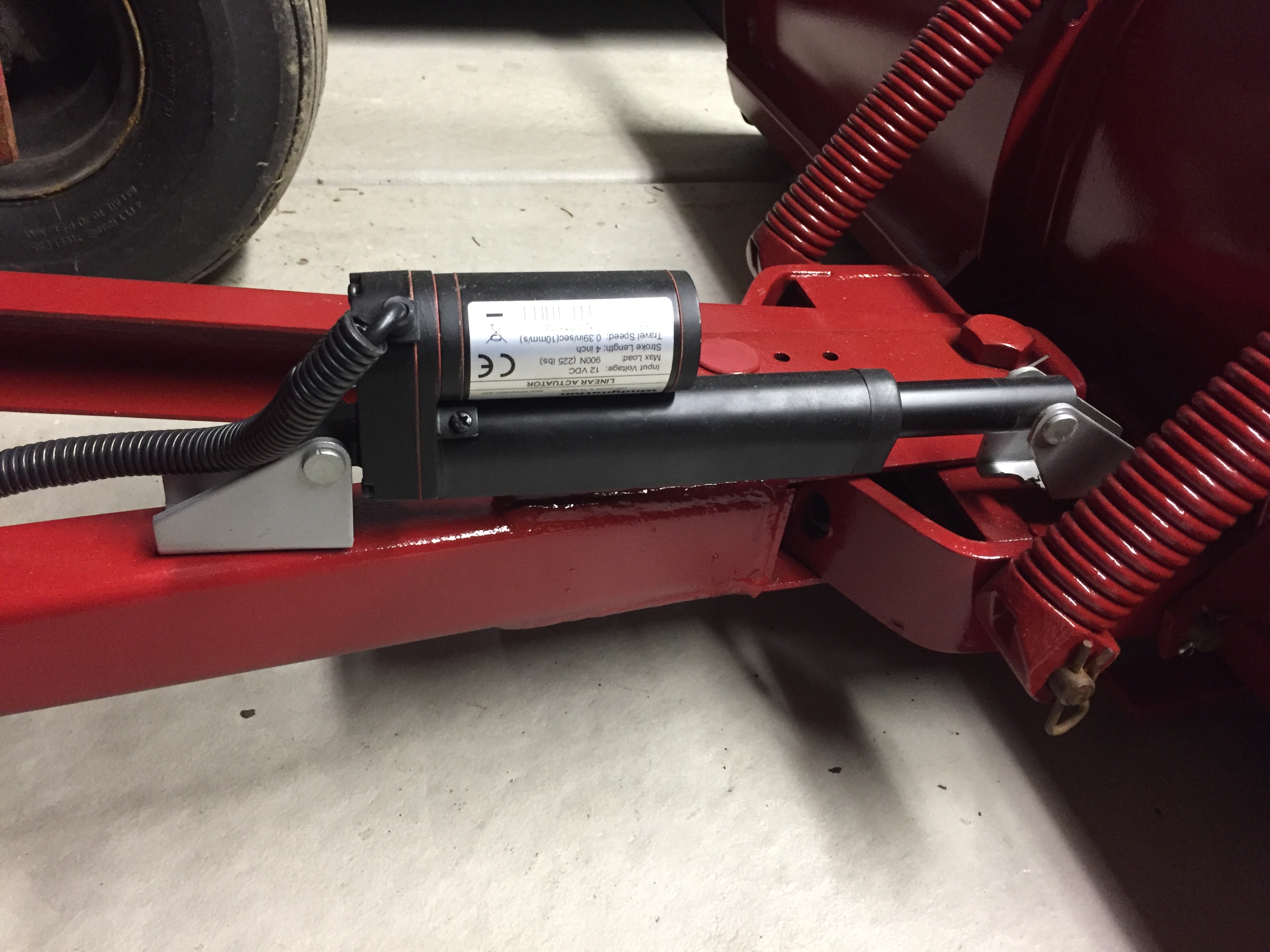

Ed Kennell 47,030 #2 Posted November 23, 2015 Really nice rig Paul. Can we get a few more details on the actuator and the mounting? 3 Share this post Link to post Share on other sites
RedRanger 1,470 #3 Posted November 23, 2015 (edited) Just don't try to adjust the actuator while pushing or with snow against the blade. Is the actuator waterproof? Is there a retaining pin once the blade is angled or does the actuator take all the abuse? Edited November 23, 2015 by RedRanger 2 Share this post Link to post Share on other sites
shallowwatersailor 3,221 #4 Posted November 23, 2015 We'll see when Paul comes back with more information. It looks like an HD actuator similar to the ones on Johnny Bucket. They have a 1-1/8 shaft and should be as strong as a hydraulic cylinder of similar size. 3 Share this post Link to post Share on other sites
DougC 2,644 #5 Posted November 23, 2015 1 hour ago, ekennell said: Really nice rig Paul. Can we get a few more details on the actuator and the mounting? Yes please on more details Paul. I want to do that to my blade as well. 1 Share this post Link to post Share on other sites
PaulC 342 #6 Posted November 23, 2015 50 minutes ago, ekennell said: Really nice rig Paul. Can we get a few more details on the actuator and the mounting? Thanks Ed I got the actuator from amazon, here is the link http://www.amazon.com/WINDYNATION-Actuator-Maximum-Mounting-Brackets/dp/B012EFMPRE/ref=sr_1_9?ie=UTF8&qid=1447244536&sr=8-9&keywords=linear+actuator+4+inch+stroke. Planning to control it with a momentary toggle switch similar to what did with the electric lift kit for manual tractors, amazon has let me down with that one though it was supposed to be here last Wednesday. The mounting turned out easier then I expected. I utilized the brackets that came with the actuator and only had to drill 1 new hole in the plow frame, which is the fixed end. The other end, the one that pivots, I utilized the existing hole on the top side of where the 1/2 rod of the original linkage used to attach. I used a 5/16 bolt with a series of washers and nuts to get it up high enough to clear when turned and used bronze washers on top and below the bracket to aid in the pivoting. 48 minutes ago, RedRanger said: Just don't try to adjust the actuator while pushing or with snow against the blade. Is the actuator waterproof? Red the actuator is supposed to be able to withstand harsh conditions so I expect it to hold up fine in that regard. My concern is the fact that the actuator is whats going to hold the angle of the plow, I had to drop the lock pin. Its a nice feature because I now have infinite angle positioning instead of the 3 fixed positions but it started to creep into my head if there's potential of back-driving the actuator enough to break it? 28 minutes ago, shallowwatersailor said: We'll see when Paul comes back with more information. It looks like an HD actuator similar to the ones on Johnny Bucket. They have a 1-1/8 shaft and should be as strong as a hydraulic cylinder of similar size. John it is pretty heavy duty for its size with over 300lb static force and I have a feeling with the way I mounted it utilizing the brackets it came with(which aren't heavy duty) that the brackets will fail before the actuator....hopefully at least 10 minutes ago, DougC said: Yes please on more details Paul. I want to do that to my blade as well. Doug and everyone else I will take and post some close up photos of the actuator and mounting. I never seem to think of my forum thread making while im working so I never step back to take the photos that will help tell the story. 7 Share this post Link to post Share on other sites

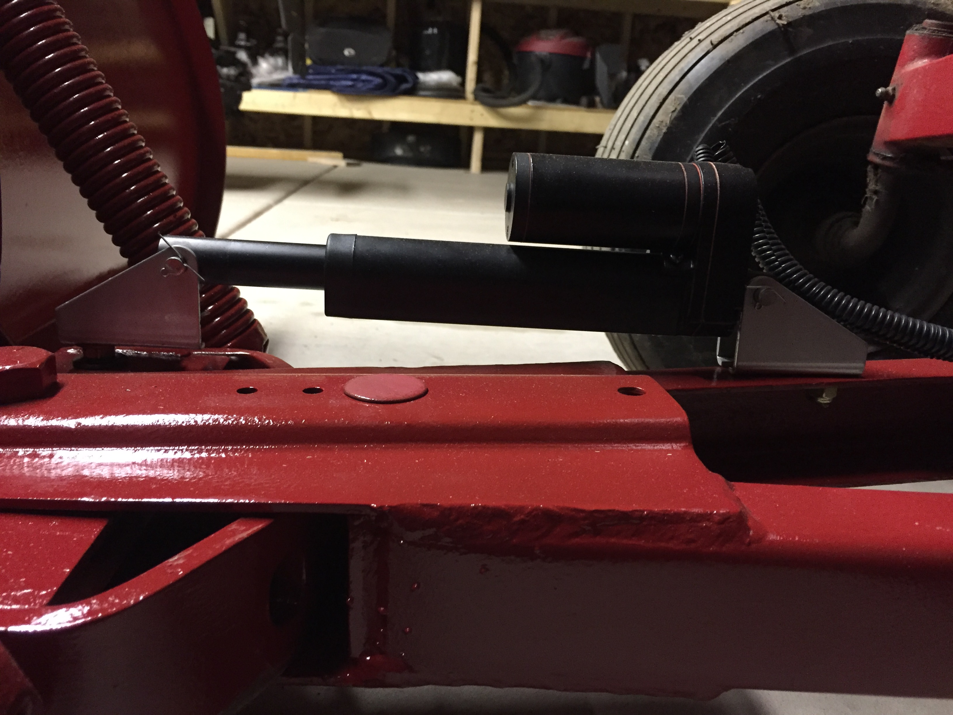

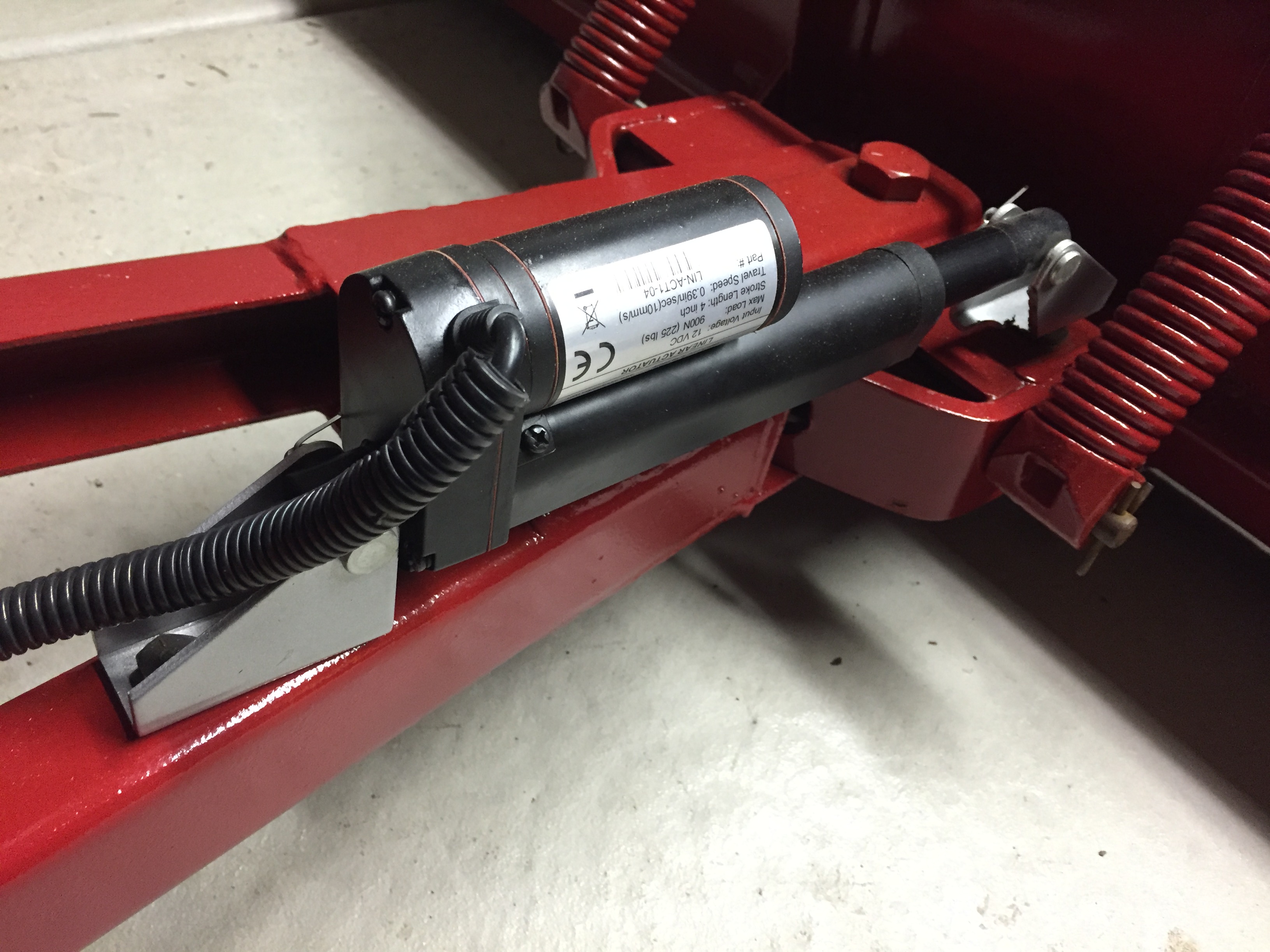

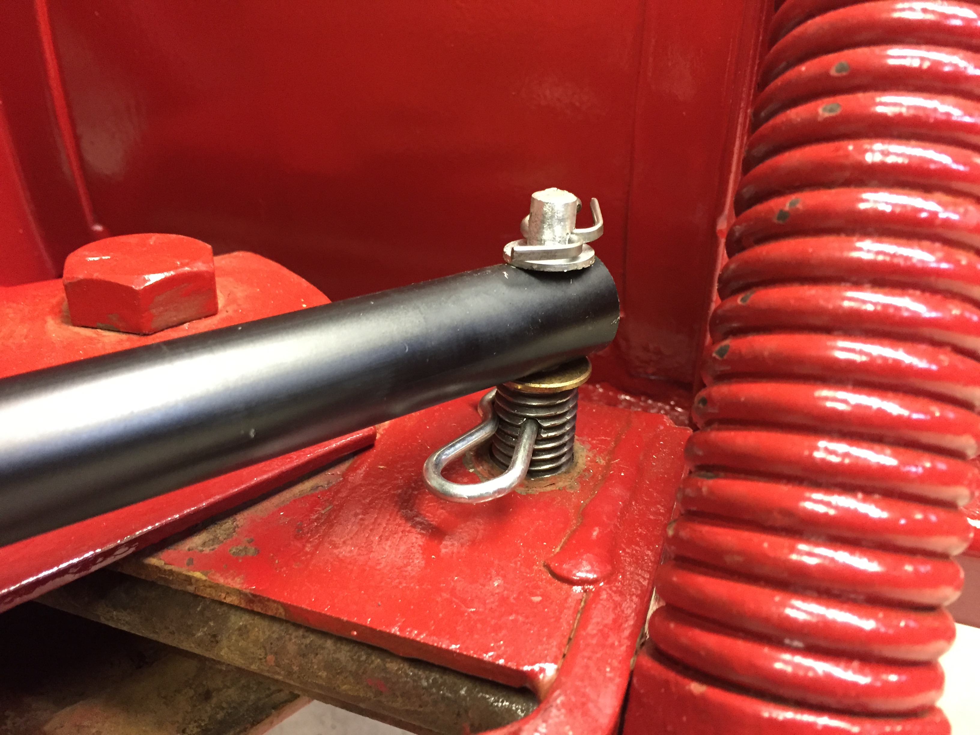

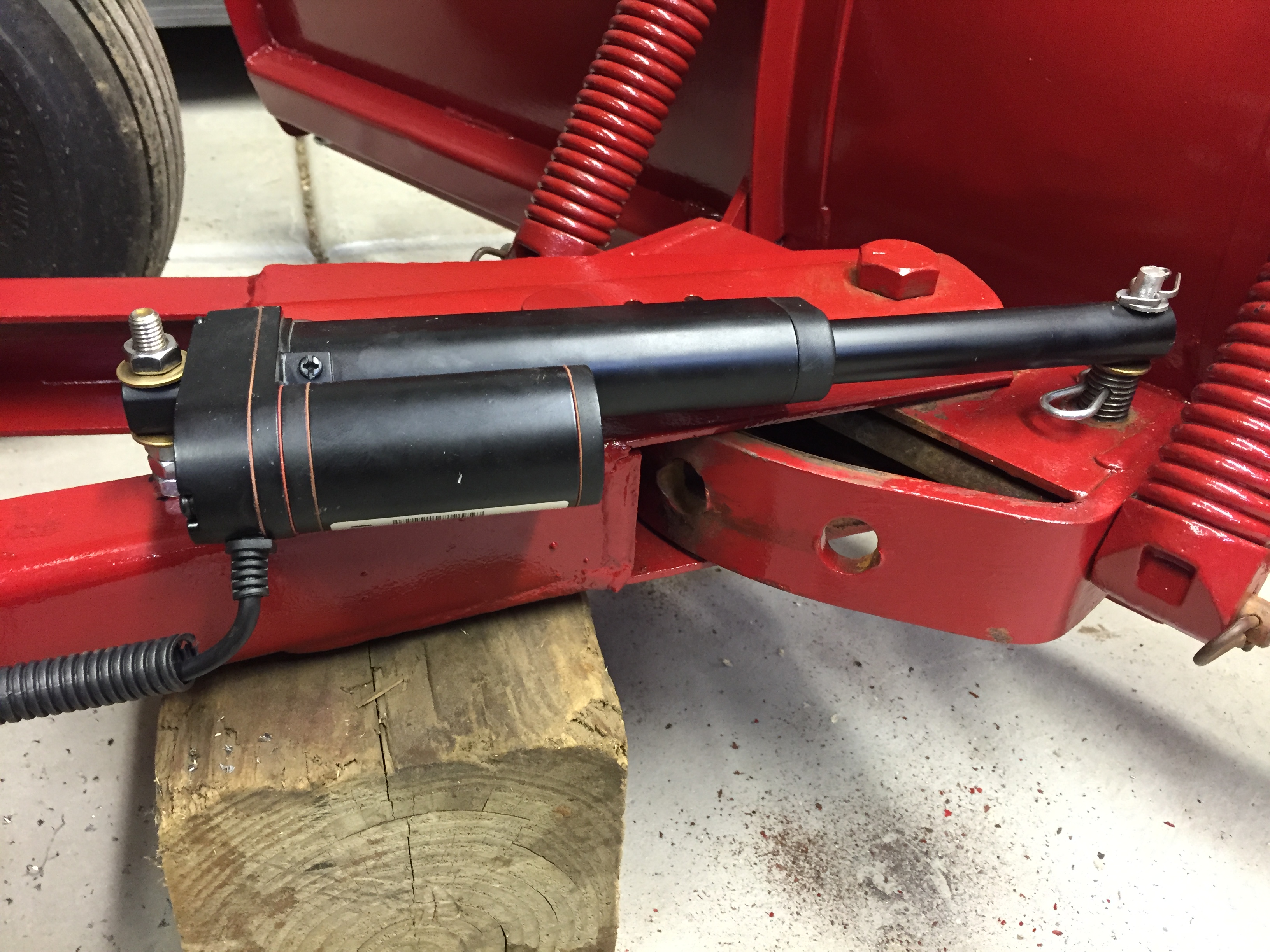

PaulC 342 #10 Posted November 23, 2015 Thanks guys!! Here are some close ups of the actuator. I had to cut the corner off the bracket closest to the blade to clear the spring 8 Share this post Link to post Share on other sites

Wheel-N-It 2,978 #14 Posted November 24, 2015 I like seeing the 312's fitted up for serious work of any kind. 1 Share this post Link to post Share on other sites

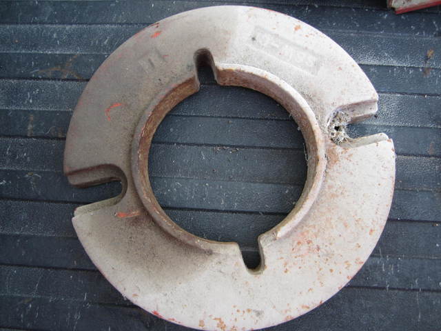

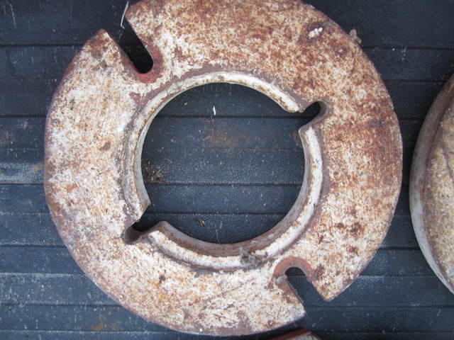

TDF5G 2,074 #22 Posted November 24, 2015 (edited) I've always plowed with chains on AG cleat tires, no weights with my B-80. I want try out the new-to-me B-100 this year for pushing snow. I'm gonna try turf tires and chains, which seems to be the general consensus for traction here on the forum. I've got some front and rear weights to try out also. The B-80 seemed to lose traction on the front end. I've got these rear weights, don't know what brand they are. I'd like to find some cast WH rear weights to match my front ones. Never used a snow thrower on the WH, I may hunt one down some day. Edited November 24, 2015 by TDF5G 1 Share this post Link to post Share on other sites

shallowwatersailor 3,221 #24 Posted November 24, 2015 Paul, those brackets do look like the weak point. That is the same one I used on my chute deflector. There are these two sizes of cast brackets at Surplus Center as an alternative. http://www.surpluscenter.com/Brands/Concentric-International/LINEAR-ACTUATOR-MOUNTING-BRACKET-LIGHT-DUTY-5-1577-B.axd http://www.surpluscenter.com/Brands/Concentric-International/ID-SERIES-LINEAR-ACTUATOR-MOUNTING-BRACKET-5-1679-B.axd 1 Share this post Link to post Share on other sites

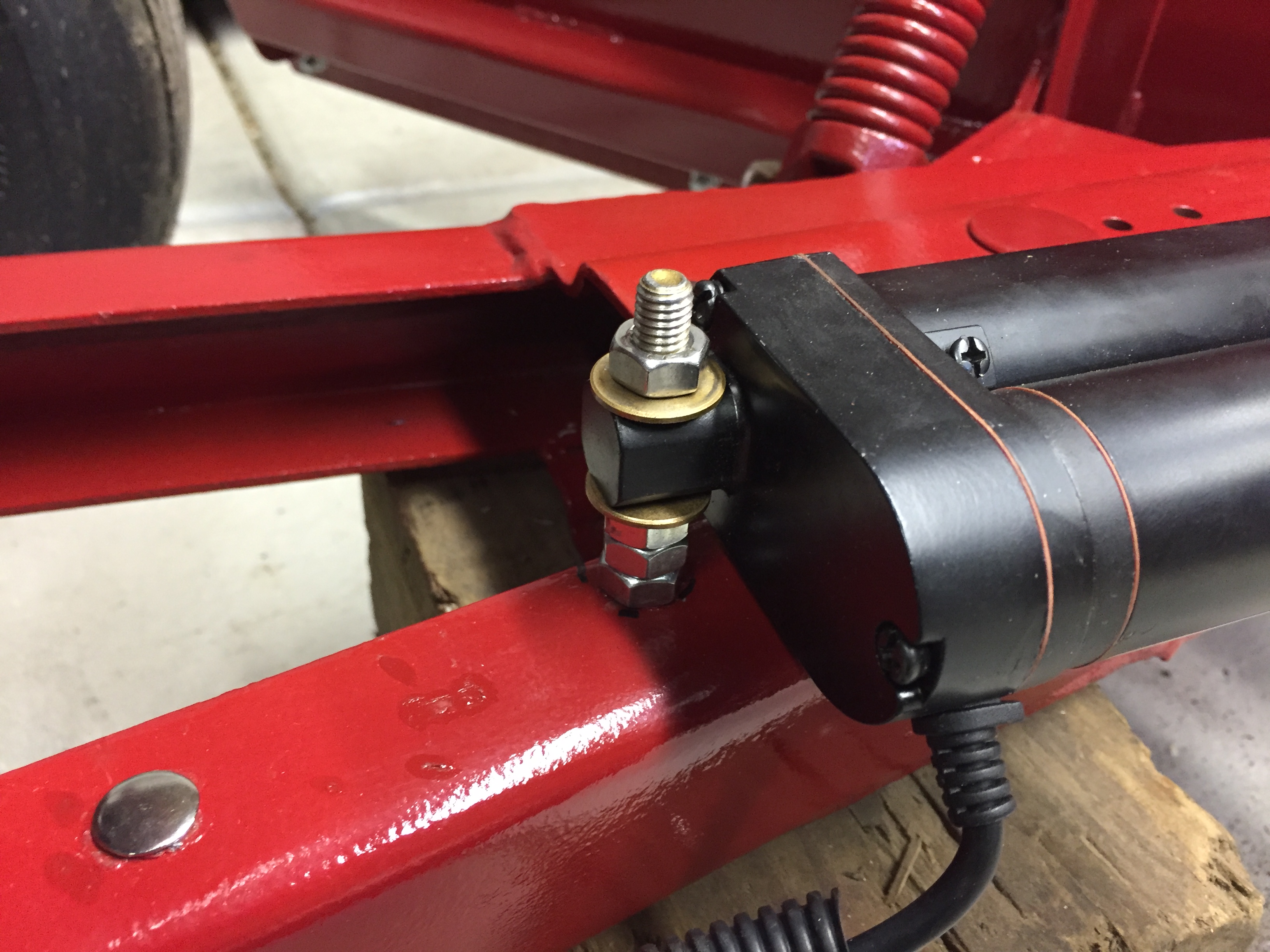

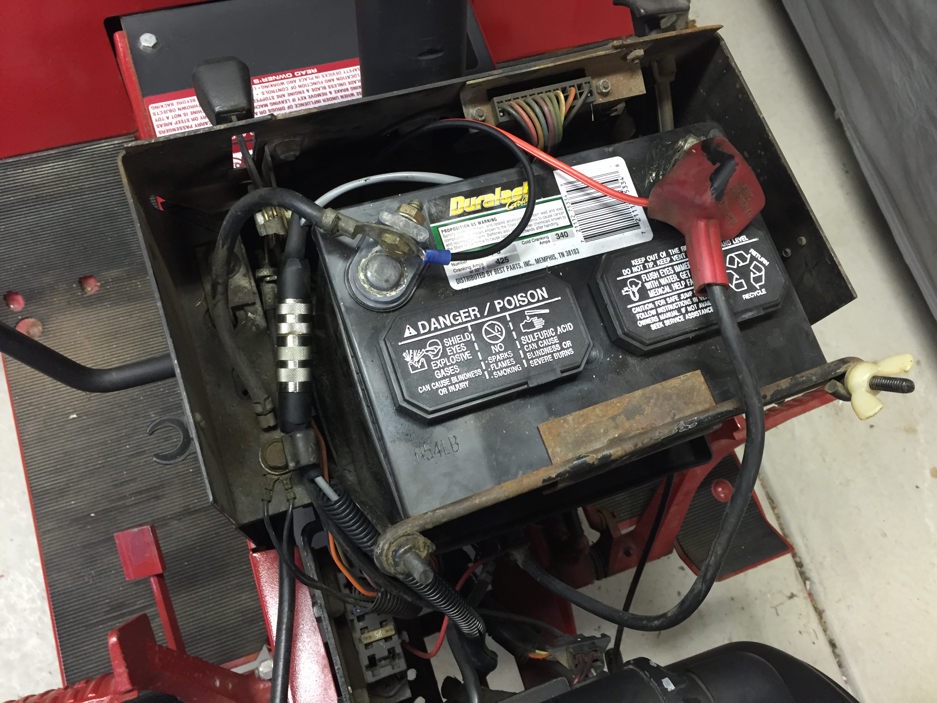

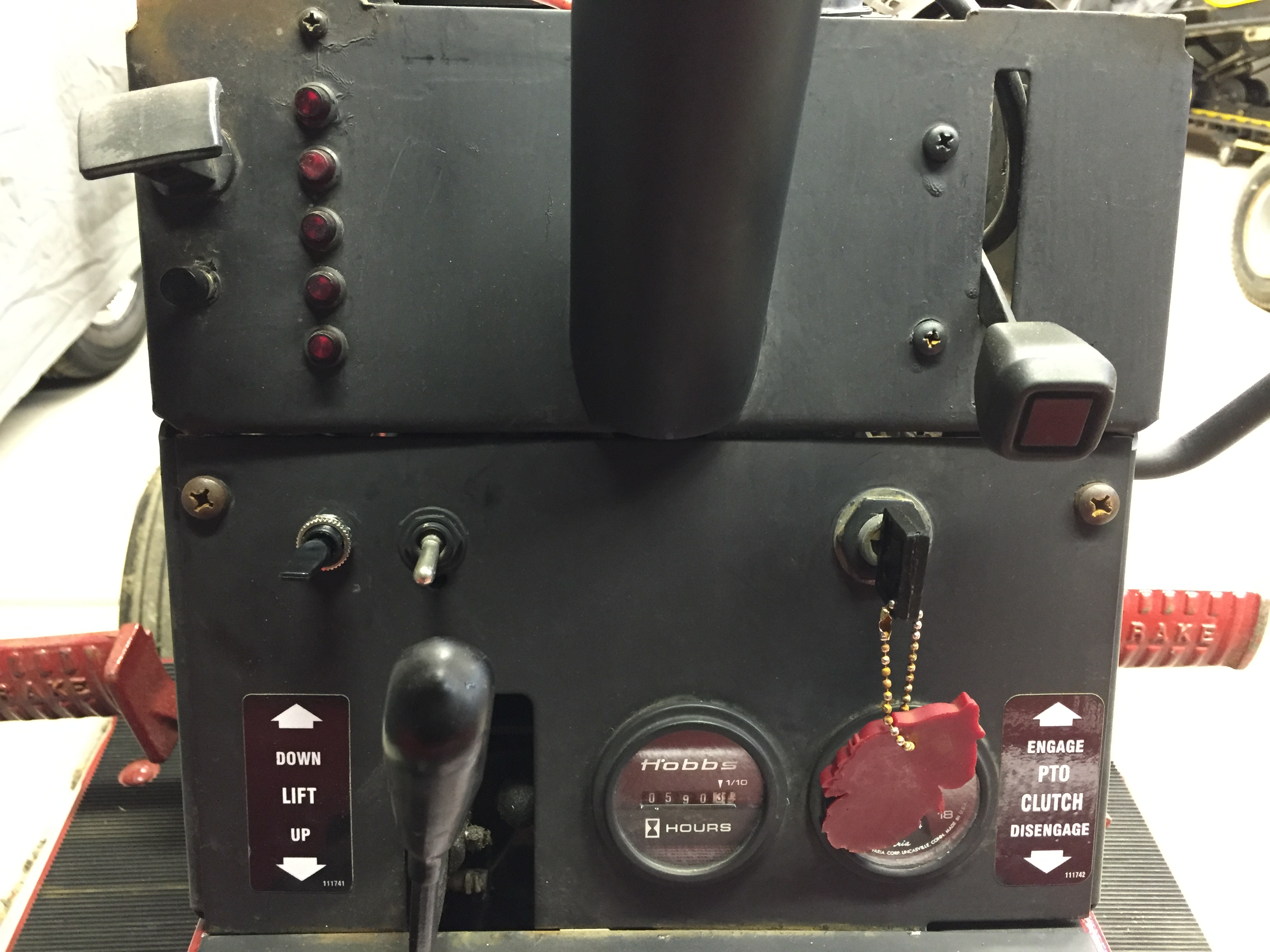

PaulC 342 #25 Posted November 28, 2015 Well I got the switch installed and wired up put it right next to the light switch. Got a neat little twist together quick disconnect from work for when removing Then once I started playing around with it some more I decided the brackets it came with had to go. The plow was moving all over the place because of all the movement in the brackets. I decided to do what I thought from the get go and turn the actuator on its side and figured out a pin setup it could rotate on. I had to drill a new hole on the frame for the rear mount and I just used a bolt with a stack of 3 nuts to get the height I needed For the front mount I still used the existing hole for the original linkage. The hole is 5/8 so I took a piece of 5/8 threaded rod and bored a 5/16 hole in the end, then crossed drilled an 1/8 hole for a hitch pin. Then for my pin for the actuator I used some 5/16 aluminum rod. I'm hoping this will act as a shear pin in the event I whack something so I made a few extras while I was at it. im much happier with this setup there isn't much play in the blade anymore. Everything seems a lot stronger too I pushed pretty good on one side of the blade and the actuator didn't budge. So besides the wheel weights I still want to make for this rig I think I'm all ready and just waiting to push some snow. None in the forecast though and at this time last year we already had several feet come and go. I'm sure I'll get my chance though 5 Share this post Link to post Share on other sites
