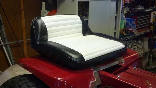

RedRanger 1,470 #11 Posted November 11, 2015 (edited) You can also find a seat cover for your seat in the vendor section here. Edited November 11, 2015 by RedRanger 3 Share this post Link to post Share on other sites
