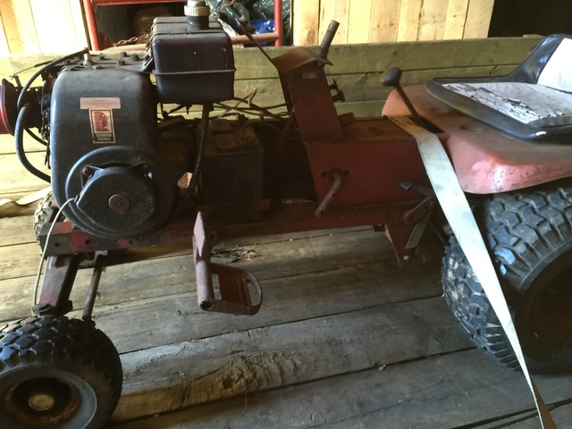

smoreau 658 #1 Posted July 13, 2012 :confusion-helpsos: I'm trying to get Gabbys Lawn Ranger ready for the Charlotte show and I want to buy some new tires front and rear. Ags in back and 3 rib in front. Rears will be 18x9.50-8's and I need to figure out what size for the front. The options are 1 of these 3 tires. 3.00-4, 3.50-4, and 4.00-4. They will be tubed as they are split rims. Has any one put 3 ribs on a lawn ranger? pics are good for comparison. hear is the tractor before the tare down. So any help would be appreciated! Share this post Link to post Share on other sites
