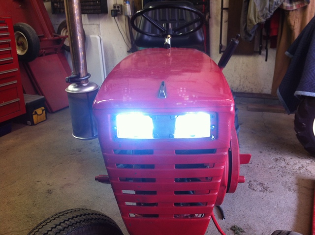

kingnothing71us 108 #1 Posted November 6, 2015 I thought I'd try something today and to my surprise, it worked! I bought a pair of 15 LED bulbs from Autozone. I took the reflector out of the light (where the bulbs go) and lined it with chrome vinyl. plugged the bulbs in and, voila, LOTS of light. I don't know if anyone has done this but if you need alot more light, you should give it a try. The bulbs I bought are Sylvania 1156 Cool White. Just thought I'd share. 2 Share this post Link to post Share on other sites

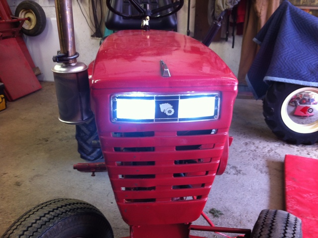

squonk 47,374 #5 Posted November 6, 2015 Skonk's new lights: 6 Share this post Link to post Share on other sites

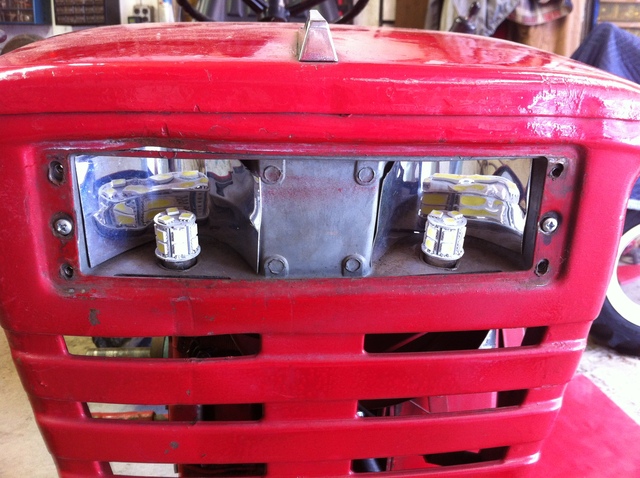

kingnothing71us 108 #8 Posted November 6, 2015 squonk, thats how my lights look. I think they're awesome. And yes Mike, I agree with bmsgaffer. Even the salesman at Autozone pointed that out to me because I said I was putting them in an older lawn tractor. He said, "They should work, says right here "for off road use only"." Ha-Ha. Hey squonk, what did you use for the reflector? It looks like made to fit plastic mirror. I would've posted pics but it was dark when I did the work. Share this post Link to post Share on other sites

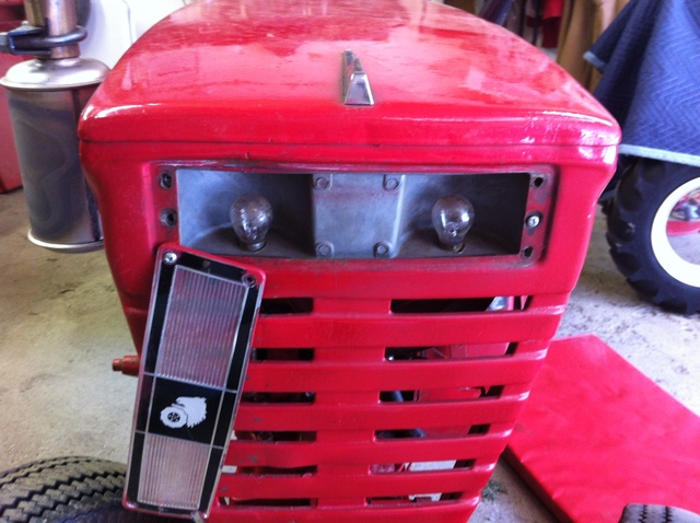

squonk 47,374 #9 Posted November 6, 2015 (edited) They installed reflective metal panels in all the lights in one of our bldgs. They left behind a panel so I scarfed it. I cut a couple of pieces bent them to fit and siliconed them in. Edited November 6, 2015 by squonk 1 Share this post Link to post Share on other sites
