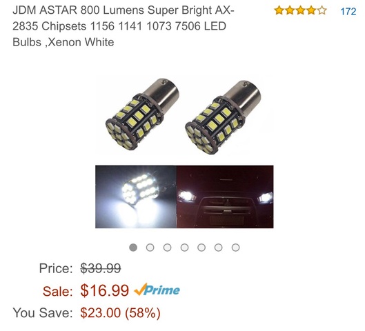

DennisThornton 4,773 #4 Posted October 14, 2015 (edited) I was just about to post that both of my attempts were no improvement over plain incandescent bulbs, but maybe $17 each would be! Gadds!From link below:A standard 1156 bulb puts out about 400 lumens when new. As of January 2010, I haven't found an LED replacement that puts out any more, and most are only 50 lumens or so, not enough for a standard 1156 housing.To confirm the above: From Bosch Automotive Handbook7th ed. a 1156 (BA15S) Stop/Turn 21W bulb puts out 460 lumens. For a 5W Side marker / Tail BA15S it is 50 lumens (strangely low, I know) and 10W Tail light 125 lumens.http://www.answers.com/Q/How_many_lumens_for_an_led_replacement_vs_stock_1156_bulbSo these 800 lumen LEDs should be rather impressive! Price certainly is!Hey! Just noticed the price is indeed for a pair! I just ordered from Amazon! Edited October 14, 2015 by DennisThornton Just noticed the price is indeed for a pair! 2 Share this post Link to post Share on other sites

Theroundhousernr 590 #10 Posted October 15, 2015 http://www.amazon.com/JDM-ASTAR-Extremely-Chipsets-Projector/dp/B00NPIN8FI/ref=sr_1_5?ie=UTF8&qid=1444919229&sr=8-5&keywords=1156+led Here is the link. There are others with higher lumens but not as good reviews. This company even states in the listing to beware of fake sellers and to contact them if you suspect issue. I agree with the super bright led floods and spots are a better option for use like I have on my snow cab. But for those who want to keep a show tractor original with better lights for night time use like parades, these could be a great option. I might try them myself. Share this post Link to post Share on other sites

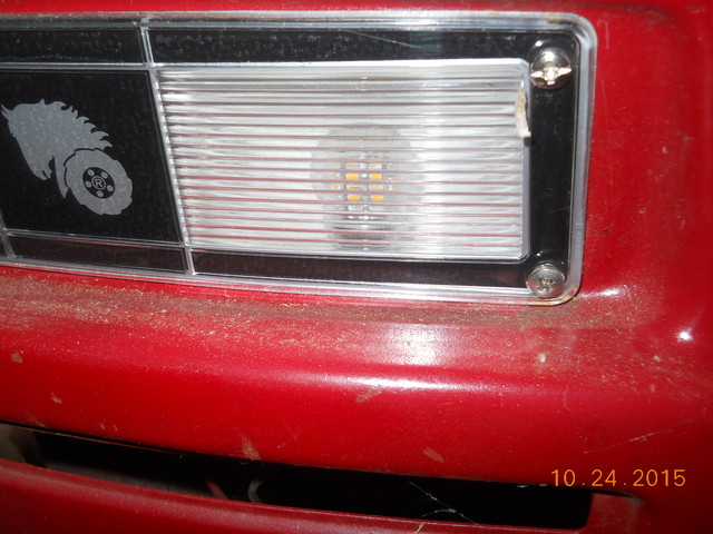

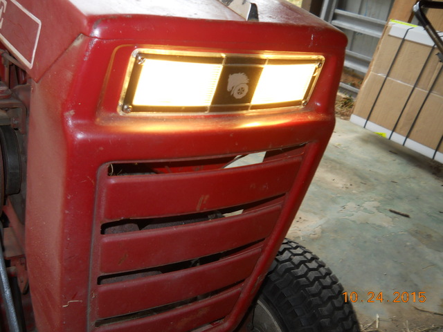

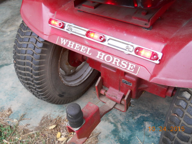

IndyFord2 51 #12 Posted October 24, 2015 If your going to keep it switch to LED it's well worth the money. Like mentioned before super low amp draw and almost no heat.I have actually melted a plastic lens on my C100. I have 2 pick ups and have switched all back up, cargo, 3rd brake & interior lights to LED. The pic's don't really do it justice, they do work well at night. I use superbrightled.com and have been happy with there products and there return policy is good if you aren't happy with the lights. I went with the more traditional look, it's not as bright as the other ones shown but like I said I'm happy. This is a new lens cover and I removed & painted the housing white.I got the rear light bar at a local store. (drilled NO holes) Got two magnets from the hardware and fastened them to light bar, it's almost too bright at night. What you cant see is an LED map light mounted up under the rear fender. Its a perfect hook up light and has its own switch 1 Share this post Link to post Share on other sites
