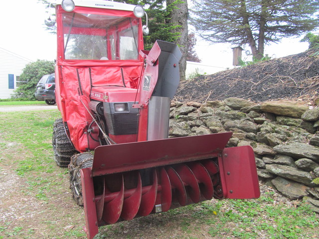

Ed Kennell 47,612 #2 Posted November 5, 2015 On my single stage tall chute blower, I put a smaller pulley on the blower to increase the auger RPM and installed a rubber paddle on the auger to close the gap with the housing.Also find the blower works best when the forward speed is kept fast enough to keep the blower full of snow. 4 Share this post Link to post Share on other sites

DennisThornton 4,773 #7 Posted December 31, 2015 WOT unless there is NO snow in the chute. On different than yours blower I added rubber wipers to the impeller blades so it now has near "0" clearance and WHAT a difference that made! Cold light and fluffy is seldom an issue with any blower but slush is just awfull! I have a 35hp pushing a 74" 2 stage and I have a time or two just given up. Haven't installed the rubber wipers on it yet so maybe I should move that task up the list. Share this post Link to post Share on other sites

wallfish 20,686 #12 Posted December 12, 2016 You're going to slow. IMO the answer is in Ed's first reply to this thread, keep the forward speed of the tractor fast enough to load the blower. Best performance seems to be just as the engine begins to strain and you hear the governor kick in. Single stages work best loaded with snow. Don't start out slow and speed up, get right into it from the start because once that chute clogs, it tends to stay clogged. Get out there and test speeding up. After a little while you should get used to what speed for what snow conditions then you'll be throwing 20 - 30 ft consistently 4 Share this post Link to post Share on other sites
Ed Kennell 47,612 #13 Posted December 12, 2016 Exactly John. And this is why I will only use hydros for blowing snow. The blower always turns at max RPM, and the forward speed is adjusted to keep the blower full of snow. 2 Share this post Link to post Share on other sites
