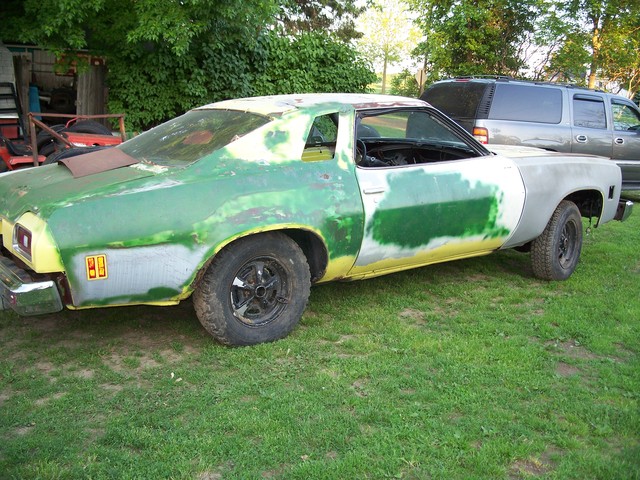

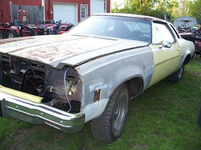

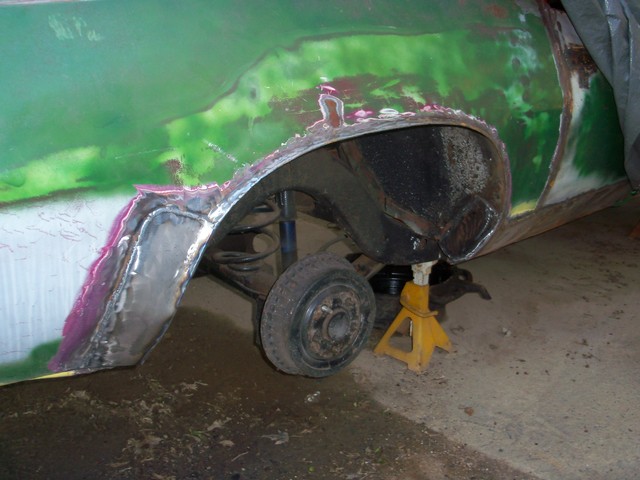

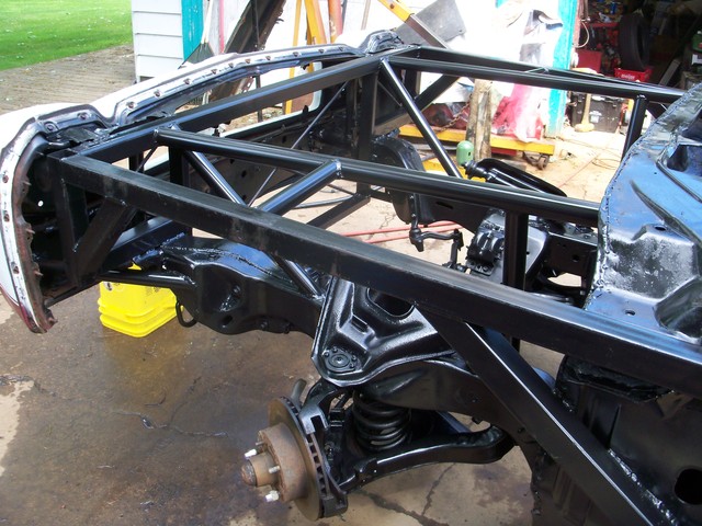

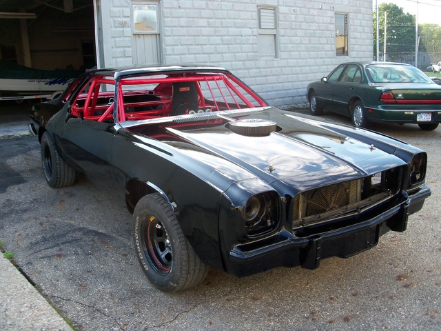

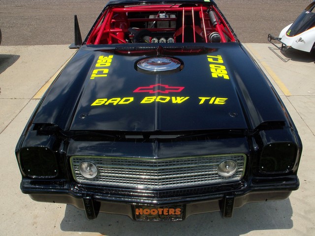

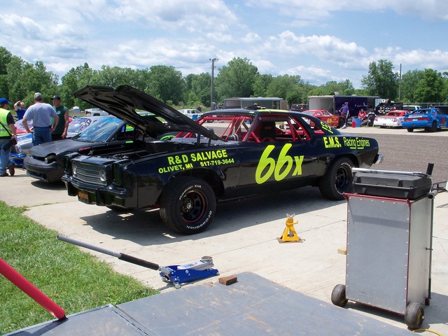

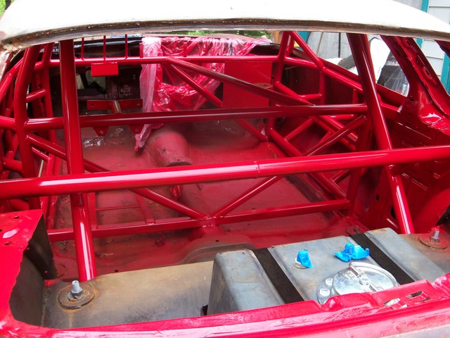

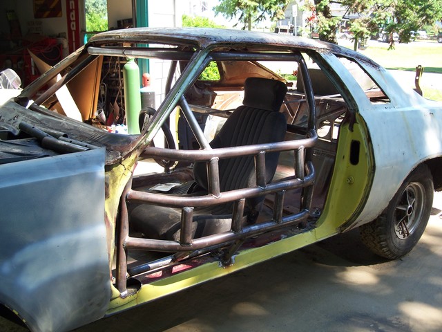

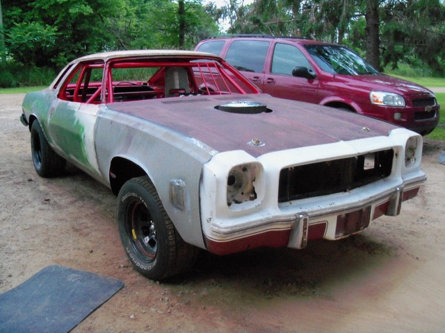

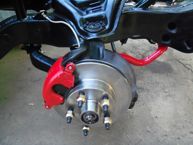

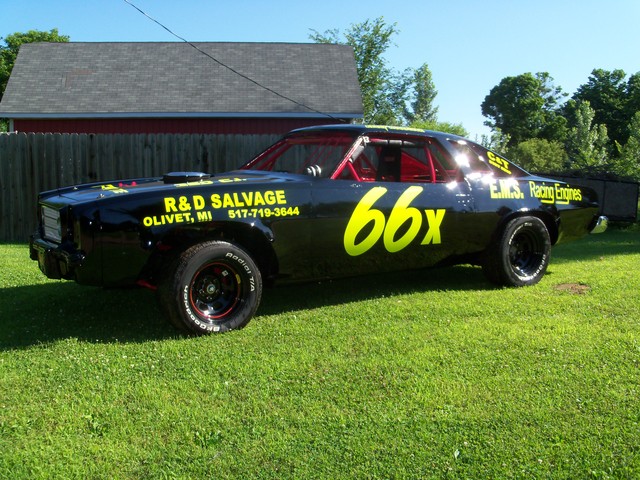

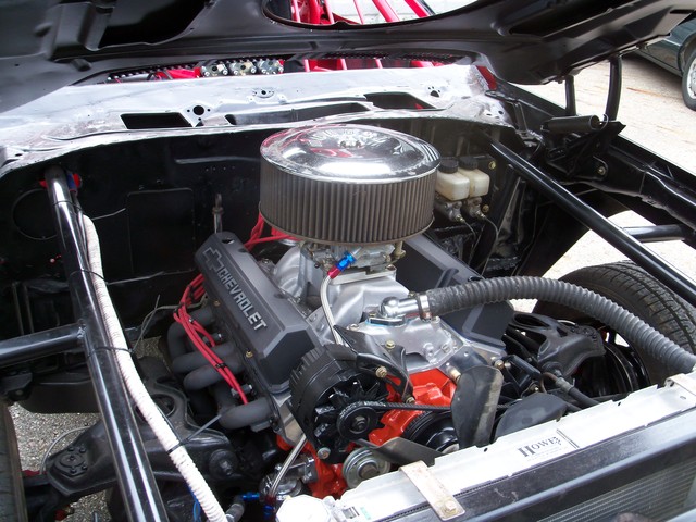

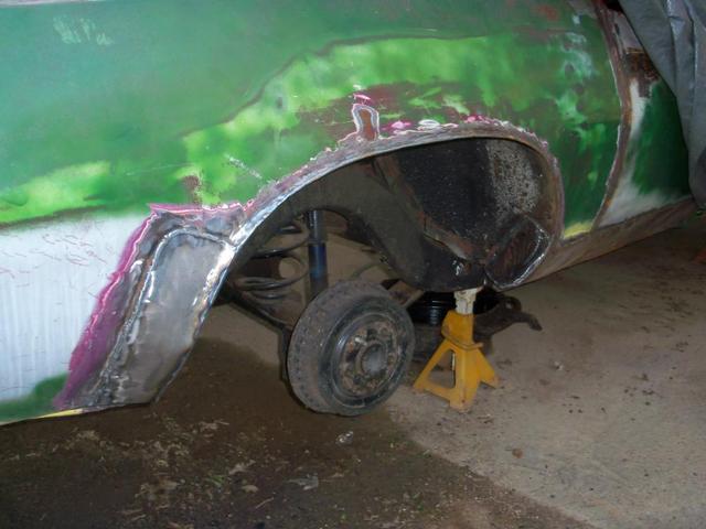

Kelly 1,038 #1 Posted November 1, 2015 Well I was not on here much this year because of two things my son starting his racing career, and me building myself a new race car, you can read about Ryans part in the other what I did all summer post, this will be a very small look and my car build I did this spring. Well I've been racing cars since I was 16 and I just turned 49 so easy to say a Long time, but this was hands down the best car I ever built, LOTS of hours went in to this, I did every thing but the machine work on the engine and building the trans, I touched every bolt on this car removed and most of them replaced, Ryan helped on this build also, he welded the new floors in, and lots of other stuff. I started with a rusty 1974 Chevelle I replaced the floors, the roof, and reshaped the wheel openings along with many patch panels for rust, I welded the cage in after making it fit this car I bought it in pieces like a jig saw puzzle but was for a different body (yes cage is WH red), I added lots of bars also for safety as I race figure 8's, every seem in the body was welded for strength, I have near 50lbs of welding wire in putting this car together, and untold hours welding, hours up on hours of figuring out how I wanted stuff, trying to think 10 steps ahead, while doing the body I was also building the new engine. I sent the engine block out for machine work but I hand assembled it, with ARP studs, alum race heads 13 to 1 high dome pistons a very lumpy camshaft, MSD ing. and lots more, no dyno time but estimated at around 500 HP and drinks 110 octane fuel with ease, @ $7 a gal. and takes 6 gall. most nights not cheap, but OOOOHHHH so fun to drive. I put all new brakes and suspension in it along with a disk brake rearend from a 90's cop car, with aftermarket axles a posi with 3.73 gears, huge sway bars upgraded everything, I cut no corners I built the best I could afford. Trans was built by a local shop to my specs, it's a TH 350after assembling the car and welding all the body panels on, again every seem welded fully, every light hole, door handle hole ect... was welded shut, I took it to work and painted it, the cage was done at home just the black done at work, a buddy cut the vinyl for it, it turned out pretty good all in all, some things I would do different on the next one, but it runs strong and has held up well this season, with very few new car bugs to work out, this was a very brief look at the build I skipped LOTS of details I just hit and missed the big stuff. I was defending Champion in my class from last year, but in building this car I missed a key night in the points race and finished second for the season, but took home a few thropeys and the crowed loved the new car, I have been for years a fan favorite because I drive hard and pull no punches, the figure 8's can be very dangerous and very exhilarating at the same time. Any questions on the car just ask. 12 Share this post Link to post Share on other sites
Sparky-(Admin) 25,593 #2 Posted November 1, 2015 Its great to hear from ya Kelly!! Now about that car....its awesome! Spending time with your kid makes it that much better. Love the front plate, were they a sponsor ?Mike............ 1 Share this post Link to post Share on other sites
Coadster32 793 #3 Posted November 2, 2015 Way cool!! Like the Part 1 as well. 1 Share this post Link to post Share on other sites
953 nut 66,697 #4 Posted November 2, 2015 You and your son both have great looking race cars, Next season is only a few moths off. 1 Share this post Link to post Share on other sites
Ken B 3,203 #5 Posted November 3, 2015 What a beautiful car Kelly! How bad is she banged up now? 1 Share this post Link to post Share on other sites
Kelly 1,038 #6 Posted November 3, 2015 Not as pretty now as in the pics, being the Champion last year and a pretty new car I had a target on me, I'll see if I have any current pics later. Share this post Link to post Share on other sites
