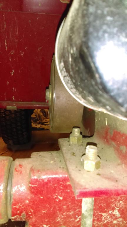

Navig8r 132 #16 Posted December 16, 2017 Any good solution ever found for this? I have a 416, and just put my chains on for the first time... EXACT SAME PROBLEM! Keep hitting the brake bands I was thinking a 1/4" wheel spacer and longer lug bolts, but not sure what other problems that may bring. I do not want to modify wheels or machine. Share this post Link to post Share on other sites

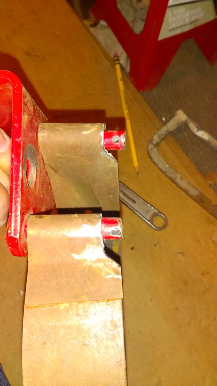

Jerry77 1,218 #17 Posted December 16, 2017 48 minutes ago, Navig8r said: Any good solution ever found for this Just saw this old thread...I had the same problem on my 516h- the two studs that hold the band on were getting hit by the chain..they were extra long and didn't need to be, so I cut part of them off and shaved off some of the band....gave me plenty of clearance and everything works as it should...just my 1 Share this post Link to post Share on other sites
Navig8r 132 #18 Posted December 27, 2017 On 12/16/2017 at 3:59 PM, Jerry77 said: Just saw this old thread...I had the same problem on my 516h- the two studs that hold the band on were getting hit by the chain..they were extra long and didn't need to be, so I cut part of them off and shaved off some of the band....gave me plenty of clearance and everything works as it should...just my Thanks! Exactly what I did, and it works great! 1 Share this post Link to post Share on other sites
