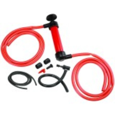

dbartlett1958 99 #13 Posted February 13, 2013 Gene, I can't think of a good reason not to if you are using it in the snow at all. What I used was a chap transfer pump with one end in a bucket of windshield wash, and the other pushed on over the valve stem, after removing the valve core. I got about 5.5 gallons in each of my 23 X 8.5 ag tires. 3 Share this post Link to post Share on other sites

Whmaverick 54 #15 Posted March 10, 2013 Don't know the napa part number but I know tractor supply has valve filler adapters in the tire repair section. I use a drill mounted pump from lowes and a couple garden hose fittings reduced down to 3/8" tubing, and four ft of clear 3/8" tubing. Just remove the valve core, lay the tire against something so it is past 45 degrees connect the valve filler adapter to the valve, connect 2' of hose to the adapter and the pump, connect the other 2' of hose to the other end of the pump, then just put the open end of hose in a gallon of washer fluid and run the drill pump in the correct direction at full speed until the jug is empty. Let the tire burp until no more bubbles come back through the pump and hoses, then pump in the next gallon. I get 6 gallons in each 23 x 8.50 x 12" tire. Allow 3 min per gallon with burping time, I think an hour total start to finish. Best spent hour and about $25 except for that time in Tijuana. Oh just kidding. LOL Share this post Link to post Share on other sites
