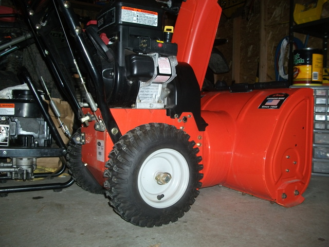

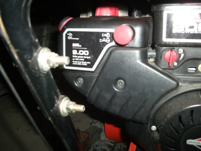

Sparky-(Admin) 26,272 #1 Posted October 21, 2015 Picked a new (used 2009) Ariens snow-blower this past weekend with a Briggs motor. Can anyone tell me what the HP is? Or what the formula is to calculate it? Says 205CC and 9.00Ft pounds of gross torque.Thanks!Mike........... Share this post Link to post Share on other sites

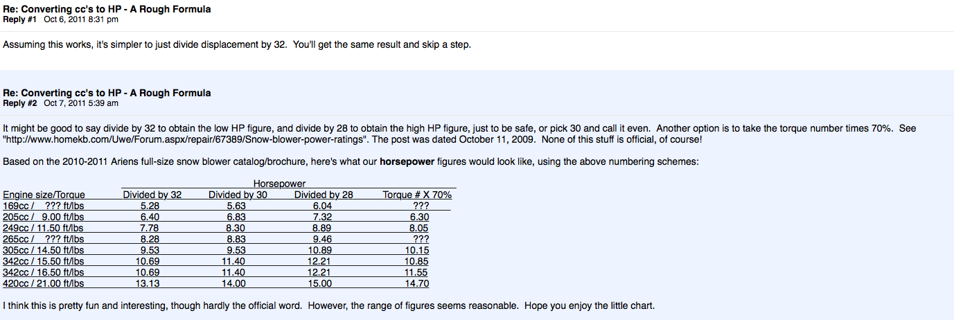

WNYPCRepair 1,924 #4 Posted October 21, 2015 According to this site, 6.3 http://www3.telus.net/shebang/engine_cc_to_hp_calculator.html 1 HP = 32.5 CCs Tork x 70% gives the same, 6.3.9 * .7 = 6.3 Share this post Link to post Share on other sites
Sparky-(Admin) 26,272 #5 Posted October 21, 2015 Oh brother....I'm not to happy to hear its that low.I'm hoping it moves snow and doesn't quit when the going gets tough!Mike....... Share this post Link to post Share on other sites
WNYPCRepair 1,924 #6 Posted October 21, 2015 http://www.abbysguide.com/ope/discussions/59569-0-1.html A better explanation, maybe: http://www.abbysguide.com/ope/discussions/33671-0-1.html Share this post Link to post Share on other sites
Ed Kennell 47,186 #7 Posted October 21, 2015 Sorry Mike, I was not converting cc to cu in correctly. I was using the Kohler engine spec displacement info which averages out to 2.3 cu in /1 HP. in the 4-7 HP range.Using this method, your 205 cc /2.54^3/ cu in =12.51 cu in 12.51cu I n /2.3 cu in/ 1HP = 5.44 HP This of course is assuming the Kohler HP ratings are accurate.Not sure which method is more accurate, but using Brians 32.5cc =1HP, a 10 HP K241 with 23.85 cu in or 390.8 cc displacement equates to 12 HP not 10.Bottom line....5.5 to 6.5 HP would be close. Share this post Link to post Share on other sites
WNYPCRepair 1,924 #8 Posted October 21, 2015 Sorry Mike, I was not converting cc to cu in correctly. I was using the Kohler engine spec displacement info which averages out to 2.3 cu in /1 HP. in the 4-7 HP range.Using this method, your 205 cc /2.54^3/ cu in =12.51 cu in 12.51cu I n /2.3 cu in/ 1HP = 5.44 HP This of course is assuming the Kohler HP ratings are accurate.Not sure which method is more accurate, but using Brians 32.5cc =1HP, a 10 HP K241 with 23.85 cu in or 390.8 cc displacement equates to 12 HP not 10.Bottom line....5.5 to 6.5 HP would be close. The formulas I posted work on the engines at Harbor freight and some Kohlers, but not on my Onan. I found this, which may help explain it: http://www.justanswer.com/small-engine/2thx1-considering-ariens-snowblower-205-cc-biggs.html#re.v/149/ Even better: http://movingsnow.com/2008/cc-to-torque-to-hp-conversion-update/ Share this post Link to post Share on other sites
