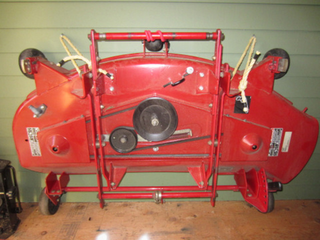

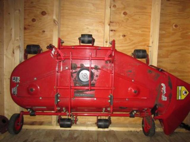

doc724 927 #16 Posted October 20, 2015 Ok, here are two pixThe first one (with the green in the background) is the 48 inch xi deck. If you want to scale the picture, each course of clapboards is about 4 inches. Drive pulley O.D. is 6 3/4 inchThe second pix is the 42 inch classic deck. Studs are 16 inch c-c so you can scale accordingly, Drive pulley O.D. is 4 1/2Note, the rear wheels are fully extended (ie in the lowest mowing position) for the 42 inch deck, but not for the xi deck 1 Share this post Link to post Share on other sites
