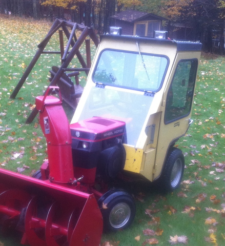

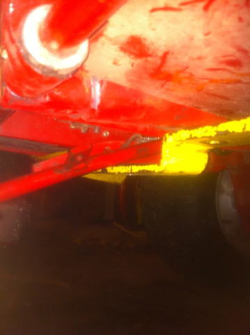

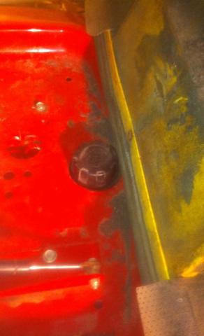

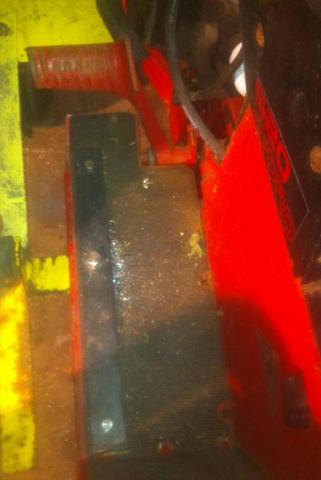

cheesegrader 436 #5 Posted October 20, 2015 I still have a soft-side Wheel Horse cab, but I wasn't completely happy with it.The soft windows cloud up over time, and the vinyl sheeting seems to be wearing out at any point that it wraps around the frame.Vibrating steel is not kind to vinylI looked at a couple of hard cabs, and finally bought a used Cozy Cab.It took a whole summer to modify and mount, but I am thrilled with it so far.THe 520 is a hard beast to fit. You have to keep the gas cap clear to fill, and the seat hangs so far over the back that you end up with limited options to mount to the rear.I have a 2" rear hitch receiver, and I think using that as the basis of the rear mount works best. You might get a little help by resting on the seat pan, but it gets really tight, and you run the risk of blocking access to the fuel cap. Front mounting can be attached under the sheet metal to the frame, but you have to think about where the lift bar for the snowthrower will fit. The frame is so narrow that I had problems with the cab twisting side to side, so I ultimately reinforced the footrests, and moved my front mounts as wide onto the footrests as I could. 5 Share this post Link to post Share on other sites

boovuc 1,090 #8 Posted October 21, 2015 Jeez Cheese! I like that. Painted red and that is a nice setup you have! 1 Share this post Link to post Share on other sites
cheesegrader 436 #9 Posted October 21, 2015 There isn't a model number on the cab. It is from a JD 20 HP garden tractor that was about 30 years old.Most of the 20-23 HP garden tractor cabs that I looked at could have been modified to fit the 520.It shouldn't be a tight fit--you need the air to cool the cab.Don't block the air intake for the engine, and be prepared to cut your own lexan to fit around the hood.The rest is just trial and error to get the mounts on without interfering with anything.You gotta love shopping in junkyards! Share this post Link to post Share on other sites

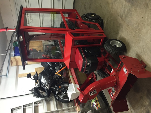

Bosco 32 #13 Posted November 19, 2015 This is how my cab ended up 7 Share this post Link to post Share on other sites
JERSEYHAWG / Glenn 4,590 #14 Posted November 19, 2015 Bosco, dam nice job on that. A+glenn Share this post Link to post Share on other sites

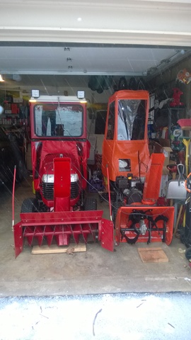

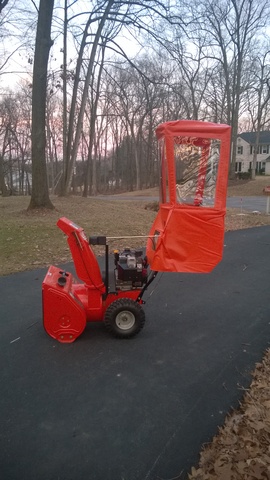

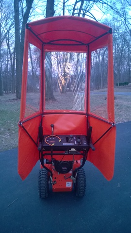

shallowwatersailor 3,222 #15 Posted November 19, 2015 The old windbreak cabs that were used on tractors in the '50s may be an idea. Most walk-behind cabs may not be wide enough. Here is OTC cab on my Ariens 924DLE, and next to the 523Dxi. 3 Share this post Link to post Share on other sites

cheesegrader 436 #19 Posted November 20, 2015 Bosco,That is nice. The lower windows are really a nice touch. Being able to see the front tires is usefull when you are slipping around.If I was making my own, I would add as much window space as possible. Share this post Link to post Share on other sites
