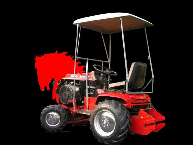

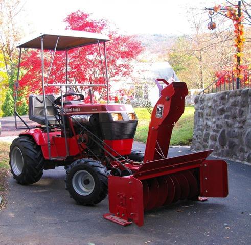

shallowwatersailor 3,221 #12 Posted January 1, 2014 In the side view, it looks like you have the front of the cab sweeping back. The lift handle might interfere once you drop the blade. I think that the Original Cab Co. (Wheel Horse supplier) has a straight front. 1 Share this post Link to post Share on other sites
AMC RULES 37,259 #13 Posted January 1, 2014 (edited) Original Cab framework shown here for reference. Edited January 1, 2014 by AMC RULES 1 Share this post Link to post Share on other sites
