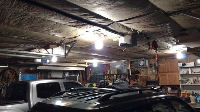

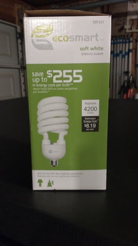

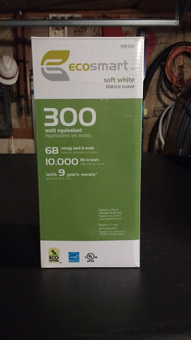

rmaynard 17,618 #3 Posted October 5, 2015 (edited) Although I hate the CFL's (compact fluorescent) in my house, I needed a quick way to boost the lighting in my garage. When I built it back in 1988, I just put in ceramic screw-in type fixtures and standard bulbs. So I went to Homer Depot and picked up four of these.After a few minutes of warm up time, they really light the area. PROS: Lot's of light; reasonably inexpensive ($13.00 ea.); easy and quick to install.CONS: Environmentally hazardous if they break; take a while to get up to full brightness; easily broken because of the way they hang out in the open; but the biggest of all, as usual, Home Depot has discontinued them. Edited October 5, 2015 by rmaynard 3 Share this post Link to post Share on other sites
GlenPettit 1,719 #4 Posted October 5, 2015 Is there was anything you could do to lighten up that ceiling. Reflective light can sure make a big improvement.Spray painting it White would easily double the amount of light you would have in there, paint is a lot less than any kind of ceiling material would be. 1 Share this post Link to post Share on other sites
rmaynard 17,618 #5 Posted October 5, 2015 I will eventually drywall the ceiling when the budget allows. Share this post Link to post Share on other sites

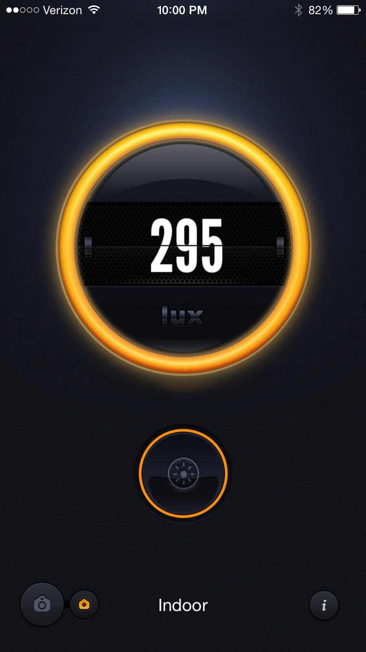

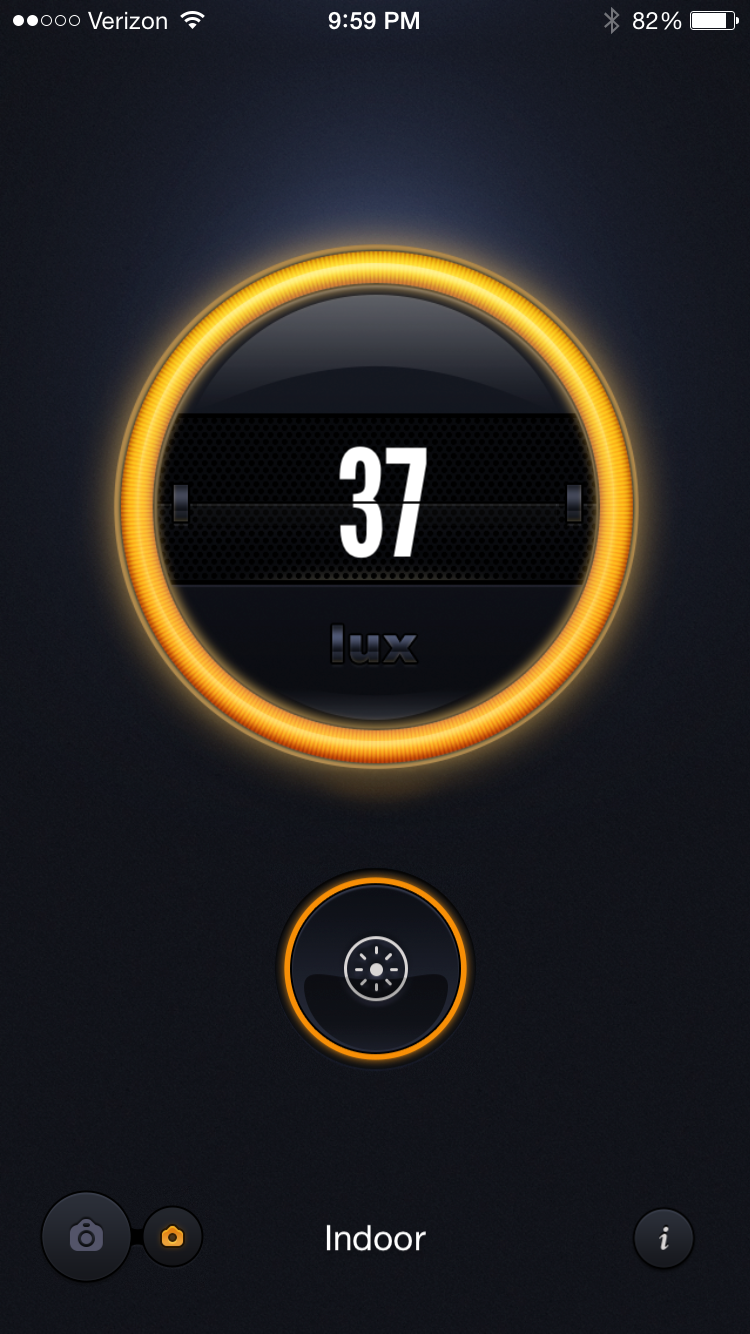

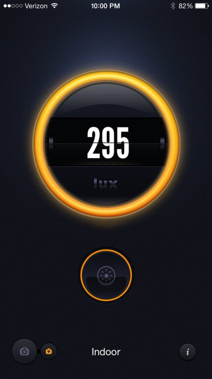

WNYPCRepair 1,924 #9 Posted October 6, 2015 Downloaded a light meter app for the phone. First pic is two 12w LED bulbs (1000 Lux, 110W replacement, each) at 37 lux. Remember they are 11 feet or so in the air. Second pic is with the added fluorescent strip, 4 T5HO bulbs at 295 lux. So, 8 times the amount of light? 2 Share this post Link to post Share on other sites

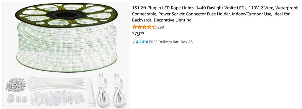

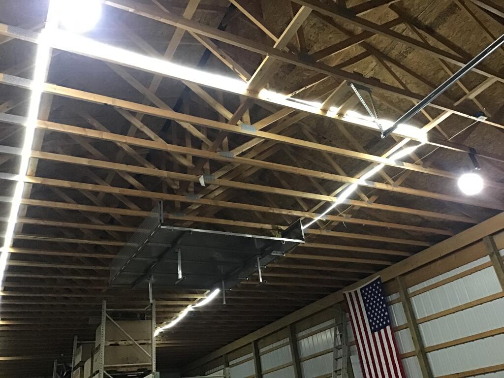

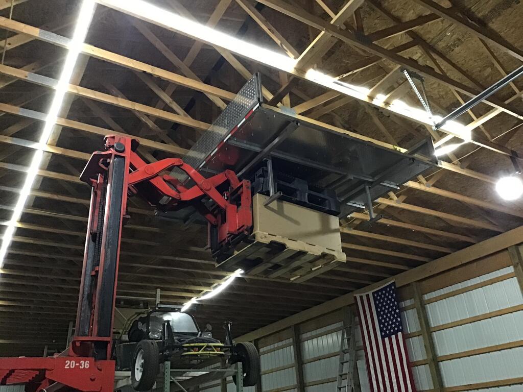

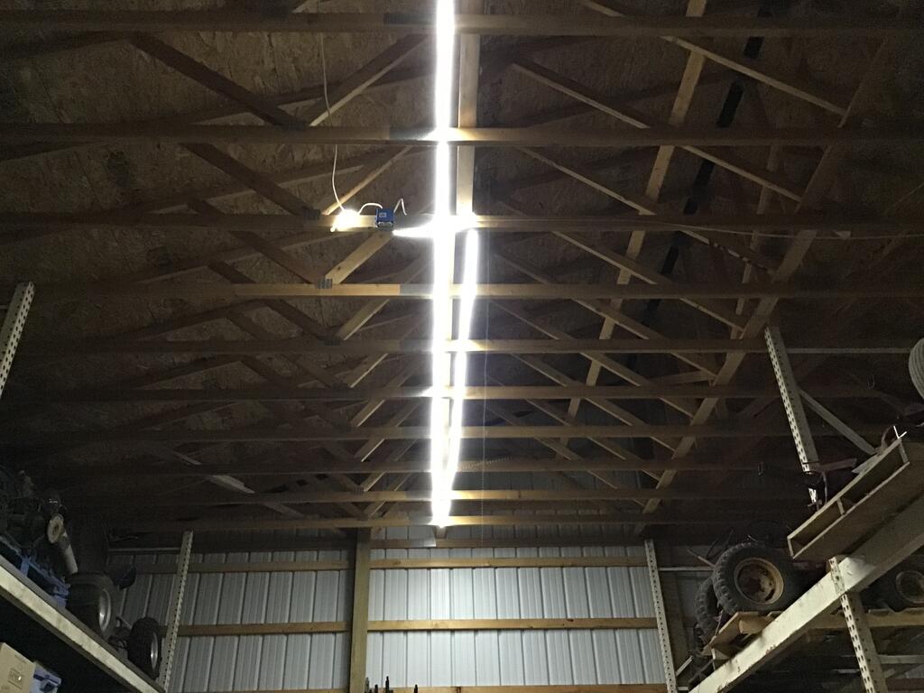

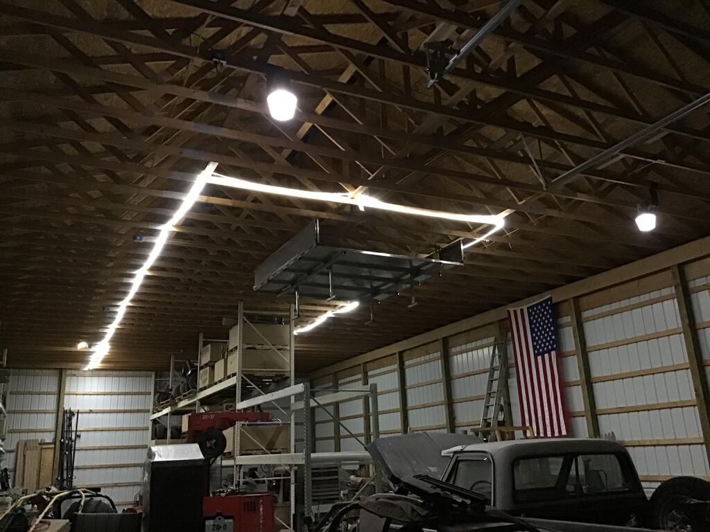

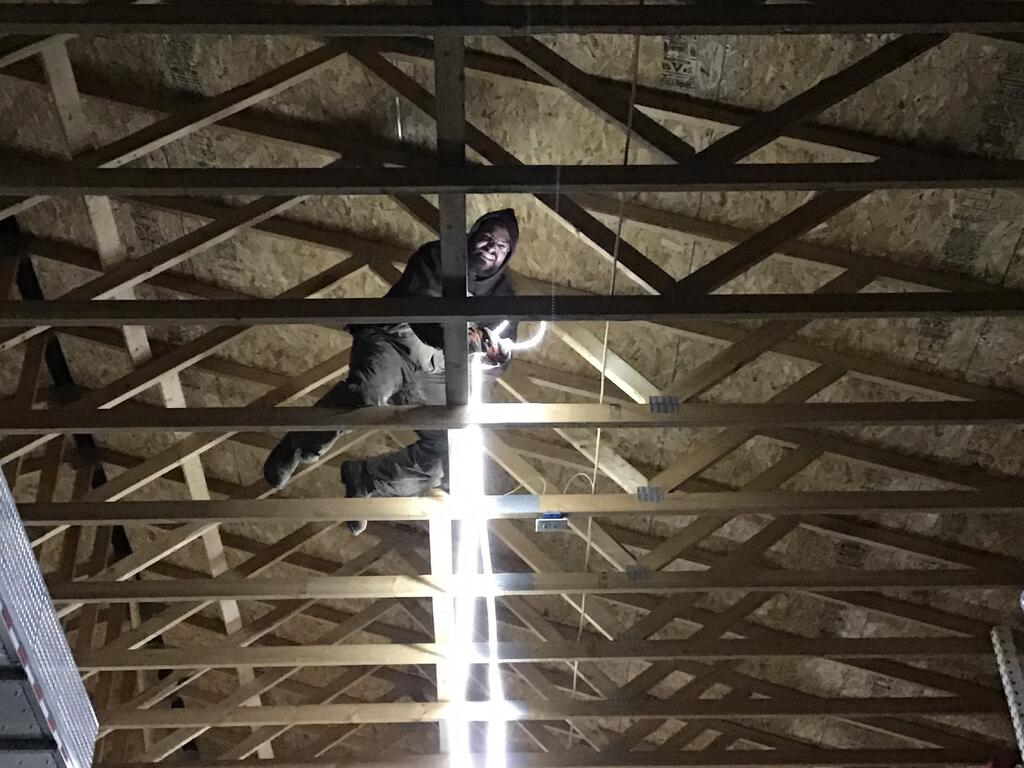

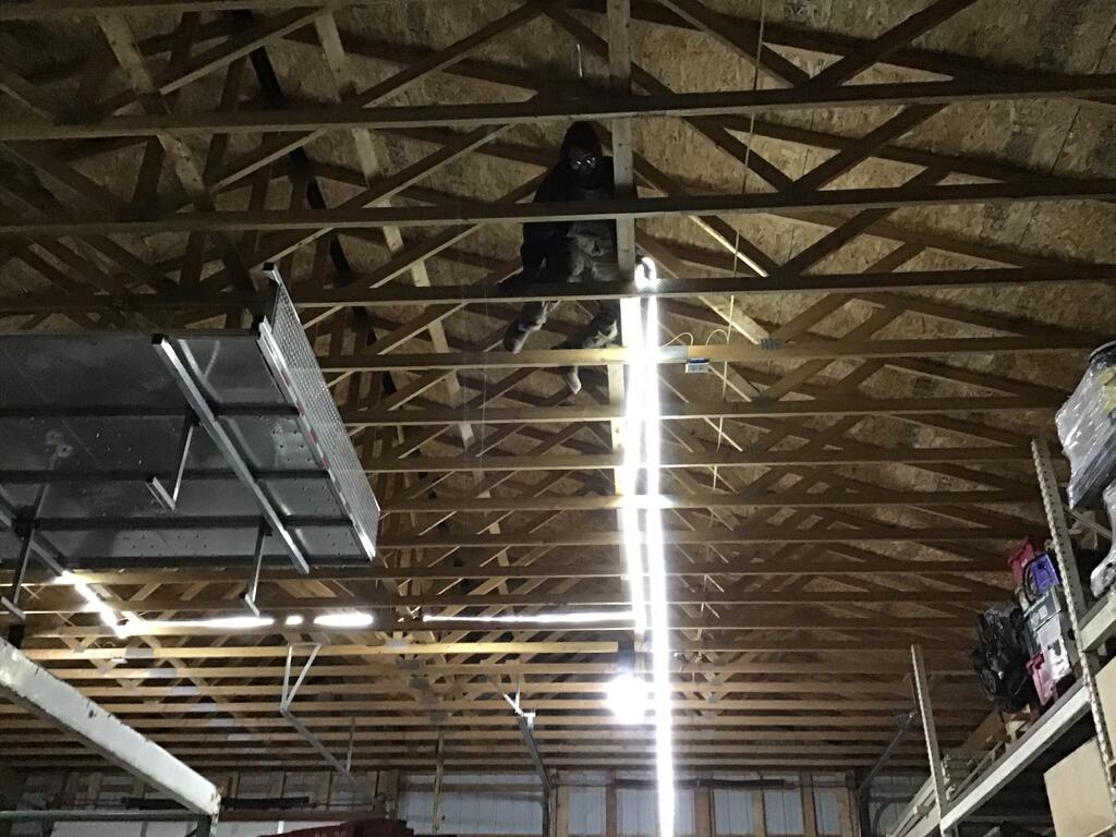

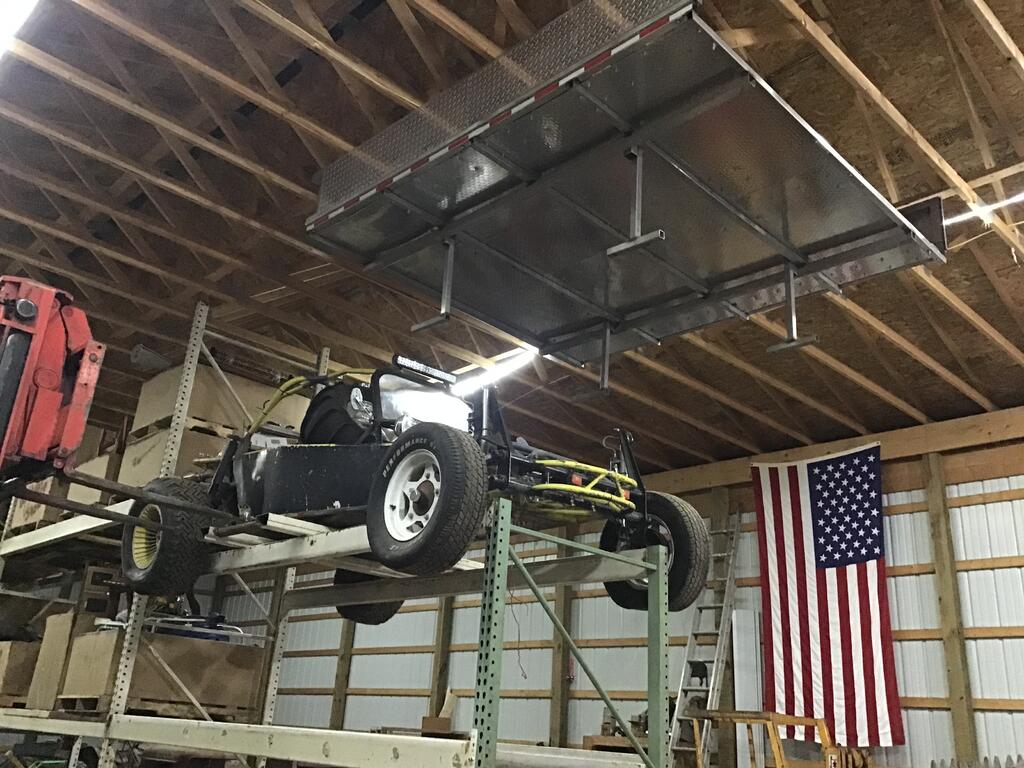

Pullstart 71,467 #11 Posted November 25, 2020 I had to restring some lighting in the back barn to relocate racking and Norman’s deck... This stuff is amazing! It also has plastic clips and screws in the package to attach to a finished ceiling. I don’t know how to find a link to the Amazon item using the app, but I’ll include a picture. For the amount of light from these, I say this is a better deal than fixtures for lighting massive amounts of space! Share this post Link to post Share on other sites
Pullstart 71,467 #12 Posted November 25, 2020 Here are some before, during and after pics. 2 Share this post Link to post Share on other sites
