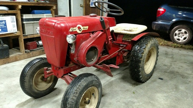

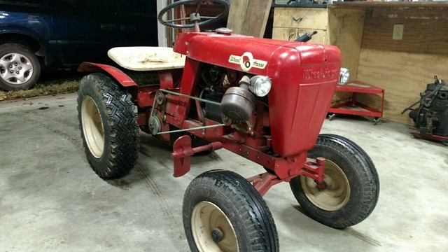

Wheel-N-It 2,978 #1 Posted October 4, 2015 (edited) this is an edit KEEP SCROLLING DOWN / PICS ARE POSTED BY JRBLANKE this is an editWell after a couple of years keeping my eye open for a locally owned Round Hood, I finally found one today located about a 40 minute drive from home. I'm hoping James can post some pics of this thing for me as Karl and I still cannot figure out what happened when Red Square had a change this past Summer.Anyway, It looks good and runs quite well in my opinion. It has a slot hitch that works! Tomorrow it will get an oil change.It has a starter/generator Kohler engine and the serial number tag on the tractor shows the number #48441Can someone tell me what this is based on the serial number. Craig AMC rules says its a 701 because it has the double pullys on the engine and starter. I believe Craig is correct on that due to his vast knowledge of Wheel Horses that far surpasses mine. I would like to know what information the serial number is giving me. Thank you. Hopefully I can get some pics of the tractor on here somehow.Oh, and it also came with a snow blade that I will sell if any of you need it. Edited October 4, 2015 by Wheel-N-It 9 Share this post Link to post Share on other sites

Jrblanke 976 #4 Posted October 4, 2015 (edited) BAM here's the pic. Nice pickup Van! I'd say you did well! Edited October 4, 2015 by Jrblanke 10 Share this post Link to post Share on other sites

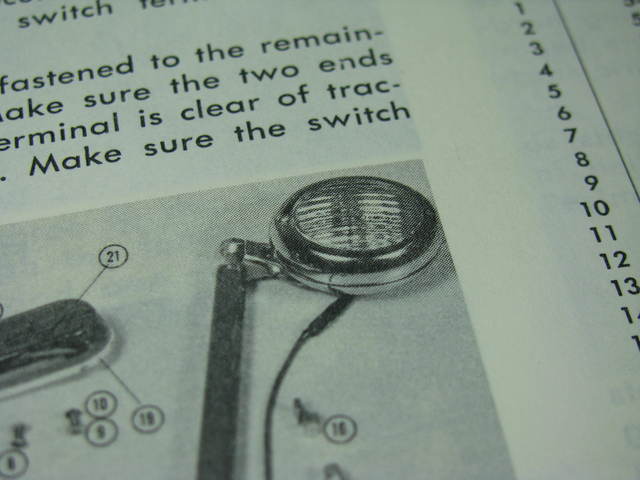

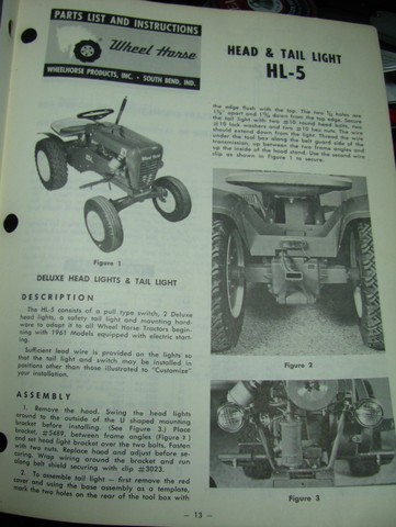

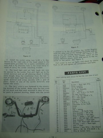

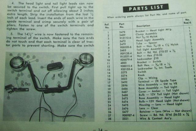

AMC RULES 37,261 #17 Posted October 4, 2015 (edited) As per our discussion, the following is for your reference Van. Edited October 4, 2015 by AMC RULES 1 Share this post Link to post Share on other sites

Wheel-N-It 2,978 #19 Posted October 4, 2015 (edited) "Every good tractor got a bullet hole in the hood" "Thats Right" LOL Thank you everyone who supported me with your Red Square Member Seal of ApprovalNow I have a few questions; 1. Where can I get one of those headlight mounting bars? I am thinking I've read somewhere here on RS of these things being available (maybe reproduction) ? I like the look as it reminds me of the ape hanger handlebars on my Harley Davidson motorcycle (BIG THANK YOU to my Wheel Horse Hero AMC RULES ! 2. Bert has graciously offered me a drive belt guard from a WH 552. Will the 552 belt guard fit a 701? If so that is perfect as I will be seeing Bert the last weekend of this month at our Western North Carolina Meet and Greet. BTW, you guys are certainly invited to attend. We have a thread for this in the General Shows and Events Section. Or PM me with your phone number and I will call you to give you information regarding our meet. 3.. What weight of transmission gear oil should I use? How much does the transmission hold? Where do I put in in? 4. What is the correct part number for the drive belt that connects the engine pully to the transmission? I want to replace the belt on it now with a new one so I can properly adjust the clutch/brake pedal.Thank you for any help you can give me. I want to bring this 701 to the 2016 Big Show Edited October 4, 2015 by Wheel-N-It 2 Share this post Link to post Share on other sites
