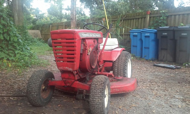

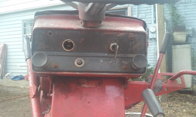

stevecobb76 19 #1 Posted October 2, 2015 $200 craigslist find.1277 beast.should I keep it for my lawn serviceorshould I trade it for newer mower? better yet, should I keep it and restore it?orshould I seill/trade it off? 6 Share this post Link to post Share on other sites
AMC RULES 37,259 #2 Posted October 2, 2015 No brainer... keep that beast. Share this post Link to post Share on other sites
Sparky-(Admin) 26,280 #3 Posted October 2, 2015 I personally wouldn't want to depend or trust a 47 year old machine to a lawn service....its probably worked all its life and deserves a "light duty" retirement. I would rather have a newer machine to depend on to help me make a paycheck.That being said, your new find is a great machine to restore or tinker on and have some fun with. Keep it as a backup incase your daily tractor craps out? Maybe haul it to tractor/machinery shows to putt around on or display?Mike........ 2 Share this post Link to post Share on other sites
stevecobb76 19 #4 Posted October 2, 2015 (edited) I just found the wheel horse club and shows they put on. I see that this could look nice if I put about a month of work into it.what kind of price would I be looking at for it??as is running, and mowing price?restored price?I have no idea the valueI just paid $200 for it because I know that any riding mower that runs and cuts is worth at least that much around where I live.and better yet. this isn't a mower, it is a tractor w/ a mower attachment. So I know it has the be worth more than that right?I see some for $500 to $1000 online that look worse than mine. Edited October 2, 2015 by stevecobb76 Share this post Link to post Share on other sites
953 nut 69,033 #5 Posted October 2, 2015 Great buy, you will have to look pretty hard and pay ten times as much to find another mower as good as your 48 year new . There isn't anything to be afraid of here, lots of life left in it. Enjoy it and keep it well maintained. Share this post Link to post Share on other sites

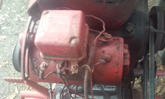

JERSEYHAWG / Glenn 4,589 #6 Posted October 2, 2015 Welcome to red square, BUT DANGER, no belt covers. Be very carefull. Good luck. Maybe you might want to tinker with this one and use something else for your lawn service.Till you bring it up to speed.Glenn 2 Share this post Link to post Share on other sites
stevecobb76 19 #7 Posted October 2, 2015 Welcome to red square, BUT DANGER, no belt covers. Be very carefull. Good luck. Maybe you might want to tinker with this one and use something else for your lawn service.Till you bring it up to speed.Glenn I dont need those fingers anyways..I took the drive belt cover off myself to put the belt back on.there is no alternator cover though.that would be funny as hell to be mowing a yard with this mower and next door a guy with a zero turn...could you imagine the reactions and their thoughts? 2 Share this post Link to post Share on other sites

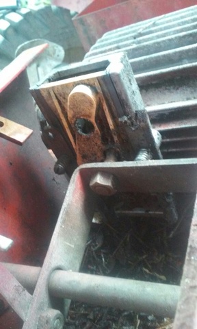

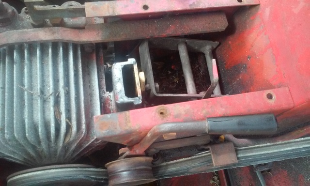

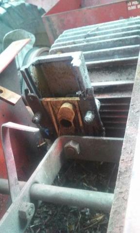

stevecobb76 19 #9 Posted October 2, 2015 here is what I am working on at the minute.there is alot of slop in the foward reverse lever on the right side. the linkage is hooked up to this part on the pump that slides up and down.I am trying to snug it up because it keeps getting faster and faster when I drive it across yard.I snugged up the spring screws on the left and right but that didn't help.still sloppy.. what can I do about that? (Now don't get me wrong, there is profit to be made if you play everything right, but its decent work and often means selling for parts. Which is hard if you dont know these horses really well) I agree. do it right the first time. or just dont bother.I have to say, the more that I think about it, I wouldn't mind being "one of those guys" at the tractor shows.one of those guys with a really cool tractor. 1 Share this post Link to post Share on other sites

Retired Wrencher 6,968 #13 Posted October 4, 2015 stevecobb76 I would not mess with the tranny to much if works leave it alone. They can be very tricky to adjust. Change the belt get a wheel horse belt. Do not buy after market belts [my experience is] there to long or to short spend the $30 to $40 on a real belt they are made to fit.Look in the manual section to find #`s. clean every thing up lube it all up and enjoy it.She is a nice tractor. Just use some marvel to bring out color.Enjoy the ride. Gary. 1 Share this post Link to post Share on other sites
boovuc 1,090 #14 Posted October 4, 2015 Nice old hydro! Gary is correct. Leave a sleeping dog ALONE. Those are original Hydros and parts and expertise are getting harder to find for them. Change out the fluids with what was in it. Filters, etc on the tranny and let it alone. Use TORO belts or in a pinch, NAPA Kevlar belts. Just like old men, those old hydros get crotchety when you mess with them! 1 Share this post Link to post Share on other sites

wfrpalm 218 #16 Posted October 4, 2015 I have a 857 and I was having the same problem with speed control so this is what I did. I cut two 1/8" sections out of a bicycle inner tube ( they look like rubber bands ) and stretched them over the two shoes that rub against the nylon block that moves with the lever ( your picture shows them ) then adjusted the screws until they were barely tight and the speed is controllable now. I do not use the tractor everyday but this fix has held up so far. Share this post Link to post Share on other sites
stevecobb76 19 #17 Posted October 7, 2015 I have a 857 and I was having the same problem with speed control so this is what I did. I cut two 1/8" sections out of a bicycle inner tube ( they look like rubber bands ) and stretched them over the two shoes that rub against the nylon block that moves with the lever ( your picture shows them ) then adjusted the screws until they were barely tight and the speed is controllable now. I do not use the tractor everyday but this fix has held up so far. can you upload a picture of this for me?I have not found solution yet.I got new belts and it is running like a raped ape.. Share this post Link to post Share on other sites
