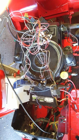

pic_5.thumb.jpg.476f467d94e7a68ce2290657pic_4.thumb.jpg.0d8aef8b2945a7730c836219I have a toro whreel horse 210-5 and it had a b/s 10 hp engine with a broken valve, so I removed the engine. After removing the engine, I installed an engine from a john deere 160 lawn tractor. The engine is a fb460 kawasaki. I left the wiring attached to the kawasaki engine and installed the kawasaki and wiring on the toro wheel horse.Everything bolted up and fit in ok. But! when I turn the key on. nothing happens. not even a click. I'm sure it is the neutral switch on the toro wheel horse. I took some pictures to explain what I am talking about. I need to know if someone out there knows how to wire up the purple wire and the yellow wire from the neutral swiitch, to the new power takeoff and relay. I put the old wiring from the toro wheel horse and laid it on the top of the kawasaki motor and tied the purple wire and yellow wire to the original way it was on the old wiring so you would know where they went on the pto and relay switch. the new installed pto has different colored wiring which confuses me. And there is no relay switch on the new wiring that is installed. Edited by jerbear
What is the 210-5 tractor model number and serial number?
Here is a Kawasaki model number FB460V-KS08. What is yours?

Thank you very much for answering my lawn tractor dilema. The Kawasaki modlel number. I can't locate where it is on the engine. I found these numbers on the motor.
Serial: FB460-198885 and Code: FB460V-CS00  The Toro Wheel horse model; 32-10B503  The Serial; 200047 . Again, Thanks Garry
Here is the original tractor wiring diagram
http://www.wheelhorseforum.com/files/file/2901-tractor-1992-210-5-210-h-wiring-detailed-492-4509pdf/
This file has a wiring diagram for a model that uses a Kawasaki FB460V-CS26. This is as close as I can guess
http://www.wheelhorseforum.com/files/file/2702-tractor-1991-212-5-01-kawasaki-da-ipl-wiring-snpdf/
Another
http://www.wheelhorseforum.com/files/file/2701-tractor-1991-212-h-02-kawasaki-da-ipl-wiring-snpdf/
1989 model A2-12KE01 also used the FB460V-CS26 but can not find a wiring diagram.
Hope there is something in these that help.
Here is the Kawasaki engine service manual
http://www.wheelhorseforum.com/files/file/3687-engine-kawasaki-fb460v-sm-492-4209pdf/
