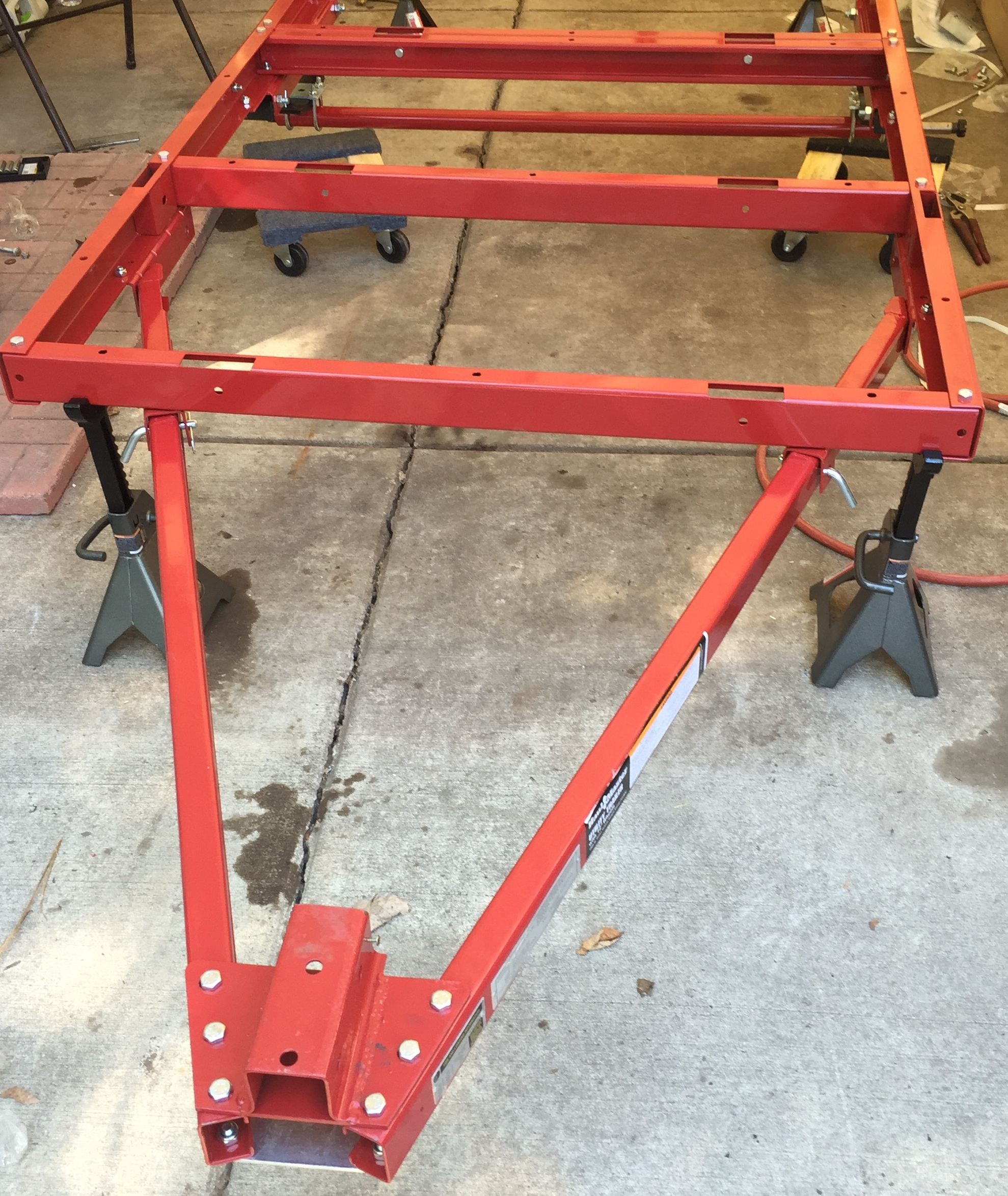

WNYPCRepair 1,924 #1 Posted September 22, 2015 The first attempt happened just as the forum crashed for a minute. Admins can delete it, hopefully. I got tired of renting trailers, so I finally broke down and got one of the Harbor Freight DIY trailers. Turns out they will take the 20% off coupon on it. I was surprised, they won't take it for most expensive stuffIt's coming along nicely. I also bought a welder and found out I suck at it as bad as I did in school. 10 Share this post Link to post Share on other sites

Aldon 4,832 #4 Posted September 22, 2015 Not much that can fail in it. Clean and pack wheel bearings and should be pretty much good to go. 2 Share this post Link to post Share on other sites
WNYPCRepair 1,924 #5 Posted September 22, 2015 Not much that can fail in it. Clean and pack wheel bearings and should be pretty much good to go. Doing that tomorrow, if I have time. I was wondering how to get the seal out of the inner side of the hub without destroying it. They are packed in some kind of weird grease, looks almost like cosmoline, but wipes off like grease. Share this post Link to post Share on other sites

Digger 66 3,528 #7 Posted September 22, 2015 A buddy of mine had the same trailer .Hauled his Firecat around WNY for what seemed like forever .He beat the snot out of that poor thing with everything from wood , concrete , you name it .It finally crumbled into a pile .It didn't owe him a dime . I would fab up some gussets for the corners & the two green arrows ( where the pins go through ) need to be thicker as well as the hinge point for the tilting. Share this post Link to post Share on other sites
953 nut 66,695 #8 Posted September 22, 2015 Once the trailer is assembled give it another coat of paint, the Chinese paint jobs don't hold up too good. Also, use pressure treated plywood, I have one that has been out in the elements for nearly 20 years and is still good. 1 Share this post Link to post Share on other sites

DennisThornton 4,773 #10 Posted September 22, 2015 That trailer MIGHT be powder coated! I'm not a PC convert! Maybe because of HF! Seems once theirs (I assume most low cost Chinese efforts!) fails it really accelerates! I fear that hitting it with more paint might not help. Don't know, and certainly don't want to tread on 953 nut's comments, just saying you might want to consider something like TC-11. Not widely known and I don't know why. Google a bit and you can decide or we can chat! Share this post Link to post Share on other sites

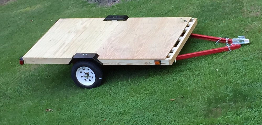

WNYPCRepair 1,924 #16 Posted September 24, 2015 Almost finished. Got to add some temporary side and front racks, until I can weld well enough to make permanent racks.I am sore now, I could never be a mechanic, bending over for hours kills my back 4 Share this post Link to post Share on other sites
elcamino/wheelhorse 9,363 #17 Posted September 24, 2015 That looks great. Nice job. 1 Share this post Link to post Share on other sites
WNYPCRepair 1,924 #18 Posted September 24, 2015 Thanks, I made it 5 x 8. Actually a little over 8. It looked too narrow at 4' Share this post Link to post Share on other sites

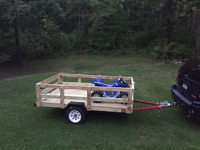

WNYPCRepair 1,924 #19 Posted September 24, 2015 Finally done. Just in time, since I need it tomorrow. 3 Share this post Link to post Share on other sites
elcamino/wheelhorse 9,363 #20 Posted September 25, 2015 very nice work , did you put D rings in floor for securing loads ? Share this post Link to post Share on other sites
WNYPCRepair 1,924 #21 Posted September 25, 2015 (edited) very nice work , did you put D rings in floor for securing loads ? yes, 4 very heavy duty ones from HF. They are holding down the toy 4 wheeler. Turned out pretty good considering I designed the floor and racks on the fly. I'm not much of a mechanic but I am a very good carpenter. Edited September 25, 2015 by WNYPCRepair Share this post Link to post Share on other sites

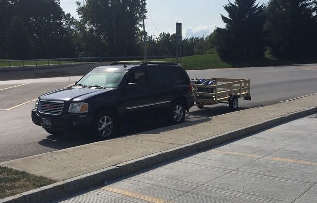

WNYPCRepair 1,924 #24 Posted September 25, 2015 (edited) Well it made it's maiden voyage without the axles melting off so I must have done a good job packing the bearings. Buffalo to Syracuse. Edited September 25, 2015 by WNYPCRepair 5 Share this post Link to post Share on other sites
JPWH 6,544 #25 Posted September 26, 2015 That turned out to be a good looking trailer. Have you tried the tilt bed? Share this post Link to post Share on other sites
