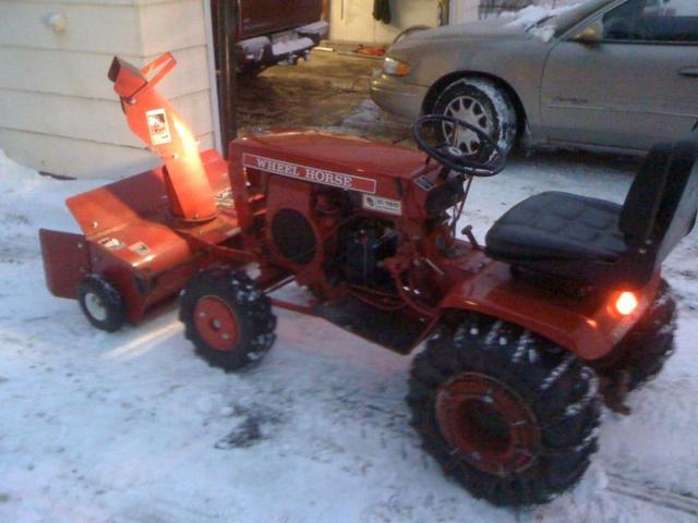

midpack 1,148 #1 Posted September 3, 2015 OK, so I picked up a plow for my C-175 off CL, guy wanted $60 for it . (the guy said "hey you want that old snowblower attachment too?") tch... duh, free? c'mon!anyway, I decided to attach the plow and push some dirt around just for fun . That's when I found out that steering, controlling the height of the blade, and speed of the tractor (forward/reverse) was a challenge to say the least...Of course with the Sundstrand hydro, the available pedal mod is zilch. I thought about looking for a different Horse, but I like this one.so being a machinist, I made this...I took it for a test ride last night and it works great! As it stands, I was using both pedals to control the speed, the brake pedal moves the lever back toward the neutral position to slow the tractor down in either direction. I was looking at using springs for return to neutral, but it was pretty easy to just use the pedals.I think the rear PTO belt should clear too.Total out of pocket cost ~$42.00 for the pedal and Heim links. The rest, well I work in a shop, lolThe only thing I regret is cutting original sheet metal... . there are a few of those belt guards available, so I could grab one just in case 10 Share this post Link to post Share on other sites

midpack 1,148 #3 Posted September 3, 2015 looks like it's from a 269-H. I got it off ebay. I was just looking for something that I could use and it looked right. I did have to bore the ID to fit on my tractors pedal mount. Share this post Link to post Share on other sites

PaulC 342 #7 Posted September 3, 2015 I like this a lot! Especially that pedal. I would think you could add springs to it for the neutral return pretty easily. Although for mowing I do like using the handle and the fact that it will hold position for the longer straight runs.I have one of Matts foot pedal kits on one of my tractors so I know how great it is to have the foot pedal control for snowblowing and plowing. His kits got to pricy for me and now theyre not even available so I may have to try something like this. Good work Share this post Link to post Share on other sites
pacer 3,181 #8 Posted September 3, 2015 Not bad, not bad at all!!I added a pedal on one of my 175's a while back somewhat different from yours but same principle. I'm thinking your mounting the linkage higher up on the shifter handle may make for smoother action - mine is a bit 'stiffer' than I would have liked.http://www.wheelhorseforum.com/topic/51889-another-foot-pedal-mod-c-175-eaton-1100/ Share this post Link to post Share on other sites
546cowboy 302 #9 Posted September 3, 2015 I had a Charger 12 that someone did something like that to. I never liked it but that one was not as nice a job as yours. Buy the way I believe you have an Eaton in that and not a Sundstrand. Share this post Link to post Share on other sites
bmsgaffer 2,071 #10 Posted September 3, 2015 The black hoods could have had either (in 1980 anyway).None of the pictures show enough detail to say either way... Share this post Link to post Share on other sites

pacer 3,181 #12 Posted September 3, 2015 The black hoods could have had either (in 1980 anyway). Yes, I have 2 175's and one is an Eaton and the other Sundstrand. The shifter stick is same on both. Share this post Link to post Share on other sites
midpack 1,148 #13 Posted September 3, 2015 Tag says Sundstrand Share this post Link to post Share on other sites
