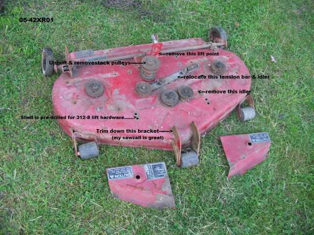

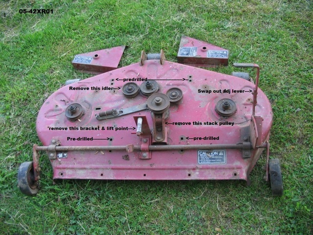

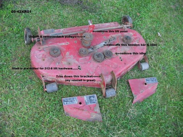

daveoman1966 3,884 #8 Posted August 20, 2015 (edited) the deck shell is the same depth for the 42 rear disch decks...they don't vary from one model to another. Wheelhorse stamped out these deck shells by the THOUSANDS...then added some weld-on hardware for different applications of the same deck shell. You''' find that the spindles are the same too, although the style may change a bit. Given that, it is VERY EASY to convert the 05-42XR deck to a typical 05-42MR. Here are a few pics of just what to do. You MAY not have to trim the front bracket...I did on the several that I've converted for use on a tractor with the conventional horizontal shaft engine.The 2nd set of pics shows the AFTER conversion....(pics from Ebay) Edited August 20, 2015 by daveoman1966 4 Share this post Link to post Share on other sites
DennisThornton 4,773 #9 Posted August 20, 2015 daveoman1966, great post! Very, very helpful!Thanks!And cdsl810, looks worthwhile, especially for a deck that's in first rate shape! Share this post Link to post Share on other sites
cdsl810 181 #10 Posted August 20, 2015 Looks 3 beer--PG language project.I found a donor deck that will provide everything I need to convert this. It even has a good belt on it. I will throw some pics on here when it's all done. 1 Share this post Link to post Share on other sites
varosd 1,185 #11 Posted August 20, 2015 Dave has provided (as usual) great photos with labels!I did the switch on a 42 rear the other year and just picked up a clean 42SD for $30 last month.I brought up the parts viewer for both the vertical and horizontal shaft decks and figured out what parts I could reuse and what ones I had to get. i.e. the main double drive pulley is different, the belt is different etc.I think that as the normal decks rot out despite our best efforts, we will all start scrambling for whatever is available 1 Share this post Link to post Share on other sites

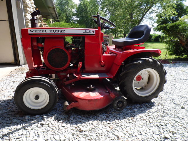

Molon_Labe 731 #13 Posted August 21, 2015 Here's a converted 05-42XR02 on my C-101, great deck. Had to fab a leveling rod for it but no big deal there. The left spindle is from a 95-42MS01 SD deck. 2 Share this post Link to post Share on other sites

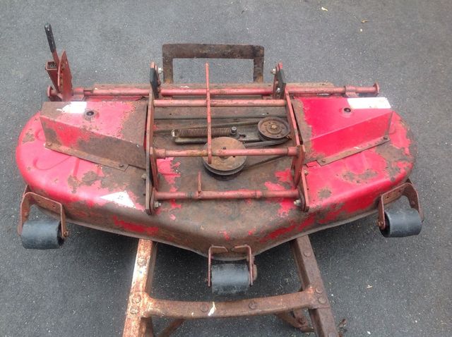

TDF5G 2,074 #21 Posted October 16, 2015 Very informative thread here fellas. I've been looking at pics of 36" decks today, and considering changing the hardware from a rusted out deck shell, B/C series, on to a good vertical shaft deck shell, (not in my possession, but I know where one is available). After studying and comparing the pics of the decks, it looks like a simple matter of just swapping all the parts/hardware over from one deck to the other, as the decks have the square holes for both styles. The only exception may be the front roller welded on mounting bracket. And that's no big problem, if you can cut and weld. Is that all there is to it?Thanks Share this post Link to post Share on other sites
TDF5G 2,074 #22 Posted October 19, 2015 (edited) Ok I'm ready to do a swap over. I found this deck (along with a B115 tractor) on Craigslist, picked 'er up on Saturday. The C series deck pic, I found on google images, but it's identical to my rusted out one! Edited October 19, 2015 by TDF5G Share this post Link to post Share on other sites
