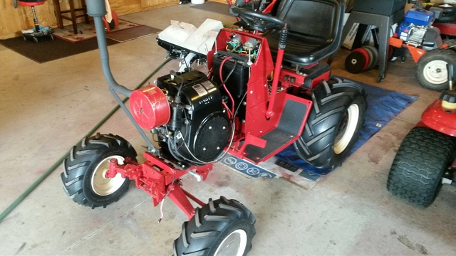

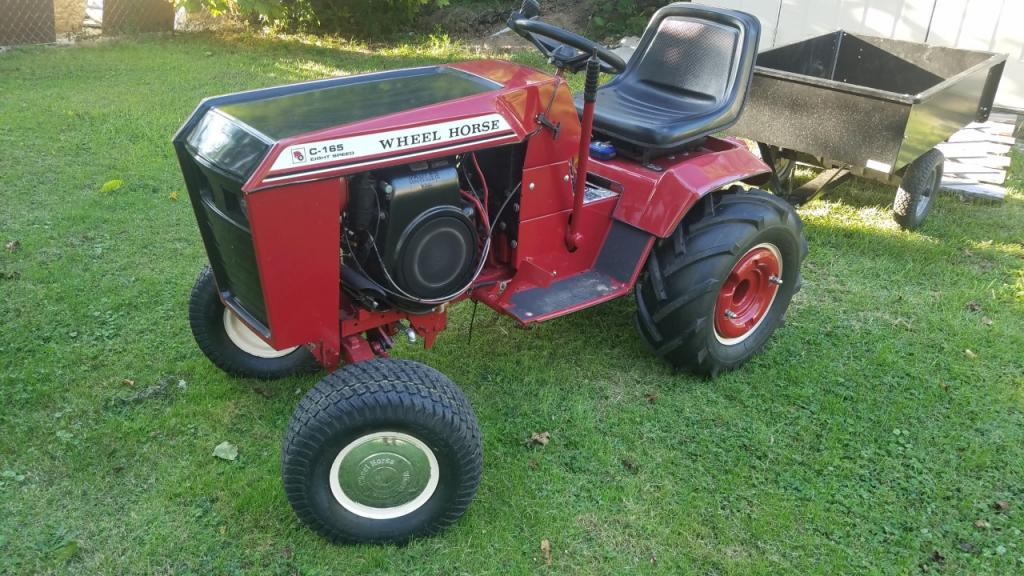

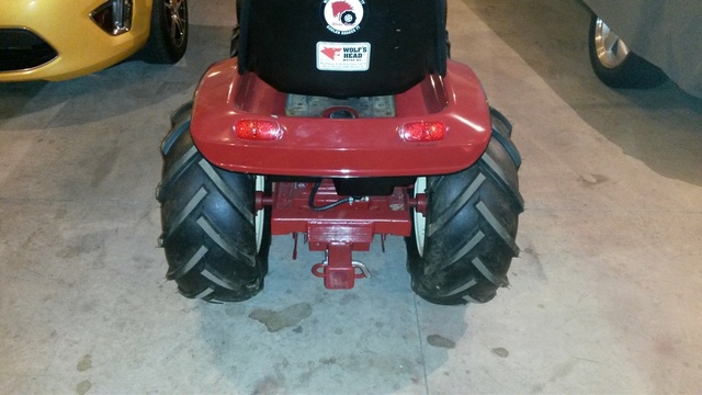

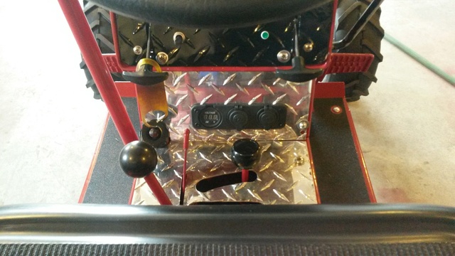

bds1984 1,519 #26 Posted July 14, 2015 Well it has been a little while since I last posted any pictures of my progress on my C165. Since my last photo update I've pretty much completed my refresh with the exception of the hood. Right now she is wearing a hood from a C125. So a rundown of everything I have done besides paint:1) Rebuilt the engine, new Kohler rod, stator, and voltage regulator (all not cheap) 2) New carburetor3) NOS PTO4) Custom exhaust5) Ag tires on all four wheels6) Swept axle w/gear reduction steering7) New steering wheel8) New seat9) Custom dash panels out of aluminum diamond plate - with tachometer, gas gauge, hour meter, and ammeter.10) 12 volt power outlet and USB outlet to bring her to 21st century standards11) 85% of the wiring replaced12) LED lights front and rear13) Custom 2" receiver I am sure there is more that I cannot think about at the moment. I just have to finish the hood before I install new decals and then I think I will have a great start to another thirty years of life. Not too bad for a worker! 8 3 Share this post Link to post Share on other sites

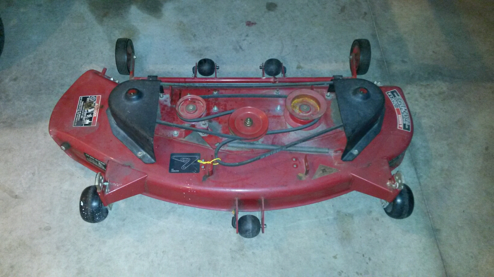

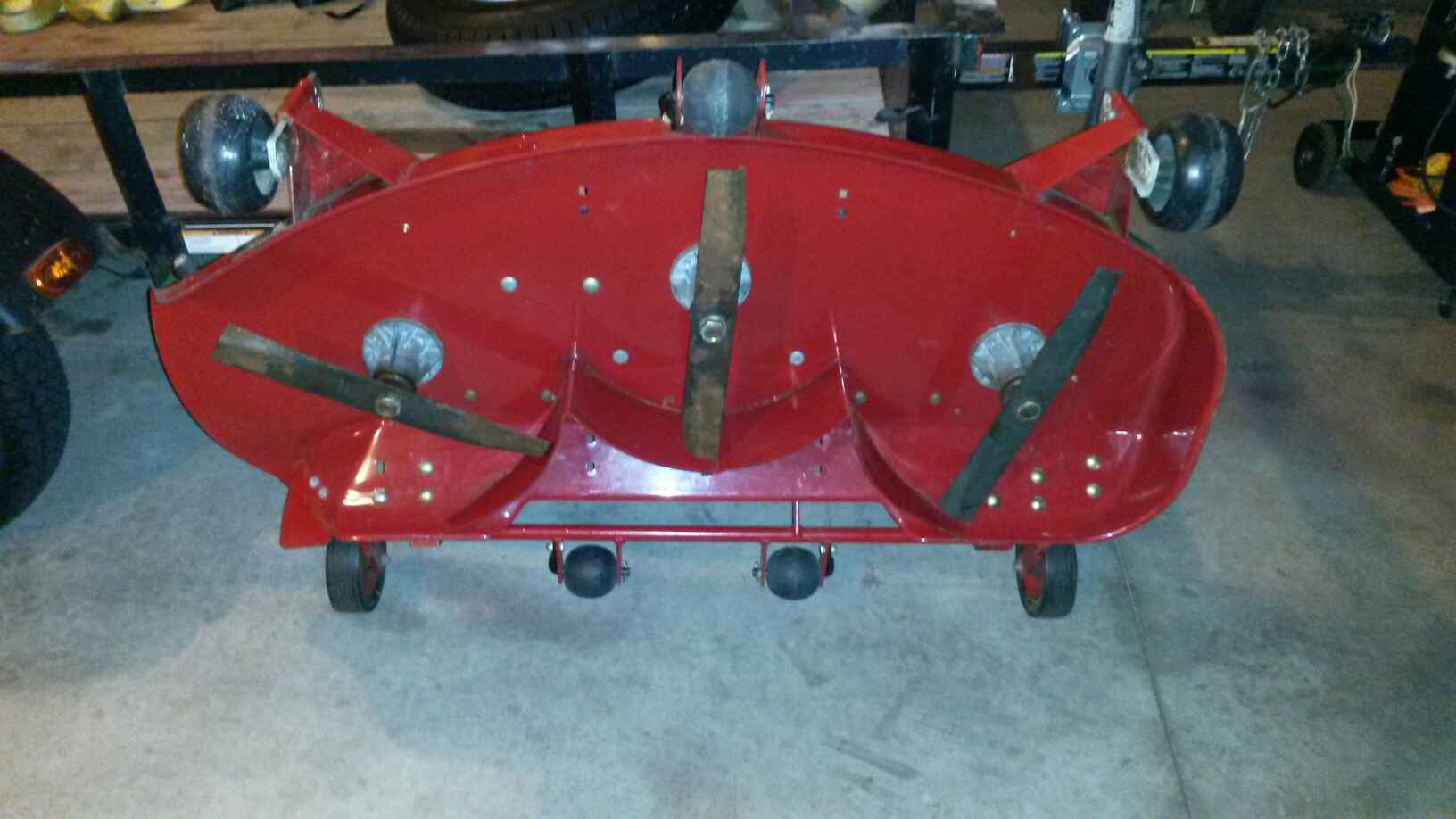

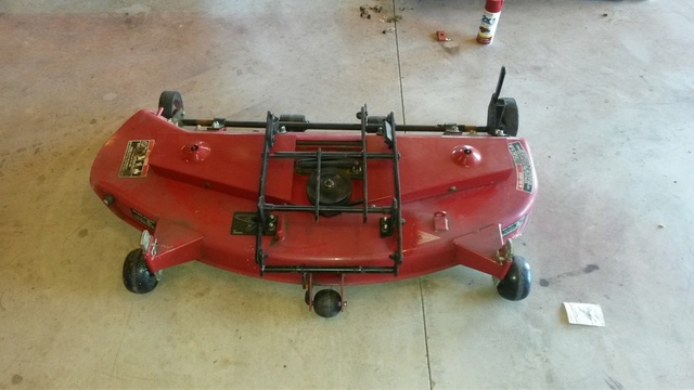

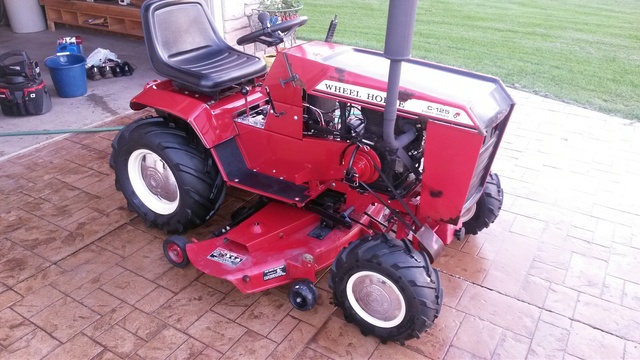

bds1984 1,519 #32 Posted July 20, 2015 I picked up a new 48-inch deck today. It has never seen grass! The downfall is that it is for a 270 series machine, but, it has all the mounting holes that my current deck uses so it looks like I just have to swap pulleys and the attachamattic system to the new deck and I'm set. 4 Share this post Link to post Share on other sites
Ken B 3,203 #33 Posted July 20, 2015 Ya gotta admit, there ain't nothing like a nice quiet mower deck! 1 Share this post Link to post Share on other sites

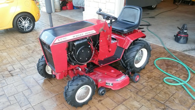

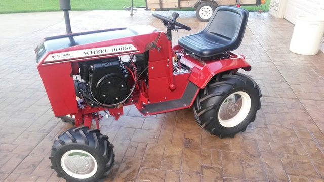

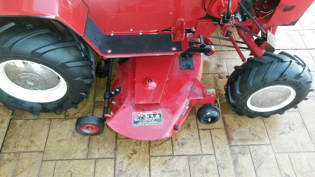

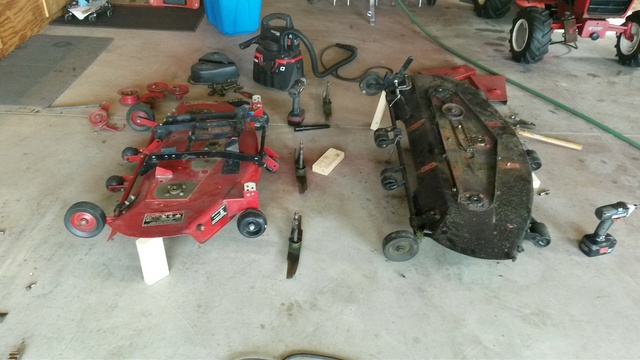

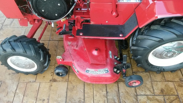

bds1984 1,519 #34 Posted July 22, 2015 The old deck is pretty quiet, just getting soft in one spot so I decided to get this deck and swap a few bits around. For the price, I couldn't turn it down! I'll most likely be selling the old deck since the spindles are good and I don't need it. Someone could.I am glad I put the swept forward axle on, think with the different gauge wheels on it may not fit! Here is what it looks like. 4 1 Share this post Link to post Share on other sites
Wheel-N-It 2,978 #35 Posted July 22, 2015 That C-165 looks like its built for a purpose now. I really like how the new deck fits so well with the swept forward axle. Good work! 1 Share this post Link to post Share on other sites

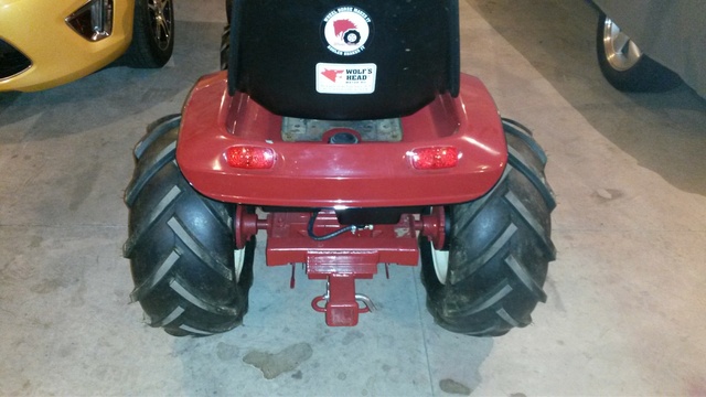

bds1984 1,519 #37 Posted September 2, 2015 The hitch was really easy Dennis. I had an extra hitch laying around that I cut down to fit. I still haven't even used it to mow the lawn since I put the brand new deck on it.... I'm kind of afraid to use it! 1 Share this post Link to post Share on other sites
DennisThornton 4,773 #38 Posted September 2, 2015 Very nice! What size are the rear tires? 1 Share this post Link to post Share on other sites

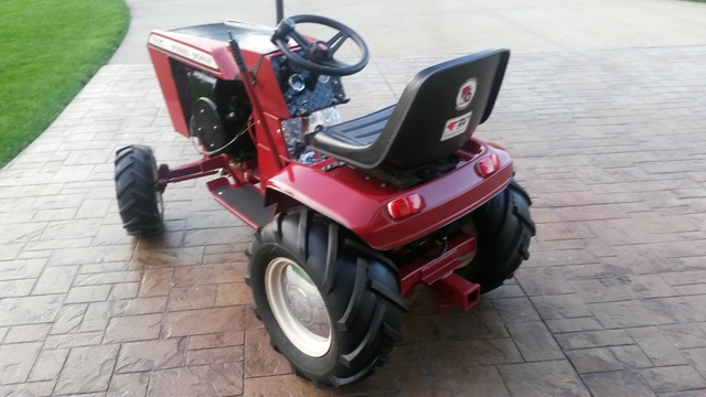

bds1984 1,519 #39 Posted September 3, 2015 23 x 10.50 x 12. I raised the fender an inch to help clear the wheels. I may lower the transmission an inch just to give more. 1 Share this post Link to post Share on other sites
DennisThornton 4,773 #40 Posted September 3, 2015 23 x 10.50 x 12. I raised the fender an inch to help clear the wheels. I may lower the transmission an inch just to give more. Thought they were bigger than that! I thought 23x10.5x12s would fit OK. Surprised! 1 Share this post Link to post Share on other sites
bmsgaffer 2,071 #41 Posted September 3, 2015 23x10.5x12 are stock tires on the 520s, should fit with no modifications!Are you using the 8.5" rims or stock C 7.5" rims? If you kept the narrower rim I could see how it may get close because the tire will "balloon" up in the middle a bit more when inflated. Just took a look at the pics, and you are most likely using the narrow rims! Makes more sense now. 2 Share this post Link to post Share on other sites
bds1984 1,519 #42 Posted September 3, 2015 They are the narrower rims which made the tires baloon out a little. I'd like to find a set of 520-h rims to match the swept axle up front. I like the look of the extra clearance, it makes the tractor appear more stout than she already is. 2 Share this post Link to post Share on other sites
Wheel-N-It 2,978 #43 Posted September 3, 2015 It looks great as is to me, but I can see where that extra inch of wheel on each side would also make the tractor look more balanced with the swept front axle. Its not easy to find those 520 wheels around here without buying a 520 tractor LOL. I'd like to find another set for a future project tractor but right now I only have one set of the 520 wheels. 1 Share this post Link to post Share on other sites
bds1984 1,519 #44 Posted September 3, 2015 It needs the extra width. I think it looks off, but then, I notice it when most people don't. If I can have access to a metal lathe for a couple hours I would make some wheel spacers and then install wheel studs so when I load the rear tires it wont be such a chore to re-install the tires. I have a 520 rolling chassis that I would have sourced all the parts from but it is an early model so it was no different than my C165. 1 Share this post Link to post Share on other sites

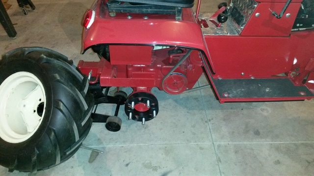

bds1984 1,519 #46 Posted December 11, 2015 (edited) Well, since 520-H rims aren't in my budget at the moment, I bought a pair of 1.5'' wheel spacers to even out the stance. Just waiting for the snow to fly to get some seat time! Edited December 11, 2015 by bds1984 2 1 Share this post Link to post Share on other sites

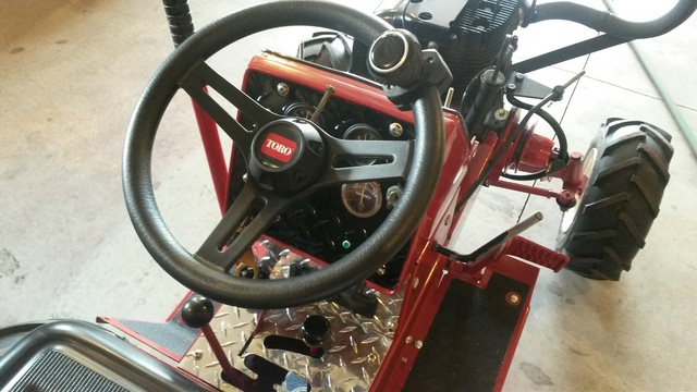

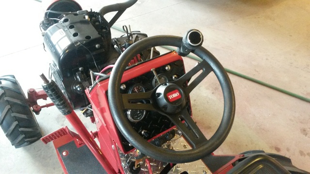

roadapples 6,987 #47 Posted December 11, 2015 Nice job, looks great. What is the steering wheel off of. 1 Share this post Link to post Share on other sites
elcamino/wheelhorse 9,363 #48 Posted December 11, 2015 You sure did a lot of work and it turned out great. Wish I had time , money and knowledge so I could do something like your tractor. 1 Share this post Link to post Share on other sites
bds1984 1,519 #49 Posted December 11, 2015 Well so says ebay, the sterring wheel came of a Toro Groundsmaster 345. Don't worry, the Toro sticker has been removed and a WH cap installed! 1 Share this post Link to post Share on other sites

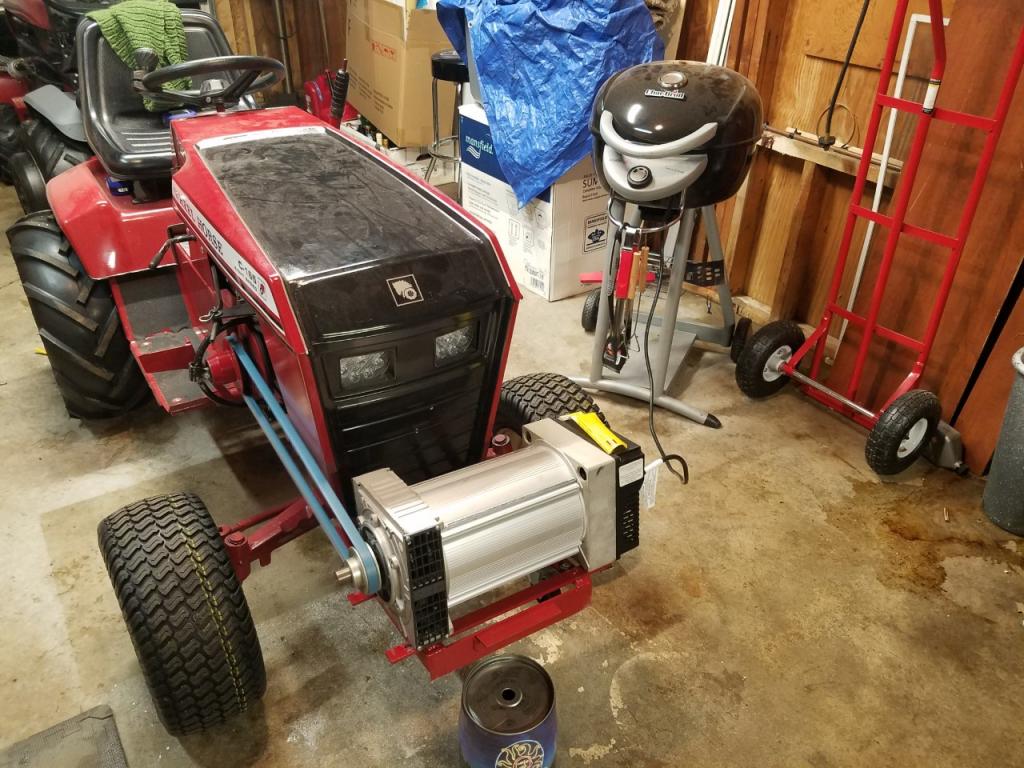

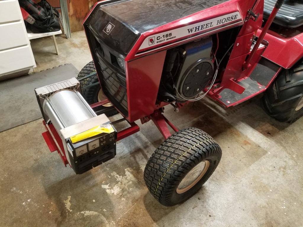

bds1984 1,519 #50 Posted January 4, 2020 I figure I should update this thread with the most recent picture(s). Gone are the ags up front in favor of 18-8.50X8 turfs and an NOS hood with all decals finally installed. The generator is the 7200 watt unit one can get from Harbor Freight which is easily powered by the K341; enough to get me through any power outage I may experience. Lastly, the rear cast iron wheel weights that add over fifty pounds per side. In addition to the rear tires loaded with Rim-Guard, I am at just over 160 pounds per side now. 4 4 1 Share this post Link to post Share on other sites
