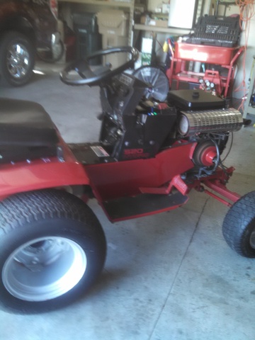

520 H won't start. Hour meter/oil sensor

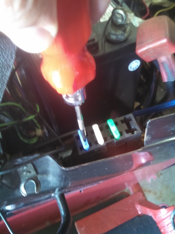

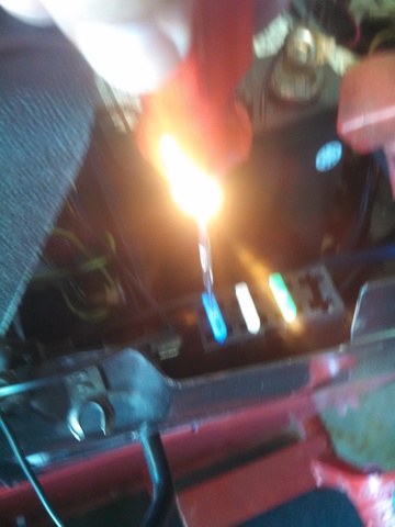

I picked up 6/12 tester. The 15 amp fuse was blown! I replaced all the fuses when I started this project. I overlooked the fuses after replacing them. I still have the oil warning light not working. I can look at that again. I'm just happy it was something simple. All three fuses have around 12.5 volts.
I'm confused. I just pulled the 15 amp out and it wouldn't start. Put it back in and it started. It won't start with the 25 amp pulled out either.

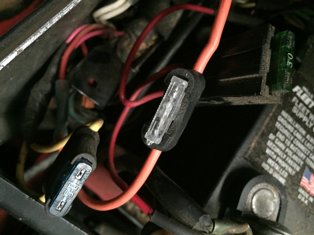

cheesegrader
I agree with squonk.
That fuse block is a piece of junk.
I think you have an intermitent short at the block, and every time you work on it, you change the problem.
(In addition to the reversed sensor wires, which appears to be solved now)
I would cut the %&$##$%! thing out and replace with three individual sealed auto fuse holders.
I've been amazed at the problems that I have solved just replacing that thing.
608KEB
It wouldn't crank over with the 15 amp fuse out. I"ll change the fuse holder and report back. Cheese grader do you have a picture you could post of your upgraded fuse block?
Edited by 608KEB
Save Old Iron

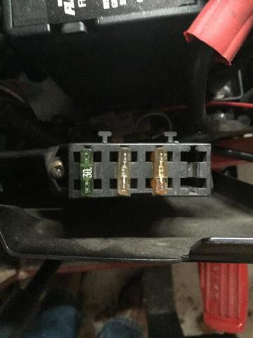

cheesegrader

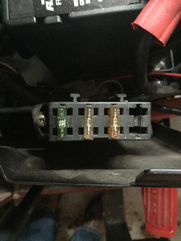

The first picture is a 96 with the original fuse block still in place.
Fuse order, back to front, is 30/25/15
IMG_0453.thumb.jpg.3a44ff8f96edd34374c09
The second picture is a 94 with the block out and individual holders in (without the velcro straps holding them)
30 is red/red
25 is 2 white/orange
15 is whatever was left, can't remember
IMG_0455.thumb.jpg.dbf6f2c66fbd0f183f3bc

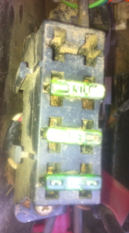

The third picture is the reason the 94 block failed.  Yuk!
IMG_0324.thumb.jpg.dd8da664c753c75babe99
Save Old Iron

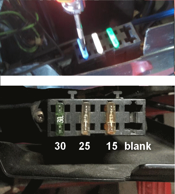

Make sure the fuses are in the correct slots.
608KEB
I have my 15 and 30 amp in the wrong slots. On my 93 520 the 15 amp is closest to the seat. I just checked. I pulled the 15 amp out of the 93 and the lights went out. On the 94 I'm working on the 30 amp is closest to the seat. I just checked that too.
Edited by 608KEB
Save Old Iron
another issue resolved, this is why the 15 amp fuse was intermittently blowing.

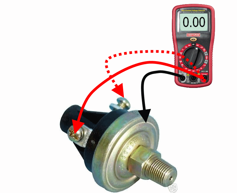

one terminal on the pressure switch should be grounded with withe engine OFF - hook the oil pressure indicator to that terminal.
the second terminal on the pressure switch should ground out WHEN THE ENGINE IS RUNNING / HAS OIL PRESSURE - connect the hour meter to this switch terminal.
we need to go back and check for proper operation of the pressure switch by using the resistance range on the multimeter
engine off  -  no wires connected to pressure switch - multimeter set to 200 ohms range - measure from the metal switch body to each terminal
one terminal should show a near 0 ohms reading, the other should show an open (over range) reading
start the engine - the two wiring terminals on the pressure switch should REVERSE their resistance readings - 0 ohms should go over range - over range should now read near 0 ohms
simply put, the two screw terminals on he switch should never have the same resistance value  engine on or engine off
let's get these switch conditions verified before going any further.
