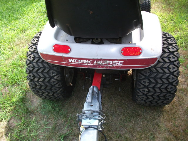

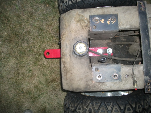

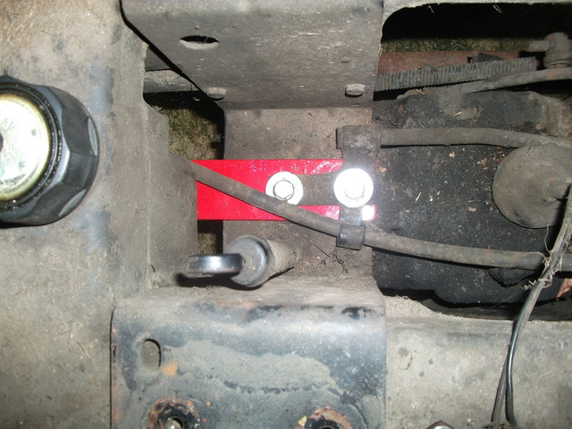

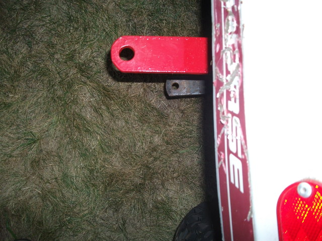

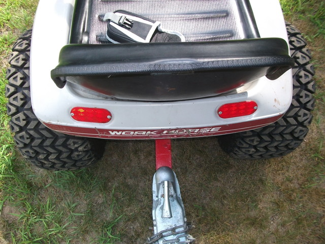

Sparky-(Admin) 26,899 #4 Posted August 8, 2015 (edited) I wouldn't say he has been workin all the time....he did manage to have a few of these hitch bars made up. My GT1600 has a fuel issue so I decided tonight to just rip out all the fuel lines, filter and the tank shut-off. Perfect time to install the new hitch.It does require the two 3/8th bolts in the top of the tranny to be swapped out to longer ones, but other than that its a 5 minute job (unless your swapping all the fuel lines AND the shifter boot like me ). It sticks out farther and is higher than the factory hitch, it'll get a hitch ball and will be perfect for moving my boat and utility trailer. The factory hitch is just way to low.Pics of course!Mike....... Edited August 8, 2015 by Sparky 1 Share this post Link to post Share on other sites
Docwheelhorse 2,993 #5 Posted August 8, 2015 Woo Hoo!!! My hitch design in action!! (I didn't even get to put one on my machine yet..) . Its 3/8ths flat stock and time will tell how it works out... I don't think it will bend or overload anything as long as common sense is used. I just liked its simplicity (much like a Wheel Horse itself) versus these fancy over priced flimsy hitch adapters that are out and about the market place. If anybody is interested I can have the steel shop I know bang out a few more and sell them for cost plus shipping (~~~$30 each total). I just slobbed some good old rust-o-leum sunrise red on with a brush to make them look good and the hitch ball hole is 3/4" (standard size) .looks good Mike!!!Tony Share this post Link to post Share on other sites

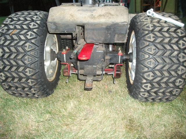

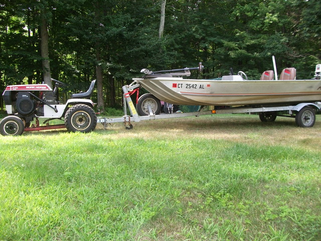

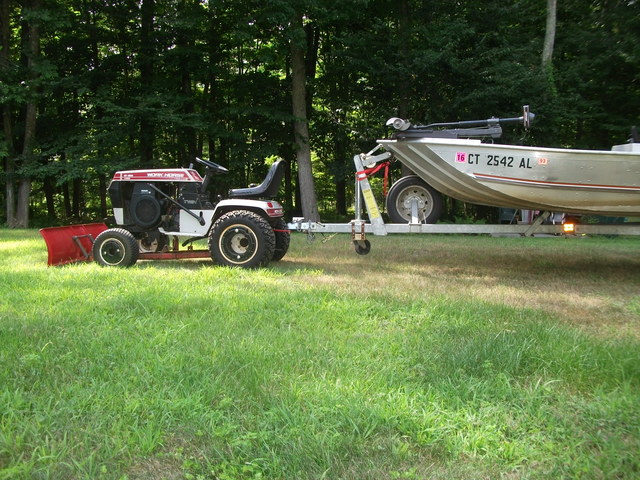

Sparky-(Admin) 26,899 #6 Posted August 8, 2015 Got the tractor all back together and gave the hitch a workout. My boat on the trailer is an estimated 2000#s....not sure what the tongue weight is but its on the heavy side. Maybe 150 pounds loaded with the boat? That's about all I would want on the new hitch so moving my unloaded utility trailers around should be a snap.The first pic is on the new hitch...the second is on the old factory hitch (my trailer tongue wheel is almost on the ground).Mike...... Share this post Link to post Share on other sites
