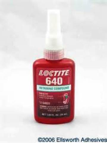

squonk 48,038 #3 Posted August 1, 2015 Just so you know, I replaced the keys on my 73 12. Both keys were different. The original owner swears that the rear axle was never touched except for the right side seal.. Make sure the key way slots aren't worn out and the key fits good. If they wiggle a little I but some Loctite bearing and sleeve retainer to help take up some of the slop.http://www.wheelhorseforum.com/topic/46580-a-tale-of-2-keys/ Share this post Link to post Share on other sites
