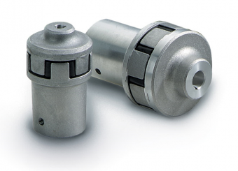

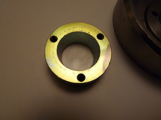

tommyg 157 #7 Posted December 7, 2015 I would be interested in at least having a spare. But ideally, it would be great if someone could design a coupler that didn't rely on the splines (which we all know wear out) and come up with something that could be affixed to the pump shaft more permanently with a more durable (and available) coupling kind of like the one below. Share this post Link to post Share on other sites

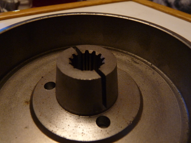

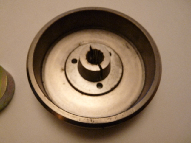

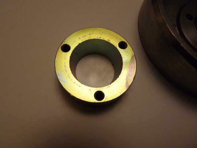

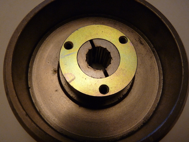

ranger 1,856 #8 Posted December 8, 2015 On 07/12/2015 at 5:24 PM, tommyg said: I would be interested in at least having a spare. But ideally, it would be great if someone could design a coupler that didn't rely on the splines (which we all know wear out) and come up with something that could be affixed to the pump shaft more permanently with a more durable (and available) coupling kind of like the one below. Here is an idea to help prevent spline wear, this, we used years ago on parking brake drums which were only held on the shaft by circlips. The hub is split part way through and has an external taper, the cap has an internal taper, when the two are pulled together by the three screws the hub is clamped tightly to the splined shaft, It usually holds it so well that no other fasteners are needed. If you have room to fit something like this, it may be worth a try. Share this post Link to post Share on other sites
bgh5469 17 #9 Posted December 9, 2015 Depending on the price I would be interested in one or two to keep just in case. Share this post Link to post Share on other sites

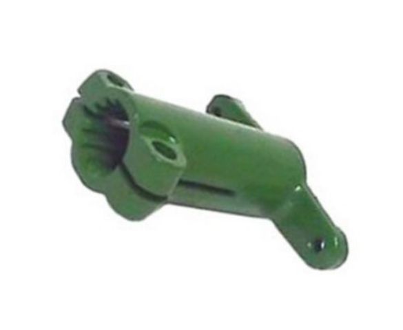

JackC 619 #10 Posted December 9, 2015 Usually it is the steel half of the coupler that fails and the splines on the pump remain undamaged. There is also a clamp on coupler configuration that could be used (or made) for repair applications if the splines on the pump are also damaged. Share this post Link to post Share on other sites
tommyg 157 #11 Posted December 9, 2015 1 hour ago, JackC said: Usually it is the steel half of the coupler that fails and the splines on the pump remain undamaged. There is also a clamp on coupler configuration that could be used (or made) for repair applications if the splines on the pump are also damaged. I see a similar amount of wear on both, but I would agree that the steel half might wear a bit faster. This design would keep friction and wear to a minimum if movement of the splines was minimized by a couple bolts. Can something like this be designed to adapt directly to the rubber dampener? That would be most ideal. Share this post Link to post Share on other sites
JackC 619 #12 Posted December 10, 2015 Some have drilled through both the steel half of the coupler and the hardened shaft of the pump and used a pin or bolt all the way through. Share this post Link to post Share on other sites
