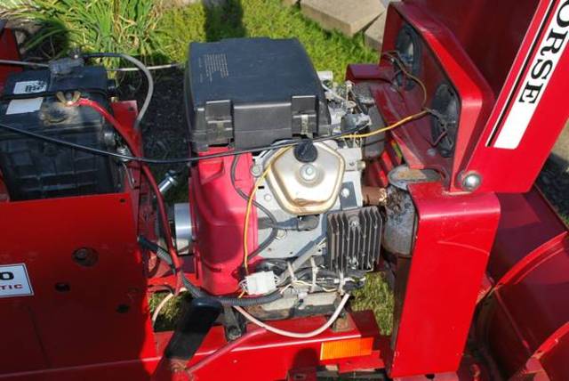

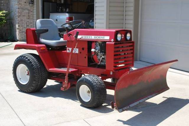

I thought this was interesting. I found this on a Craigslist ad in Columbus. This guy had his d200 repowered with a Honda 24hp V twin. So it's possible. However, there's no clutch mechanism set up. All he's able to do is push snow. No PTO to engage. I wonder if that was by choice or otherwise. On another note, the tractor looks to be in great shape! Mark, this might be the same one you saw. He's in Lima, OH.
Edited by tommyg
  • Like 1
Don1977
Don't see why an electric clutch couldn't be installed on that Honda.
  • Like 1
tommyg
Good possibility. Do you think an aftermarket clutch could fit? I'm used to the double clutch system surface of the Kohler and need to be able to drive a 60" deck. So it can't slip.

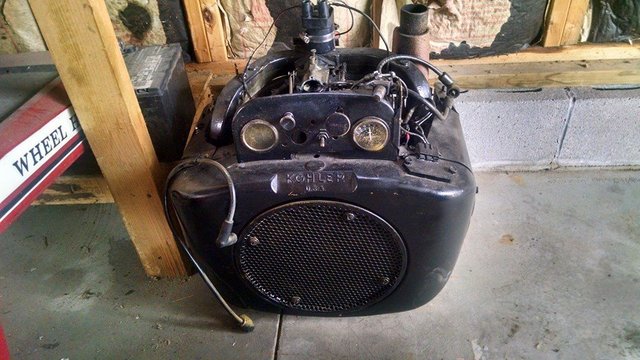

Running engine $250 Just taking up space

I looked at an engine like that - VERY similar - and turned it down because the crank on the PTO side wasnt like the D's. Is this one same as D's or?
Yes, Tommy it is I remember it well.
tommyg
He's actually a member here on Red Square and has a listing in the classifieds. We've messaged back and forth a few times already. That set up was done by the Small Engine Warehouse in Muncie Indiana. It was their first attempt at re-powering a D. They had some parts machined for the connection to the pump and had to raise the engine up to fit. Not sure how they accomplished the muffler, but even though they're not original, they do follow the same pathway out the bottom of the front hood support as originally designed. The only other modification he had to make was to put a spacer to spread out the hood a bit because it hit the engine slightly when closed. But again, no PTO clutch.
