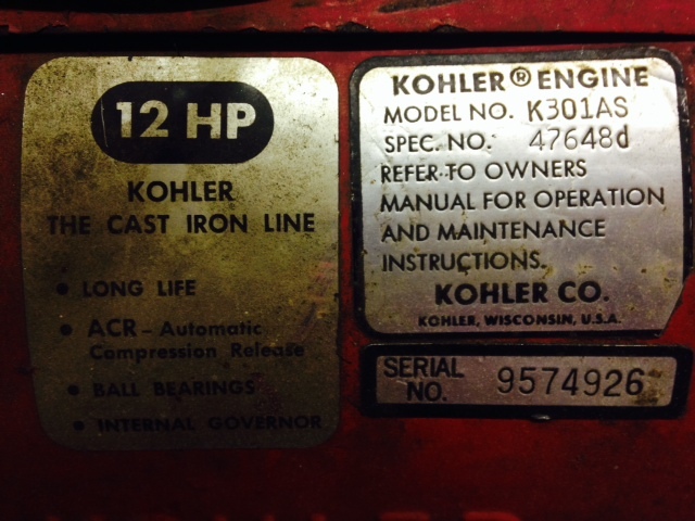

Skooled 0 #1 Posted July 18, 2015 My c-121 not getting enough gas. We have tried just about everything. If you put gas in above the fuel pump it starts much better and sounds better.It works okay going downhill, but has gradually gotten the point that to even mow on level land (with mower engaged) it has to be in first gear. New to this site, not super handy, and not exactly sure on how to go about finding parts. Any help would be appreciates and apologies if this is not the correct area for this type of request. Share this post Link to post Share on other sites
