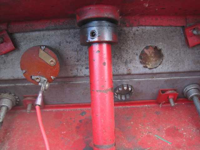

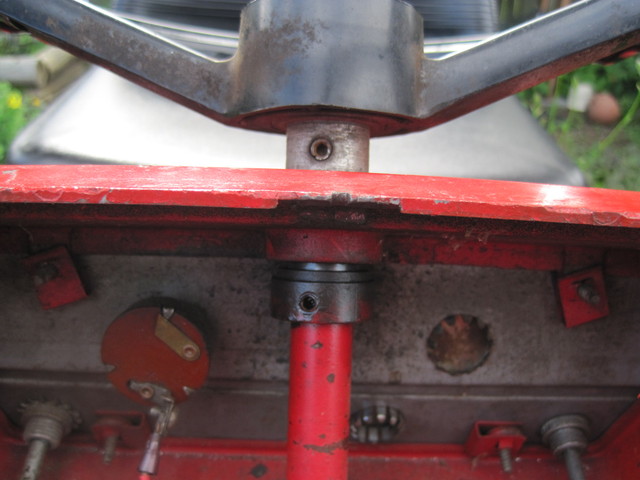

Sprocket 48 #12 Posted July 9, 2015 I think I found part of the issue - see the attached pictures. The bottom locking collar looks to have some room, the set screw is stuck atm but I've hit it with PB and will try again later. Is there anything in there that heat would hurt? I could try heat & wax or just heat and hope it pops, at least it's not stripped.The top collar looks to have a large roll pin - is this correct? No allen wrenches fit and grab.The shaft with the fan gear has some wiggle room at the rear - might be a worn bushing, egged out hole or worn shaft. The front end seems to be snug overall.Thanks for the help and comments Share this post Link to post Share on other sites
Coadster32 793 #13 Posted July 11, 2015 Lock collars are typically set screws, but thru years of possible alterations, can't rule anything out. Sometimes et screws get so beat up, no allen wrench will work. As far as heat goes....watch the gas tank!! Share this post Link to post Share on other sites
squonk 48,429 #14 Posted July 11, 2015 If you can get that lower collar loose you will be able to pull the shaft up to get a bearing serarator behind the wheel. If that roll pin doesn't come out, you can shear that roll pin with a big honkin puller grabbing that separator. Not the wheel. from your description though it sounds like the lower steering support is shot. Getting that lock collar loose will allow you to change it without having to mess with the wheel. Share this post Link to post Share on other sites
Sprocket 48 #15 Posted July 11, 2015 Am I understanding this correctly?The loosening the bottom collar at the top end will let me replace the junk at the bottom end?Based on the bounce space at the dash, I'd like to install something there too - bronze or rubber, just something to stop the vibe noise and keep it centered... Share this post Link to post Share on other sites
squonk 48,429 #16 Posted July 11, 2015 Yes. If you get that lower collar loose, you can pull the steering shaft up and get it out of the lower support.http://www.wheelhorseforum.com/topic/57385-overkill/ Share this post Link to post Share on other sites
