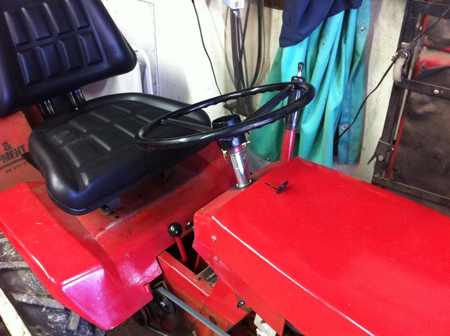

squonk 48,429 #9 Posted July 3, 2015 shaft extended 2.5 " Wheel won't hit hood no more! 4 1 Share this post Link to post Share on other sites

woodchuckfarmer 333 #11 Posted July 3, 2015 Nice seat....Wayne 1 Share this post Link to post Share on other sites
squonk 48,429 #12 Posted July 3, 2015 Paitence Grasshopper! 1 Share this post Link to post Share on other sites

Brian01 481 #14 Posted July 3, 2015 While you had it apart, you should have fabbed up tilt steering. 1 Share this post Link to post Share on other sites
Wheel-N-It 2,978 #15 Posted July 3, 2015 Looks like its more comfortable to drive now Mike!BTW, one of my coworkers brought a homemade cake to work today with rhubarb and strawberry topping. It was de-licious:) 1 1 Share this post Link to post Share on other sites
