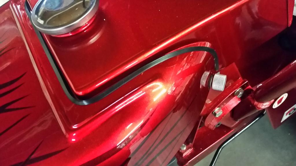

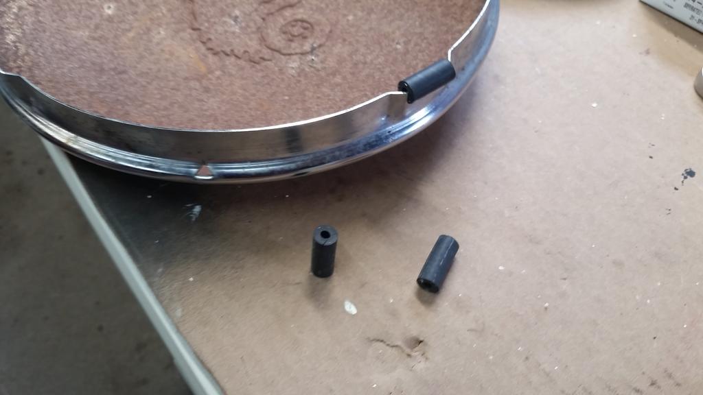

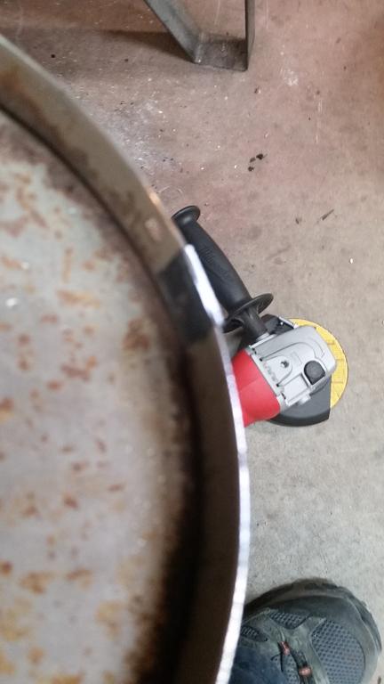

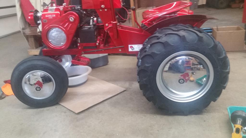

WHX?? 58,307 #29 Posted March 28, 2020 (edited) Update to this thread. Wasn't sure if we would like hub caps or the open look on this tractor so didn't want to scratch. The fronts I used the door trim which worked great. Just a one inch piece in place of the removed clips. McMaster Carr has it or I can send you a piece. Lennox sent me a roll to quite noisy AC panels. This stuff is supposed a glue inside to stay stuck but a dab of contact cement or silcone helps. BTW also works great for hood to tank trim. This stuff is also offered in a crome version for trailer queenies who want some bling. Rears did not work at all... not thick enough to get a good grab. I had some hose laying around that I cut into one in pieces and slit down lenght wise with a razor knife. Measured about 3/8 od 1/8 id. Think it was a left over scrap from windshield washer tubing or auto vacuum tubing. Was a tight fit but some careful tapping with a rubber mallet they went on just like she likes...goodntite. OEM clips were a pain to get off as previously mentioned... spring steel.. I hit the tops of them lightly with a grinder to persuade them. Edited March 28, 2020 by WHX24 1 3 Share this post Link to post Share on other sites
squonk 48,231 #30 Posted March 28, 2020 I was just contemplating the same thing. I have powder coated wheels and a set of caps sitting on the shelf. Was gonna try duct tape but I got some of the door edge moulding too Share this post Link to post Share on other sites
