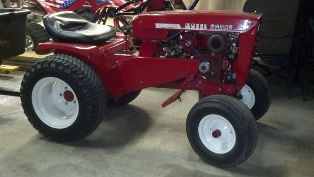

RedRanger 1,470 #1 Posted July 6, 2015 (edited) I have a set of hub caps/wheel covers that I've been considering using. I don't want to scratch my freshly powder coated wheels though. Is there a trick anyone knows of that will save the wheels as it seems every tractor I've seen that had wheel covers at one time has the scars to show it. If they're going to scratch my wheels, I won't use them.Who has experience using wheel covers? I was thinking of maybe using electrical tape over the clips and making sure the clips have light pressure on the wheel??? Edited July 6, 2015 by RedRanger 1 Share this post Link to post Share on other sites

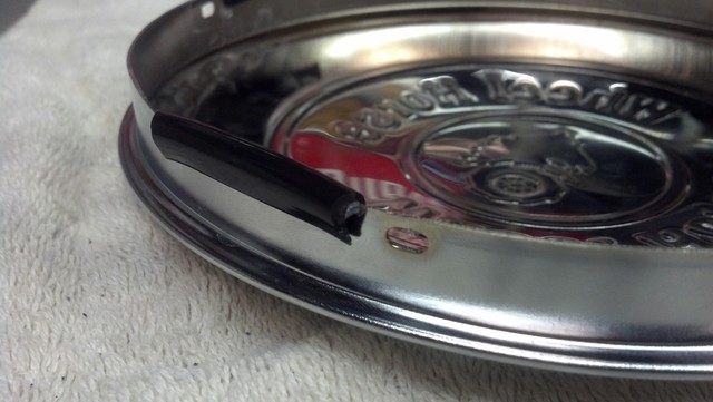

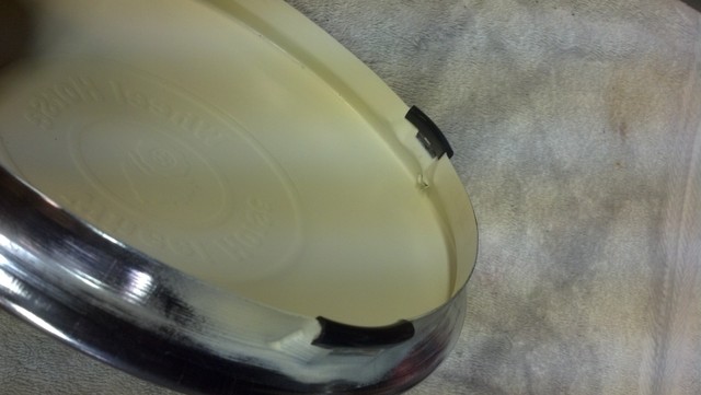

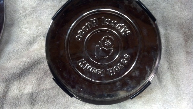

M151A1 2 #7 Posted July 7, 2015 You can remove the clips and buy the u-shaped door edge guard at your local auto parts store. Cut pieces and apply to hub cap. The newer rims have a concaved lip for the bead lock and the door edge snaps snugly into that grove. 1 Share this post Link to post Share on other sites

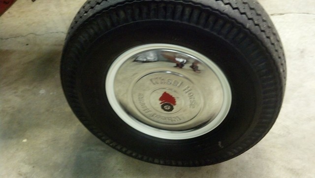

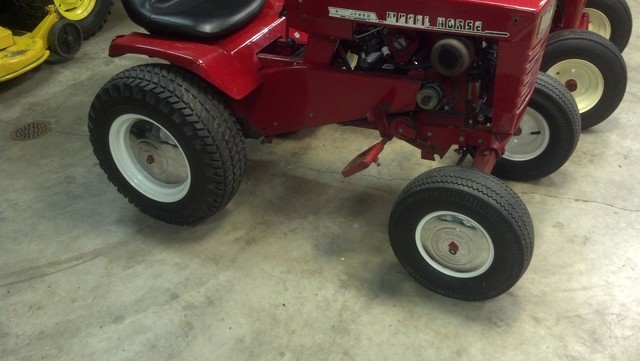

RedRanger 1,470 #15 Posted July 13, 2015 M151A1 hit it! Door edge guard works perfect.I removed the clips (what a PIA). Installed sections of door edge guard.Installed covers.I did have to "adjust" the tension on two of the caps by flexing the lip out making the fit a bit more tight, but these things don't budge.Without prying them off, there is no removing them.Nice thing is they tapped in as secure as they would with the metal clips.No silicone or glue needed.If they fall off or come loose, I'll post back.Thanks for all your input and to M151A1 for saving my wheels! 2 Share this post Link to post Share on other sites

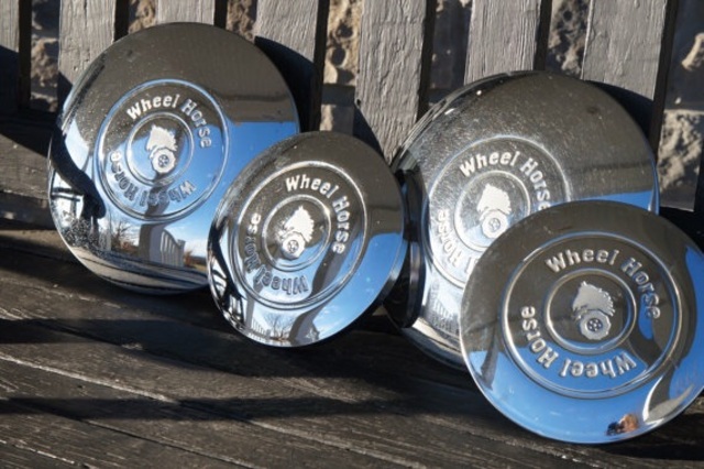

MikesRJ 563 #16 Posted July 14, 2015 (edited) Not to hijack a thread, but I have a question for all you hubcap owners. What does a set of brand new, in the original wrapping paper, chrome only hub caps go for these days. I have a set of four, 2x 8" fronts and 2x 12" rears. Similar to the image below. The pictures not mine, just an example. Edited July 14, 2015 by MikesRJ Share this post Link to post Share on other sites
