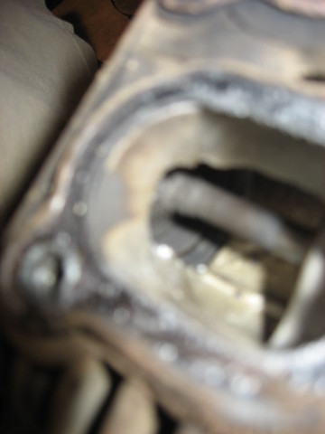

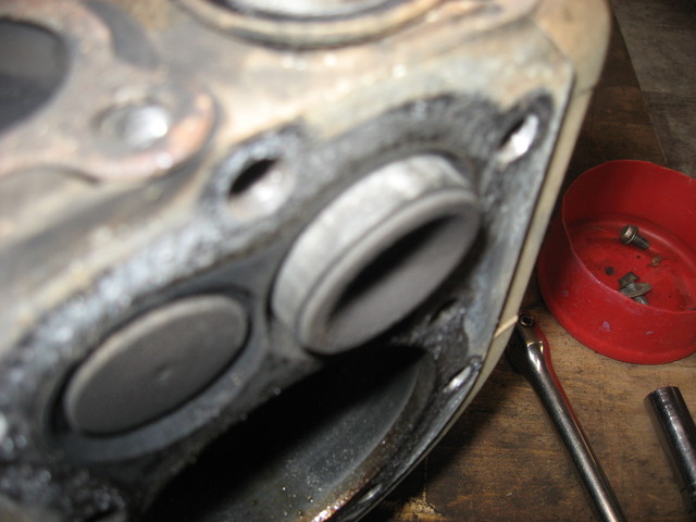

stuppy62 58 #5 Posted June 28, 2015 Thanks for you're responses. Boovuc, I did the compression check first and unfortunately you are correct. I had 30 lbs. of compression, so I pulled engine and opened up to see. I've got a very hammered intake valve seat. Next questions is, is this repairable? Share this post Link to post Share on other sites
boovuc 1,090 #6 Posted June 28, 2015 Throw some pics up here and let the experts, (no.....not me), take a look! Share this post Link to post Share on other sites

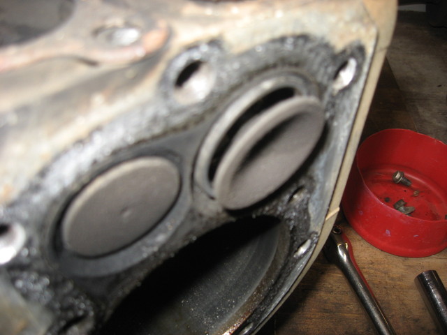

stuppy62 58 #7 Posted June 28, 2015 The valve seat is very loose, can move in & out with you're fingers. The third pic is inside where there the seat was scrubbing around in there. If I had a machine shop fix this could I get away with not pulling the piston's & sleeves? It has 1050 hrs. on it. Share this post Link to post Share on other sites

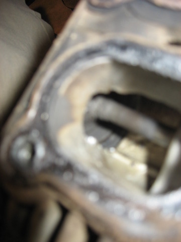

boomers_influence 106 #8 Posted June 29, 2015 stuppycan you post some pics that are MORE CLEAR?especially needed, the one of the inside of the port.thank you. boomer ( the used onan engine parts guy, also NOS and new ) 1 Share this post Link to post Share on other sites
stuppy62 58 #9 Posted June 30, 2015 At this point I'm going to drop off at local machine shop. Over the phone they said to bring it in they might be able to fix it. I'll keep you all posted. Share this post Link to post Share on other sites
boovuc 1,090 #10 Posted June 30, 2015 Keep us posted. Loose can be a good thing verses hammered and cracked. Share this post Link to post Share on other sites
stuppy62 58 #11 Posted July 15, 2015 Ok, the valve seat is fixed, plus 4 exhaust bolt holes repaired. Cost $110, plus I'm getting gaskets & filter from boomers_influence. another $60. I don't think that's to bad for this fix, I just need to get everything together & hope for the best! 2 Share this post Link to post Share on other sites
