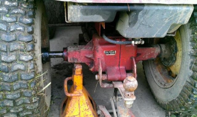

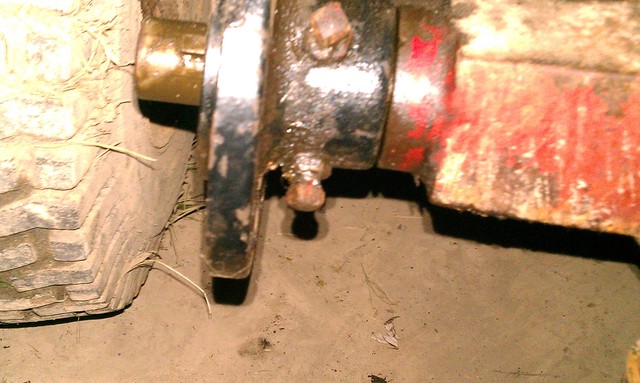

skeptichorse 25 #12 Posted June 25, 2015 Think I may have found part of the problem.... I am pretty sure the left axle shouldnt slide out this far... But even out this far if I spin either wheel the other one moves in the opposite direction.I let all the air out of the right rear and stood on it and it did flex now so I am thinking that the guy may have had the tire way over filled and when I let some air out lastnight wasnt even close to enough. Share this post Link to post Share on other sites
C-101plowerpower 1,606 #13 Posted June 25, 2015 yep there's your problem, better fix that before the thing that holds the axle in gets to places where it isn't supposed to go Share this post Link to post Share on other sites
bmsgaffer 2,071 #14 Posted June 25, 2015 If you spend some time browsing around there are some VERY good threads and videos on rebuilding the 8 speed. Yours lost a clip that holds that axle into the differential. While you are in there you can find and replace any excessively worn gears or bearings that may be contributing to your traction loss.You probably had the axle slide out on you when you were in the mud and that will disengage or jam it in the differential which will cause problems. However I think that your biggest problem is that you are trying to drive a 650lb + weights tractor where a 300-400lb tractor was light-footing it.If the wet ground is common, then get some wider front and rear tires on it and it will help tremendously (and get AG tread or chains if you dont want to get stuck in the muck). The stock tires are fairly narrow.Oh and they are NOT locked diffs, they are open. Share this post Link to post Share on other sites

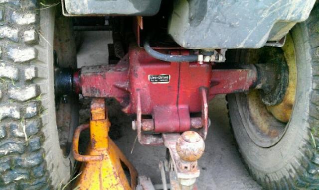

Callen 64 #23 Posted June 26, 2015 Before you go any farther with it, pull the weights off and see if the end of the axle is flush with the outside edge of the hub. Looking at the pic above the one with the extended axle, both hubs are slid clear in against the housings which they shouldn't be. I suspect the hub is about to come off the axle since you said it still turns opposite as the other side even out that far. It should be out of the differential if it is out that far. 1 Share this post Link to post Share on other sites
skeptichorse 25 #24 Posted June 26, 2015 Callen I hope you are right ..... I will try to pull those tonight... and I will post picts of what I find 1 Share this post Link to post Share on other sites

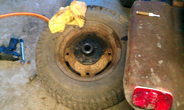

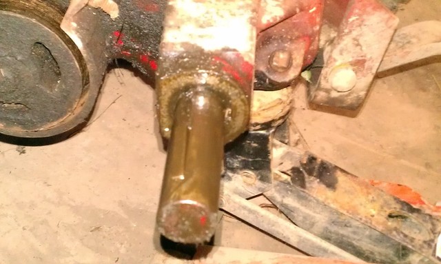

skeptichorse 25 #25 Posted June 27, 2015 Ok Callen Lucky for me you were right. I pulled the weight off and noticed I could stick my finger in the whole, so I gave the wheel a good tug and it popped right off almost knocking me over. I ran my finger inside the hub and noticed that neither set screw were tightened enough to even feel them. Lucky for me that it didnt fall off when my son was out riding it.I pulled the hub off the wheel and tightened BOTH set screws as tight as I could get them. then reassembled it and did a test drive in 3 Hi and held the wheel all the way to the left at full throttle. Got a little sketchy at times, felt like the machine was on one rear wheel a few times. Then I tried some grades side ways to get the wheel to slip. When I get it back in the garage,,, nothing no more than 1/8 of play on the axle..even with me pulling with my feet against the machine. So trans seems good ... so it appears I am back to it being a tire issue. 2 Share this post Link to post Share on other sites
