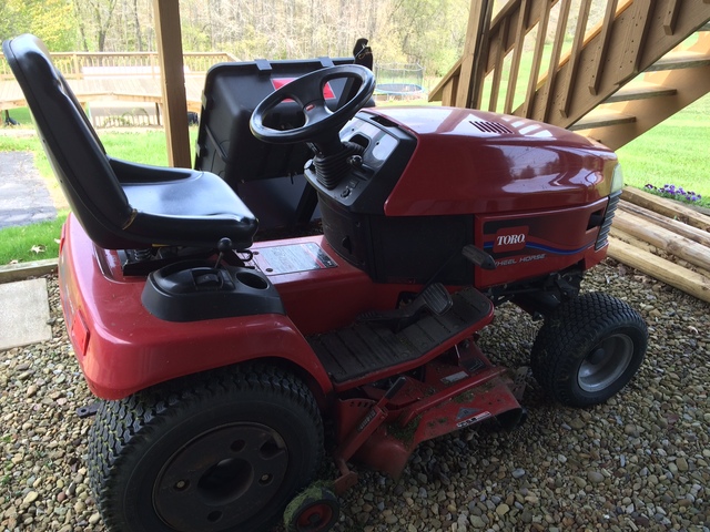

lumnut34 4 #1 Posted June 14, 2015 Ok so this is my first full summer with a 2001 522xi I purchased last year from a family friend. It has the 44 in deck and is a beast. Just rolled over 700hrs not bad for 14yr old machine. My yard is just under 2 acres and mostly hill. I have found the last two times that while going downhill the rearend has a slight slip to it and starts to freewheel. Nothing major on the freewheel but it is concerning. Before I contact the local wheelhorse/toro shop I wanted to get some opinions. Any help or input would be appreciated it. I certainly don't want to wind up rolling down the hill!! haha Share this post Link to post Share on other sites

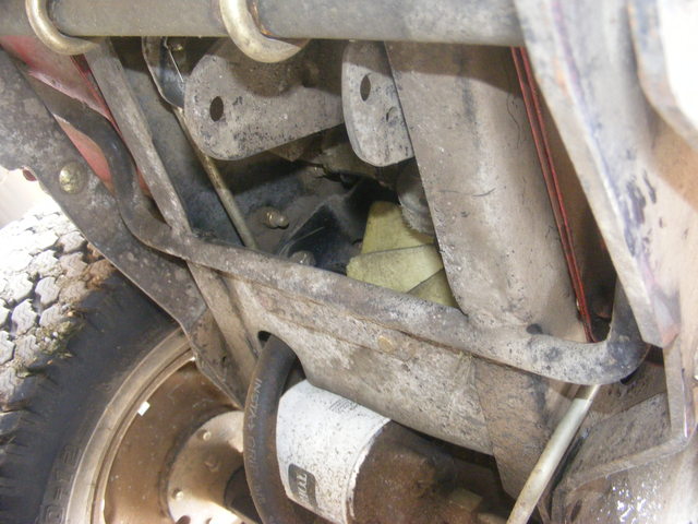

shallowwatersailor 3,221 #4 Posted June 14, 2015 (edited) It is a nice looking 522xi. Are you running at full throttle while cutting? Are you using L-Range when needed? That does sound like a low fluid or overheated fluid situation.As Rick said, start by checking the fluid and the fan on the driveshaft. Make sure that there isn't a buildup of grass clippings. I use Mobil 1 10W-30 synthetic in my three and buy it in the 5 gallon jug. It takes 4-1/2 quarts to do the change. I have always used the Toro black filter but will be switching to the NAPA 1410 as I have had to wrestle too many of the Toro fliters off. The NAPA filter has the same micron rating of 10 Microns and flutes on the end that will allow you to use a cap wrench. There should also be a vinyl cover under the tractor by the fan. It protects it from sticks, etc. from being ingested by the fan blades. I once broke a blade using my 312-A in the brush around my property so it can happen.Here is my 520xi when I purchased it. The vinyl guard is the piece with the circular cut for the hose. Edited June 14, 2015 by shallowwatersailor Share this post Link to post Share on other sites
