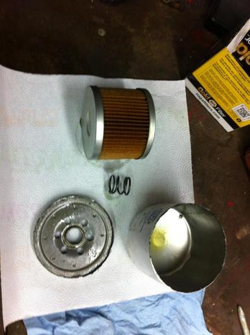

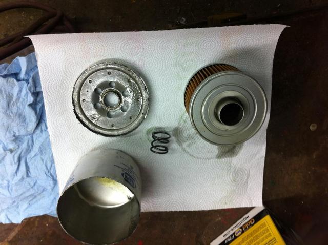

squonk 45,816 #1 Posted July 13, 2014 I have been singing the praises of a Napa 1410 Hydro filter for a couple of years. I am not badmouthing OEM Toro, but not all of the members here have a Toro dealer nearby. Plus not all dealers (including mine) stock the Toro filter. It gives members another option and there will be no need to hesitate to buy a Napa (Wix) filter. My local Napa stocks the 1410 or can get it within hours if needed as opposed to over a week from the dealer. I cut open the Toro once. Wish I had pics.If I remember right the Toro had less pleats and a piece of tin (Like Fram) as opposed to the real spring in the Napa 1410. If another member removes a Toro filter maybe they can cut it open and post pics. If I ever run across another one I'll cut it open and post them here. 7 Share this post Link to post Share on other sites

shallowwatersailor 3,220 #4 Posted July 19, 2014 I can't tell from the photos but does the Napa 1410 have indentations to take an end-cup filter wrench? I just changed the Toro filter (that is smooth) on the 523Dxi that was on so tight that I ended up driving a screwdriver through it to lever it off. All the tricks were used before resorting to this. The new owner prevailed - and I did get it changed! 1 Share this post Link to post Share on other sites
Racinbob 12,850 #5 Posted July 19, 2014 I like to use the type such as K&N that have a 'nut' on the end so a socket or wrench will work. 1 Share this post Link to post Share on other sites
squonk 45,816 #6 Posted July 19, 2014 The 1410 does have the indents on the end for a cup wrench. 1 Share this post Link to post Share on other sites

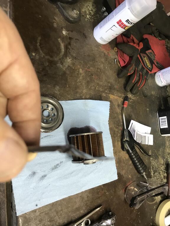

squonk 45,816 #11 Posted July 10, 2020 Finally got my hands on a WH filter to cut open. This thing is old! I could barely make out the Wheel Horse printing on it. This came off my 1075. Filter pleats not bad but still not as good as a 1410. It also has a cheapy spring like a junk Fram. I want to get a hold of a black one to see if the cheapened it up any from the red ones. 1 1 Share this post Link to post Share on other sites

tom2p 2,394 #15 Posted July 11, 2020 NAPA 1410 looks like a better filter of course I have a bunch of OEM Toro filters lol 1 Share this post Link to post Share on other sites
squonk 45,816 #16 Posted July 11, 2020 12 hours ago, elcamino/wheelhorse said: Are you that bored ? LOL Listen you old coot, The inquisitive mind within me has been wanting to know the quality of the WH/Toro since there some folks here that say "You should use the OEM filter" and Toro dealers are dwindling by the day. Guys are ordering them and waiting whilst they could just drive to a local Napa or Wix dealer and get a better filter. 5 Share this post Link to post Share on other sites
Racinbob 12,850 #17 Posted July 11, 2020 Absolutely nothing wrong having an inquisitive mind. That's why I did the same thing back in the 90's. I had them mounted on a chunk of plywood and hanging in my pole barn. The results are in post #2 from 6 years ago. The NAPA, Motorcraft and Target filters were all about the same on the top shelf. A couple others were so-so and Fram was in a league of it's own being total junk. 2 1 Share this post Link to post Share on other sites
