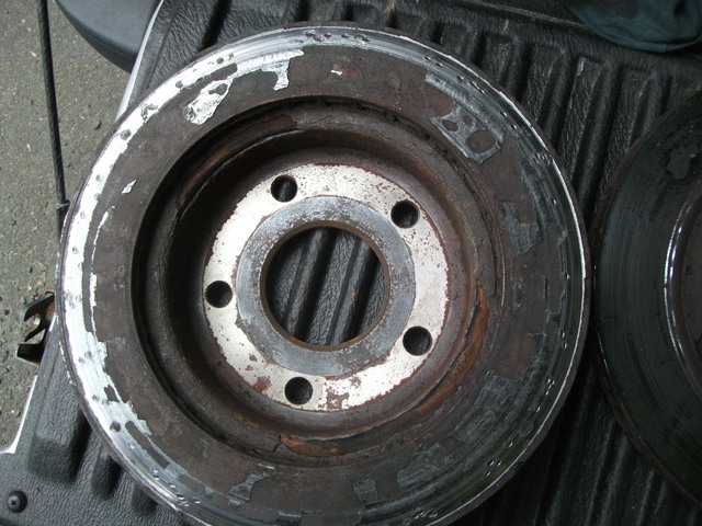

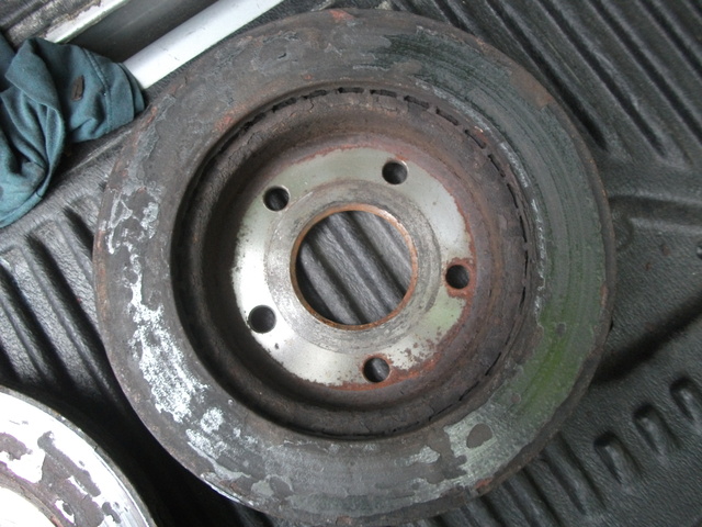

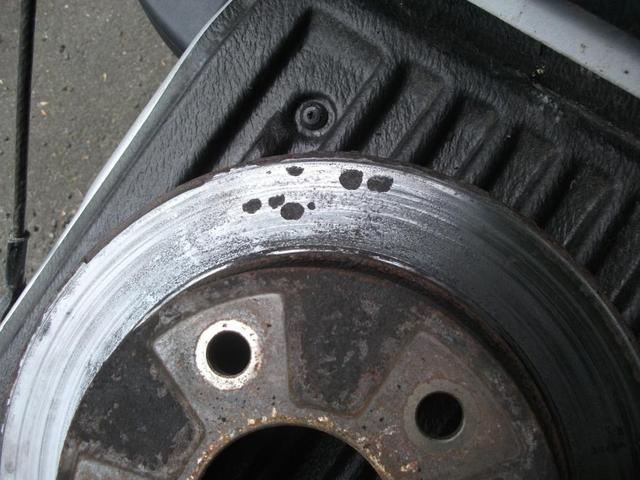

Sparky-(Admin) 19,284 #1 Posted June 6, 2015 Did a front brake job on my 05 Dakota yesterday (pads and rotors), no issue with the job, all went well and now I have a good brake pedal and it stops fine. But right before this I had (maybe 4 months ago) started to experience the tell-tale front end shake that comes from warped rotors. But it got worse real fast, thus the brake job. It almost didn't want to stop the last couple times out! This is what the rotors looked like when I got em off, the pads were well worn but NOT metal to metal yet. What would cause this? I bought the truck a couple years ago and this is the first time I have done fronts. Did the previous owner just slap on pads? Or could the rotor have been turned down before me to much? Or maybe the harsh winter we just had combined with the new nasty corrosive crap the state of Ct. sprays all over the road right before a storm ate my rotors ? Any thoughts?Mike.......... Share this post Link to post Share on other sites

rmaynard 14,804 #3 Posted June 6, 2015 (edited) Here in Maryland, a used vehicle has to go through inspection to be titled. Many sellers will slap on new. cheap rotors and pads to pass. Those rotors in the pictures look to me like cheap imports. The quality of the rotors is so inferior that they deteriorate like that in a very short time. Edited June 6, 2015 by rmaynard Share this post Link to post Share on other sites
squonk 38,559 #4 Posted June 6, 2015 (edited) Today's rotors are junk. Off shore metal. When I worked at Napa we had 3 stinkin levels of rotors and pads. PITA! The cheapie pads accelerated the problem you have if the vehicle sits a lot. And not to pick on one brand, but I saw these problems on Chrysler products more than anyone else. Especially on those Neon toilets. Edited June 6, 2015 by squonk Share this post Link to post Share on other sites

Coadster32 793 #8 Posted June 8, 2015 Looks like bad rotor material to me. I have never seen them get that bad though. Must have stopped like crap, pulsed, pulled, etc. Share this post Link to post Share on other sites
bmsgaffer 2,043 #9 Posted June 8, 2015 I am with the bad pad group.When your rotors warp even a tiny amount it can create hot spots on the rotors and pads and cheaper pads can actually start displacing their material onto the rotor. So the rusted pits you see may actually have been started by a small buildup of pad material/glaze everywhere else on the disc. Then add in the nastiness of winter and chemicals and it will just accelerate that like crazy. Thats my theory anyway.I just replaced all 4 original rotors/discs on my 2008 Ram at the 95,000 mile mark and that is only because one of the rear pads finally cracked. They would have gone 100k easy and there was no sign of warping. Needless to say I put OEM top quality on there again.I have had good luck in the past with EBC brakes (from england). If you stick with their basic green stuff they seem to last a while. I had their middle to high end ones on my last car and I swear I could stop in half the distance, but I ate through a set of pads and rotors in less than 50k. Share this post Link to post Share on other sites
kaiser 100 #10 Posted June 8, 2015 the napa adaptive one brand pads are really good. (higher then napa gold)that looks like a really cheap rotor to me. all that scaling under the hat is a dead give away.oem and high end rotors don't do that.another thing to note, beware of "high performance" brake pads. they are lousy for street driving and only work well when they are piping hot.which means when they are cold, like they are on an off ramp, they can take twice as long to stop. Share this post Link to post Share on other sites
