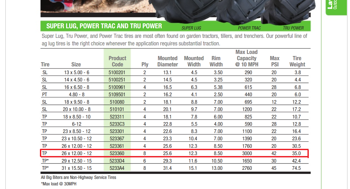

The 26x12.00-12 needs a 10.5" rim. The rims you have are only 8.5" wide.
​Is that true on the 10.5? I was reading on these 26x12x12 require only 8.5 inch rim. You can see here http://www.kenjones.com/Scripts/itemdetail.aspx?t=90505&IK=523377 Rim width is only 8.5 inches.
I actually got the 8 PLY ones too, So I think that definitely should help with loader
Thanks for the insight! Im gonna do some more digging and just confirm that don't need 10.5
Racinbob
I'm thinking that 8.5" is a misprint. That's just not wide enough. Millers sounds right.
milspec762
​Hmm I did go to carlisle Website, and even on there fitment guide it said 8.5 and thats main reason i bought these ones (attached screen shot of there tire chart with it highlighted.)
These are supposed to protect the beads and over hang. So I think that's why its able to work with 8.5 inch rim.
If the manufacture is wrong Ill be upset. Going to have the tires mounted today and hopefully start installing tonight. Ill post some pics on the progress. And also if these fit an 8.5 inch rim

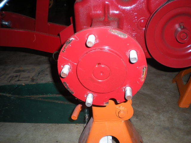

You might also consider replacing the lugbolts with 7/16"-20 x 1-1/2" Grade 5 bolts and lugnuts. It makes it much easier to mount tires.
DSCN3169.thumb.JPG.535953c3fd082dbdc4069

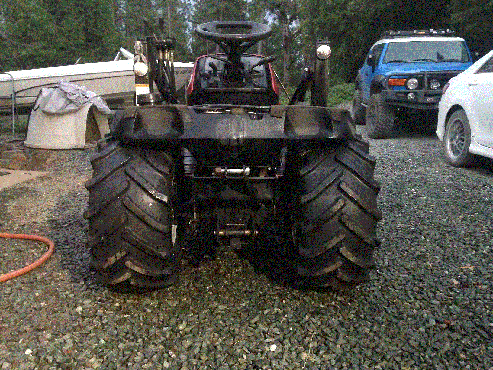

milspec762

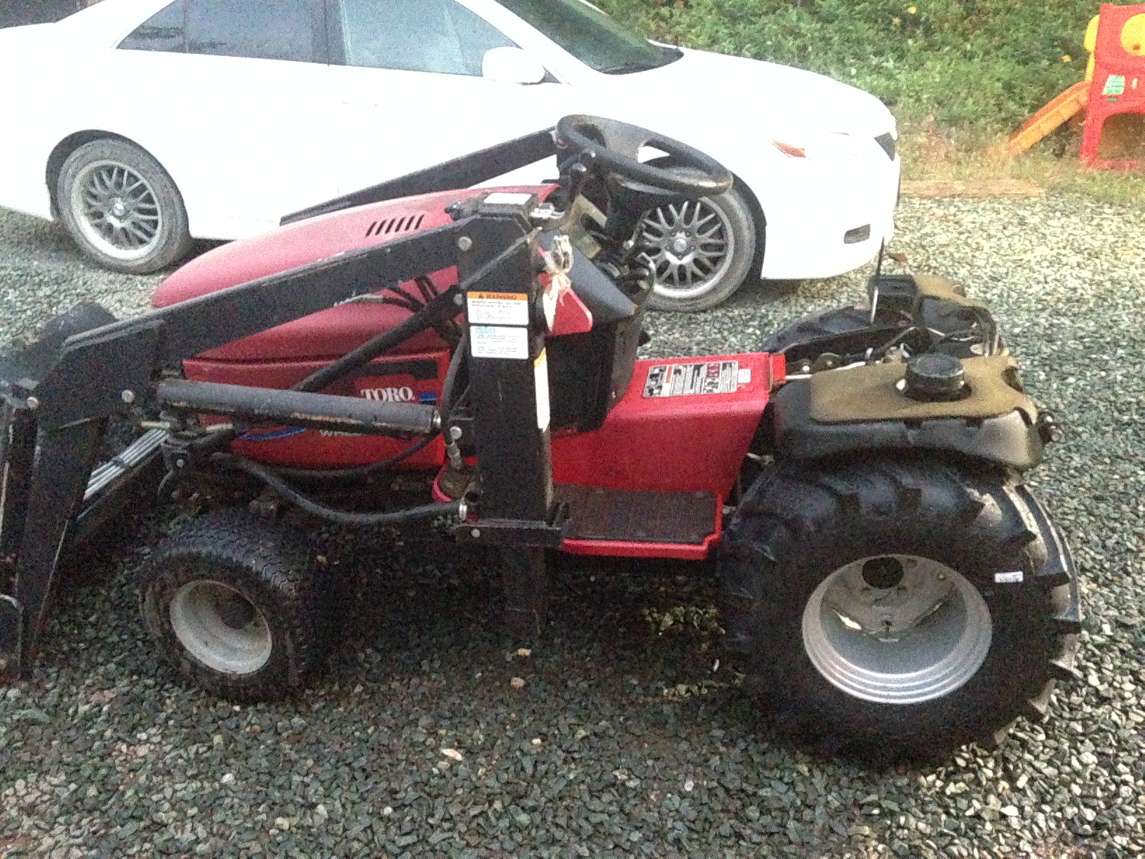

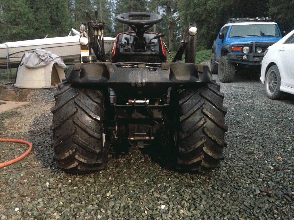

Hey guys,
I went down to America's Tire here. And got the "how much do you want to pay to have these mounted?" Question Said nothing so they mounted them for free. lol
Looks like they mounted just fine on the 8.5 inch rims, I dont see any issue with overhang. And pretty happy with how they look!
Heres some pics. Im going to start pulling the tractor apart tonight (in need of a paint job as well) and then next couple days ill post pictures of the progress and final product.
If you wanted some nice wide ones for you 7 inch rims Id say these are the way to go. Americas tire even checked there fitment guide and said 8.5 for these 26x12x12  8 Ply's.
Stay tuned!
Edited by milspec762
Spelling Edits

​I just pulled a tire off and mounted one without any modification. It fits but hits fender slightly. Looks like I need to make about 3/4-1 inch of clearance and ill be good. I got some ideas of how im going to takle it. Not sure if I will have to cut anything. But I'll see once I open it up. This is first time modding one of these.
Doesnt look like any blockers and fiarly easy to pull off. Im going to post pics and steps of how I ended up doing mine.

milspec762

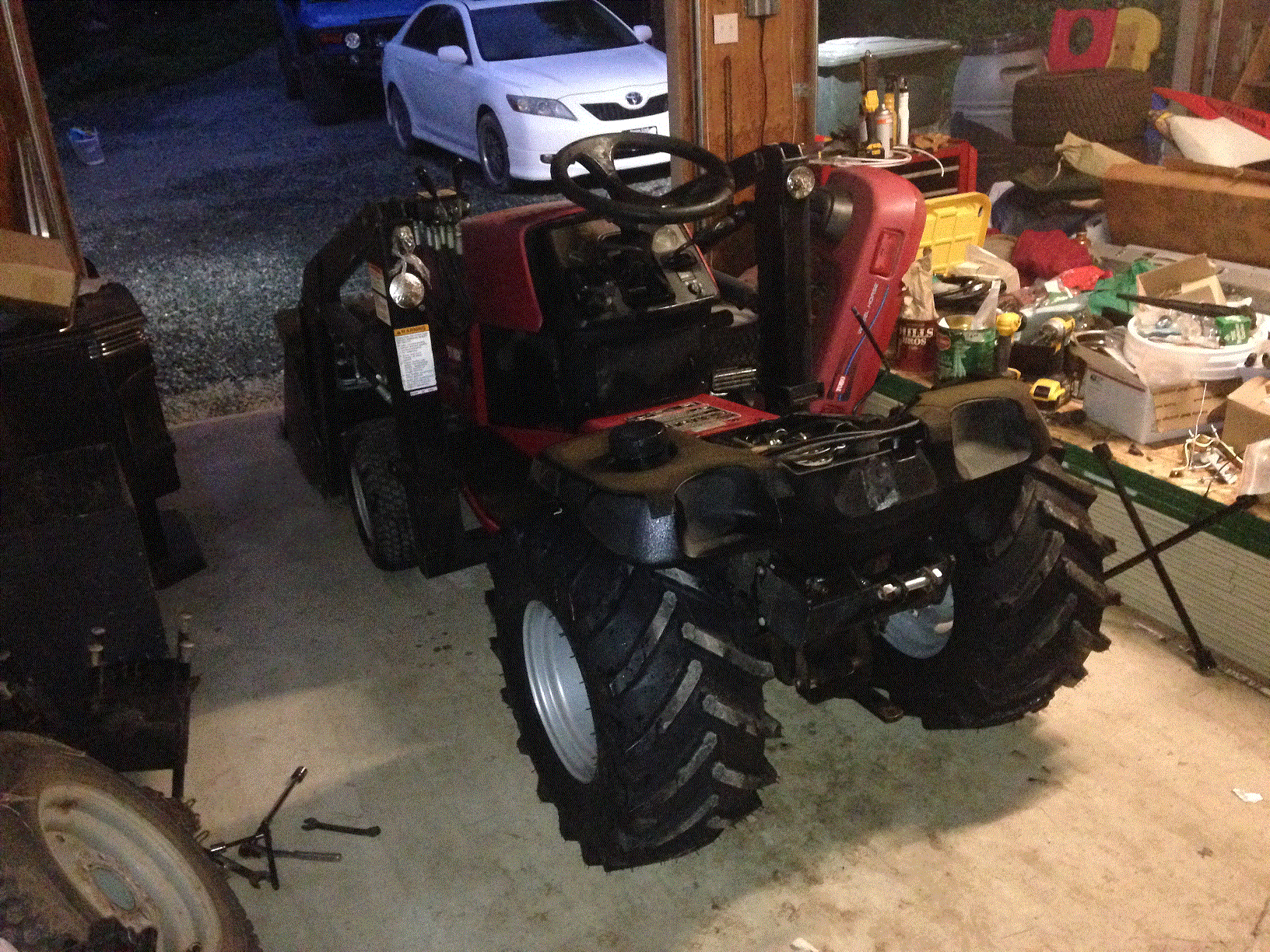

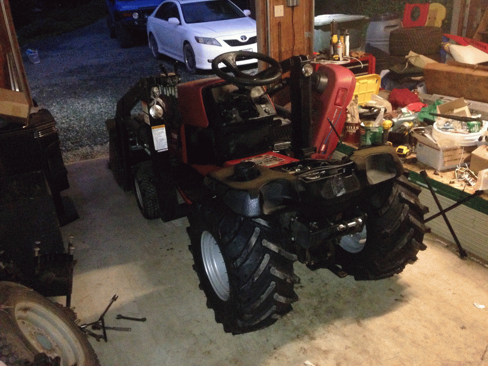

Hey Guys,
I made some progress tonight. I got the tires mounted, Even was able drive it out into the driveway for a hose down.  Still working on fitting the fenders, but thing I should have it wrapped up tomorrow.
Heres some pics of the Progress so far.  Clearance is looking good!!!
Must of killed 10-11 Blackwidows though....
boovuc
I think you did very well with the price, ply ratings and style of that tire. I don't have an Xi so I wasn't familiar with the tank style under the tub verses my 520-H but on the same principle, you can raise everything at the base mount or you can just lift the tank. Whatever gets you through the night!
PS....Black Widow Spiders or the refreshing Vodka and Rum on ice mix? If I start killing 10 or 11 of either, I would be crapping my pants!
