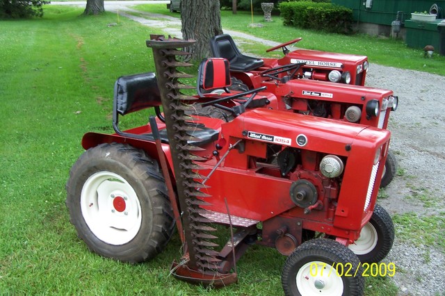

Lane Ranger 11,639 #11 Posted June 2, 2015 Important note on the 50 inch sickle bars. They made two versions - one that fits the width of the 953/1054 frame and one that is one inch narrower ! That is important information on buying one. Check the width of the frame -outside to outside angle iwon on the frame and check the sickle bar mower frame plated -outside to outside measurement. Just about everything else is the same for the sickle bar mower setup.We have a 50 inch mounted on a 1965- 1054-A. Here is an older pic before restoring the sickle. Share this post Link to post Share on other sites

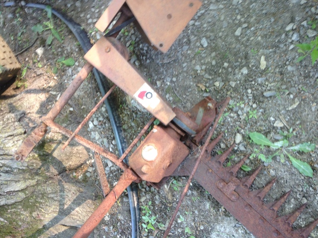

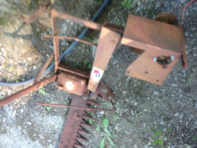

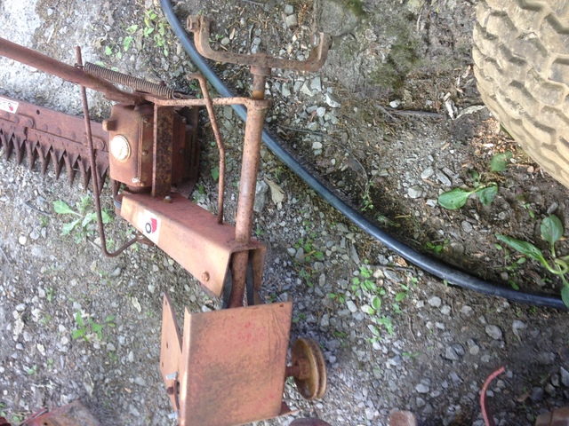

Dhodge 528 #12 Posted June 2, 2015 Ok, I got it home today finally. Here are some pics> I measured the bar at 44". Lane I failed to measure the mounting bracket, but I have the 1054 to compare it to. Thanks for everyone's response and if anyone can confirm the model please let me know. I have lots of wheel horse models that this would look really good on once I get it restored, maybe a round hood?? Share this post Link to post Share on other sites
gwest_ca-(File Mod) 11,761 #13 Posted June 3, 2015 (edited) SMS-42A?http://www.wheelhorseforum.com/files/file/467-mower-sickle-side-42in-1962-64-sms-42a-om-ipl-a-7137pdf/Garry Edited June 3, 2015 by gwest_ca Share this post Link to post Share on other sites
Dhodge 528 #14 Posted June 3, 2015 Thanks everyone for all the help. Nice 1054's, 953's 1054-A's Lane!! Thanks for the pics too. SMS-42A sounds good to me. Now what to put it on when its time 704, 633, 701, 702, 856???hummmmm 2 Share this post Link to post Share on other sites
