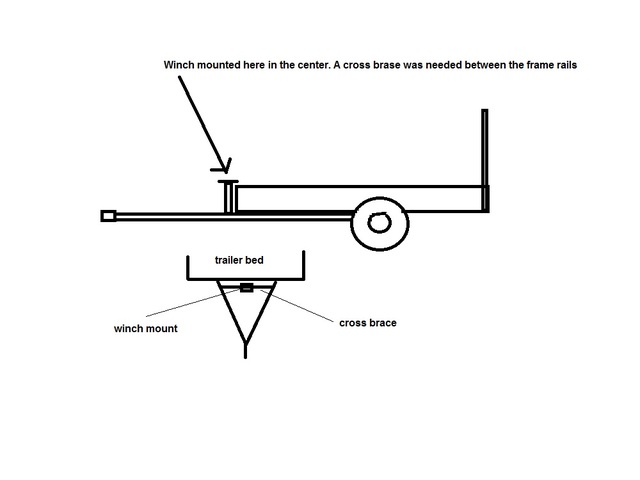

wallfish 20,510 #3 Posted May 6, 2015 Mine is mounted right in front of the bed, like this. 1 Share this post Link to post Share on other sites
