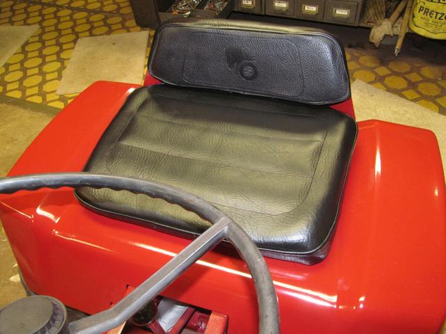

The vinyl is wrapped around and glued to an inner thin steel panel that has nuts welded to the inside. This finished pad is then bolted to the seat pan which also clamps the vinyl between the two steel plates.   I also lace the pad to the inner panel with  heavy waxed  cord to stretch it tight.

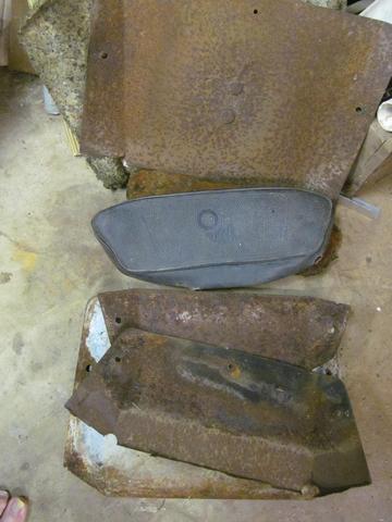

This is what I had to start with on my Commando 8.
post-7208-0-05430400-1429708270_thumb.jp

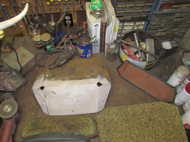

The back was broken off the seat pan and had to be rewelded and finished.
post-7208-0-78087600-1429708365_thumb.jp

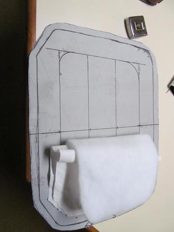

Then laid out and made the seat and back covers.
post-7208-0-45308800-1429708391_thumb.jp

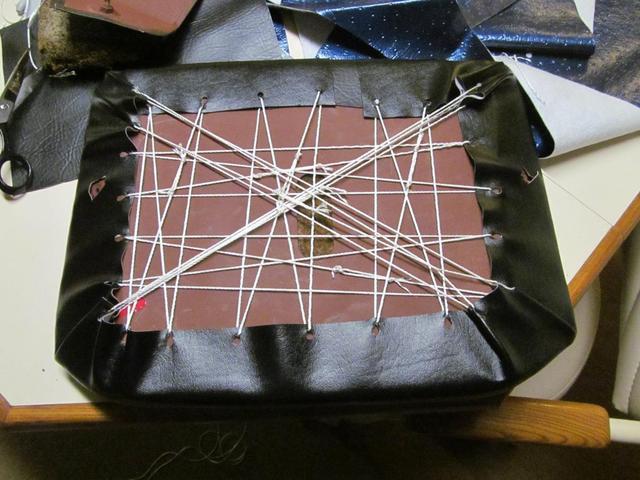

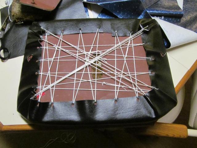

Attached to the steel inner plates with glue and lacing.
post-7208-0-89512500-1429708420_thumb.jp

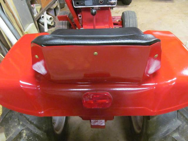

Then bolted to the seat pan.
post-7208-0-69319000-1429708459_thumb.jp
post-7208-0-15160000-1429708814_thumb.jp
Hope this gives you an idea...good luck.
