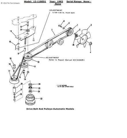

gwest_ca-(File Mod) 12,283 #13 Posted April 29, 2015 Sounds like you want to do something like this. Garry Share this post Link to post Share on other sites
callum12 257 #14 Posted April 29, 2015 of course!! there's me making it complicated for my self! how much do uni-drives go for? thank you very much guys callum Share this post Link to post Share on other sites
